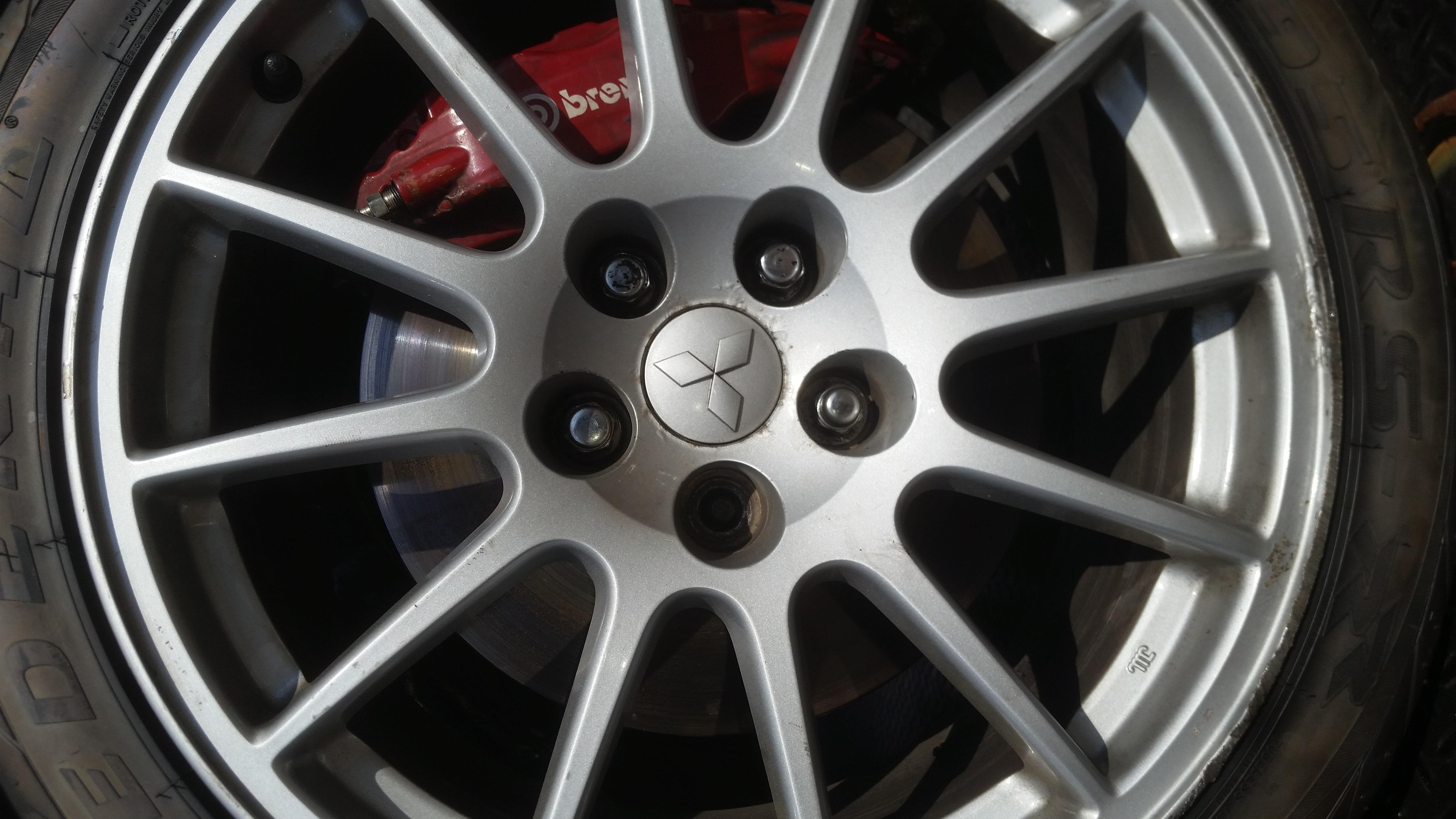

A couple things so far. But it is, what it is, but until I get a day off (next sunday) to really get a full day of investigating I'm going to refrain from making statements as I truly don't know just how bad somethings are vs do they just look bad.
But 1 particular no questions are the evo x rims and tires supposed to have only 1500 miles on them.... must have all been snow
Will say this. I really missed having a white car and she looks pretty in the garage.

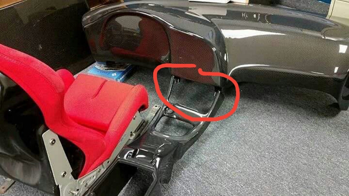

Sergio from carbonetics messaged me today. And long story short. He said all my stuff is ready and do to the hastle, headaches, time frames , etc. On top of replacing my hood with his new CAD designed dry carbon AB V2 hoof (I'll be the first to get it) he offered to either pay for free shipping of my parts ($300) or I could choose comparable parts of the same value. I chose to have him make me a custom center console/armrest. Thats race car only. It replaces the empty space where a radio would go with a flat piece that flows with his dash. I did this to allow for more space to mount stuff neatly. (Tpms, tablets for race capture, etc)
He said everything else I ordered is ready but will need 3 weeks to build me my center console.
Here is a picture of his dash with his center console. I highlighted the area I'm talking about that he's filling in.
I'll have to figure out how to mount it once it gets here.
Other parts to arrive:
-dash
-interior door panels
-side skirts
-front splitter
-fender flares
-AB V2 hood.
Name:	2018-05-08 22.40.52.jpg
