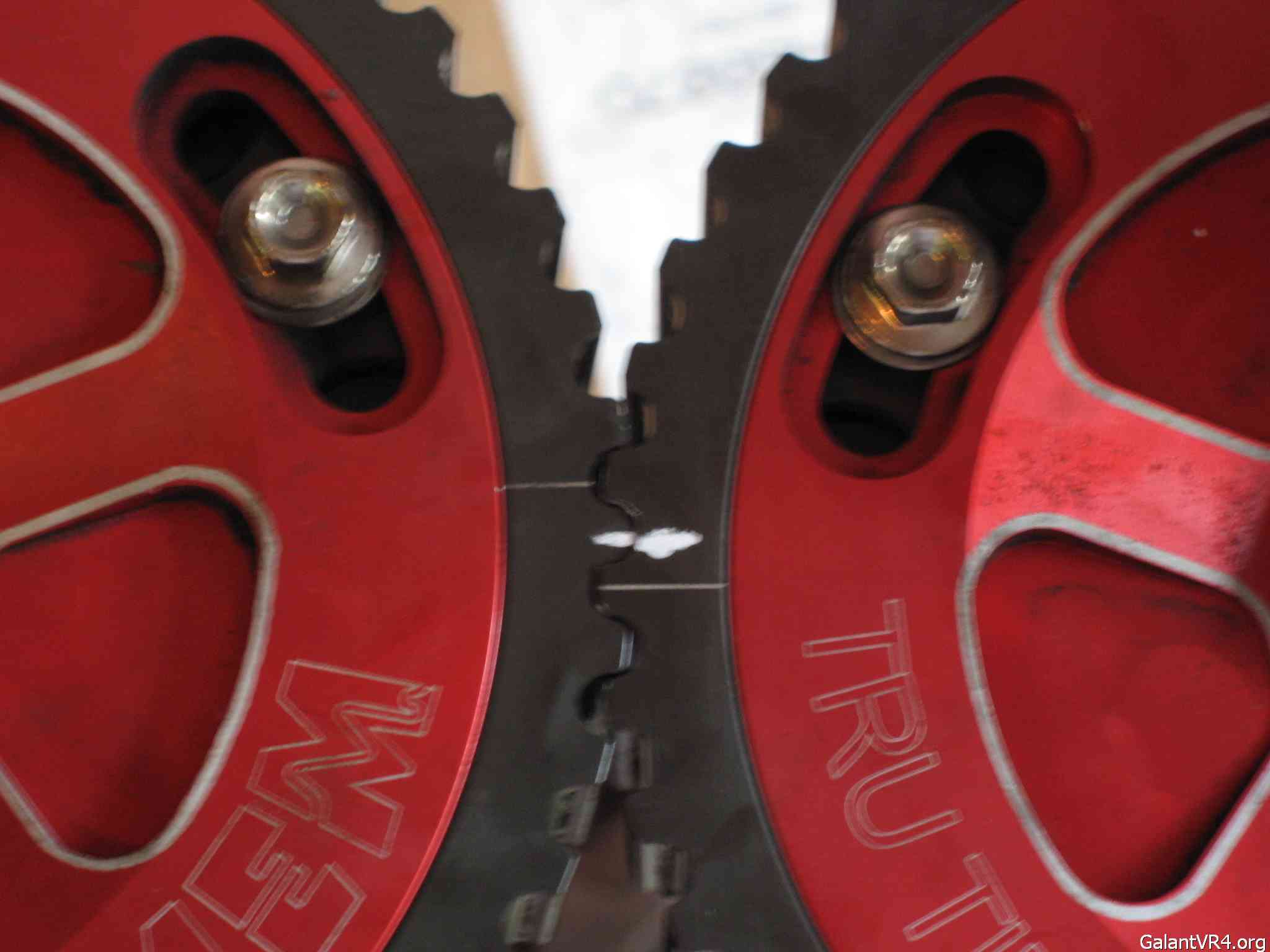

The cam gears are off by 1/2 a tooth. How do plan to re-mark them? Either way you are 1/2 tooth advanced or 1/2 tooth retarded. Buy 2.4L gears or adjustable 2.0L gears and degree them in like I did.

You could remark your 2.0 gears, they'd be exactly half a tooth clockwise from the original marks. Like Vicious, I bought the 2.4 gears, timing is just not something I'd do half-assed.

Just mark them like this. Yes i know they arent the stock gears but who cares? The marks line up the same way.
Damn, homie's got a gear drive set-up.
If I remember correctly the difference is about 4.5 deg of cam timing in either direction. Ask anybody who's done building and/or tuning and they will tell you 4.5 deg is alot. Do it right. You'll spend many times the cost of the gears trying to get back that power difference.
