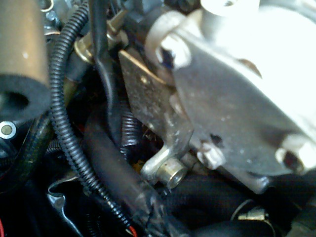

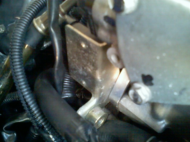

Also i didnt see where you put the other Plug, the one that is usually right next to the Coilpack. (looks a lot like the MAF sensor plug.)

That sensor at the top you are referring to is your Manifold differential sensor. I took it off and the wire harness for that just hangs unused. As for the other plug you are referring to that normally goes by the coil pack, i'll get you a picture of where i put it but it won't be until late. I have to leave shortly from work to goto a wedding rehearsal (not me). I will post a picture sometime late tonight.

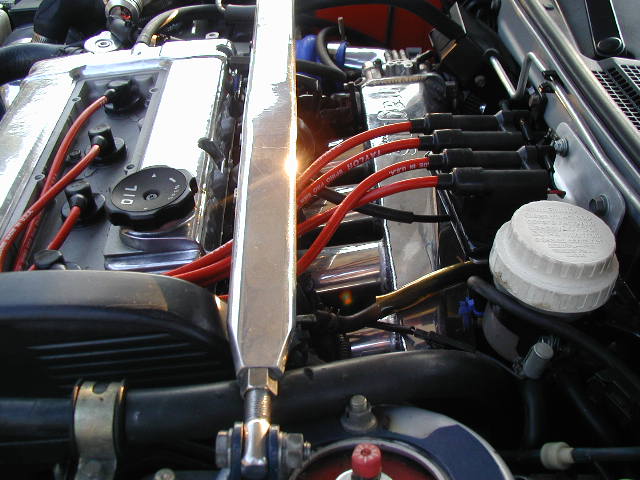

Here is another picture of the coil pack holder.

Your 710 cap is on upside down.
Nice looking engine bay!! (its way off topic, but looks good).

Damn your engine bay looks sexy, I must admit that looks clean as hell.

Those pics actually made me realise that i forgot to put the PCV Valve back in. :OH::

...oil cap os on upside down..

"710" oil cap... LOL, I like that one That's an old photo from earlier in the summer. It's not that way now. I got crap about this once before on here a few months back. Anyway, thanks for the comments guys. I spent alot of time on the car. It pays to have a large shop like ours too that has CNC machines and tons of other machinery including a room of floor standing buffers. I'll probably run another special over the winter on shaved valve covers.
Here is 2 pictures of what I did what that connector that's normally by the coil pack. I mounted it to the bottom manifold bolt(passenger side). It's clean and works perfectly. I don't know where other people put theirs. The magnus project is one mod that creates about 5 other mods!
One other mod that i can think of is that you have to extend the coolant hoses that goto your throttle body.
