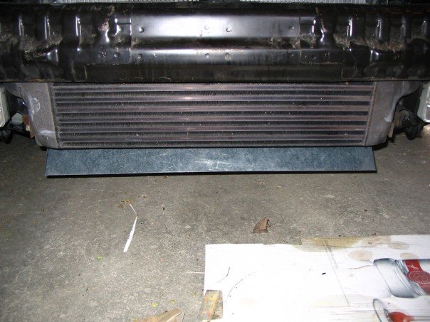

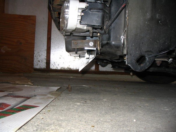

You could try building a sheet metal air scoop under the radiator to direct cooler air twards the radiator. This way the radiator won't only be getting air thats been pre warmed by the IC and AC core
I dont think the 1g dsm link version has the coolant off-set. The fans on a 1g arnt controled by the ECU.

^^ Ahh Very nice idea! I think I will try that with the scraps I got laying around. Any clearance issues carltalon?
I dont actually run one on my car. All my cooling problems are gone after switching to E-85 and installing Brandons old radiator.
Might be a long shot but are your fans blowing in the right direction? If they were blowing the wrong way they would still work fine at idle and slow cruse. But at high speed the fans and the incoming air flow would cancel each other out.
