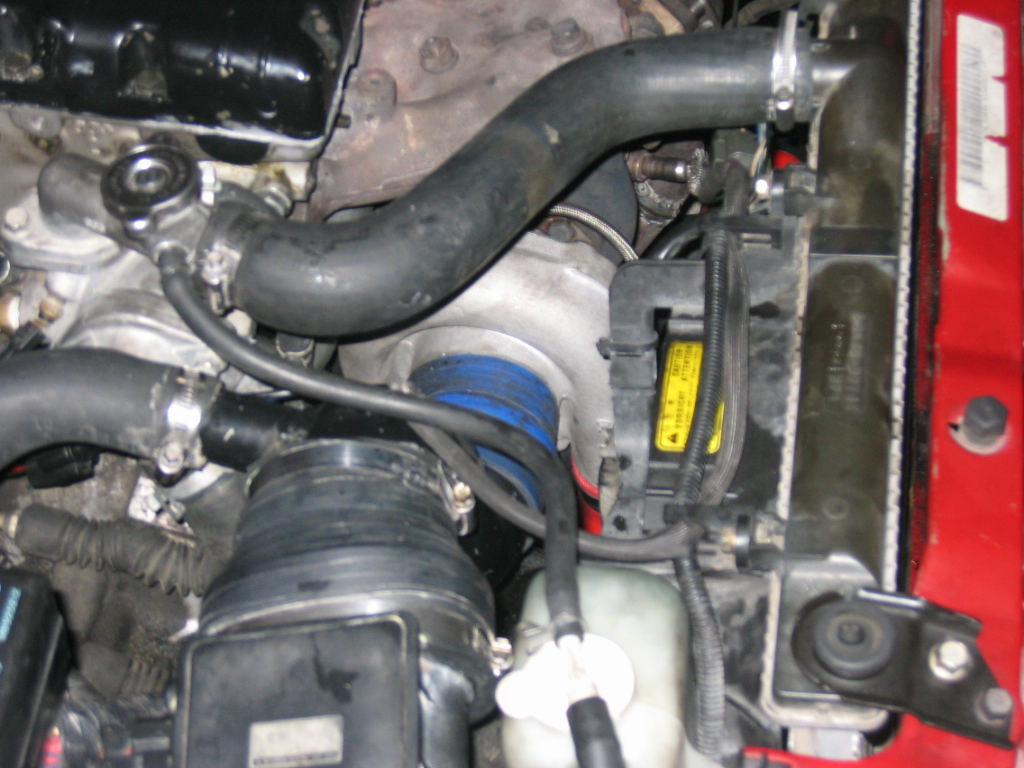

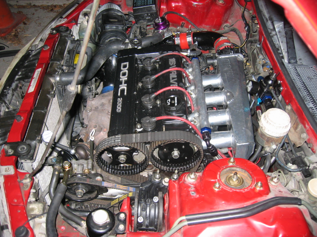

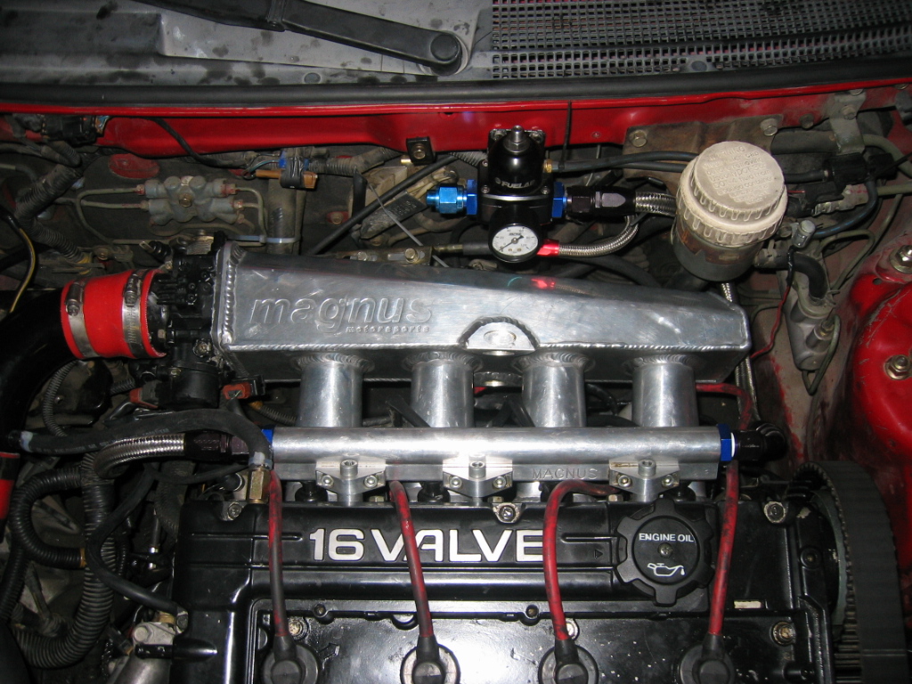

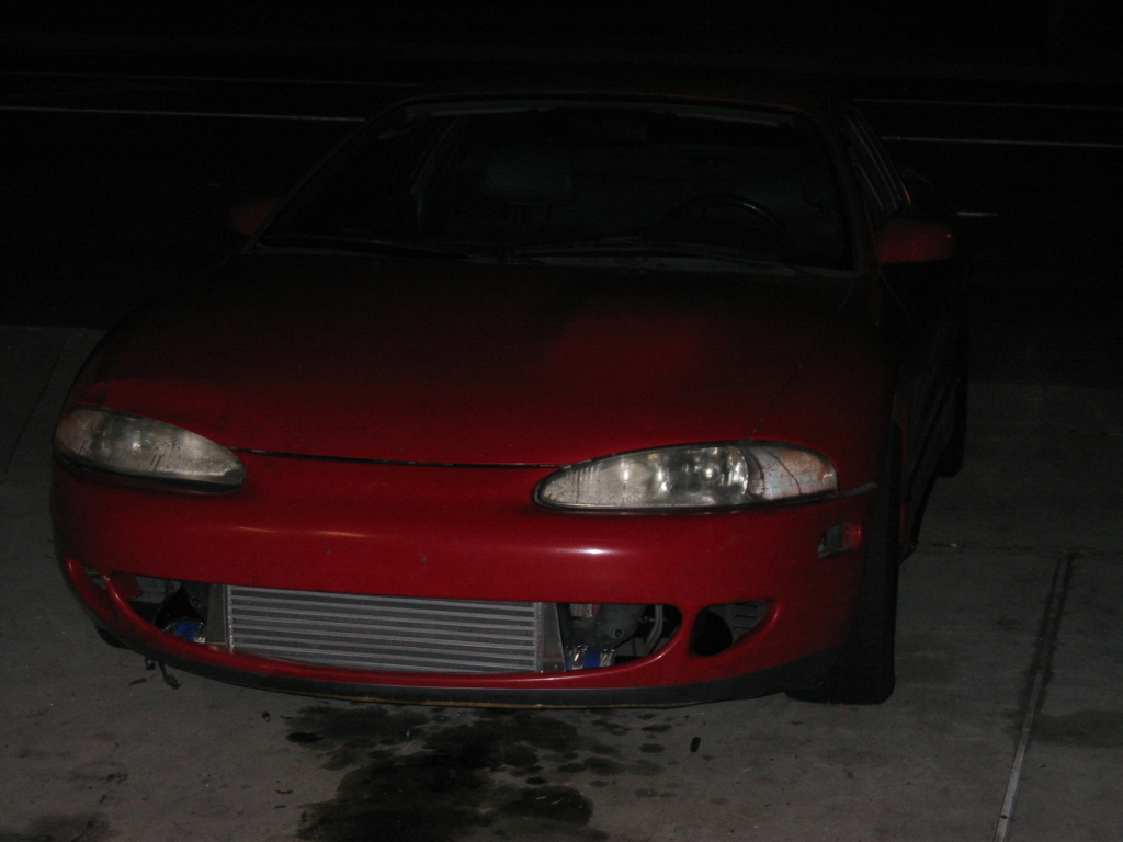

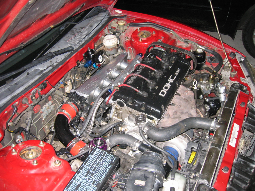

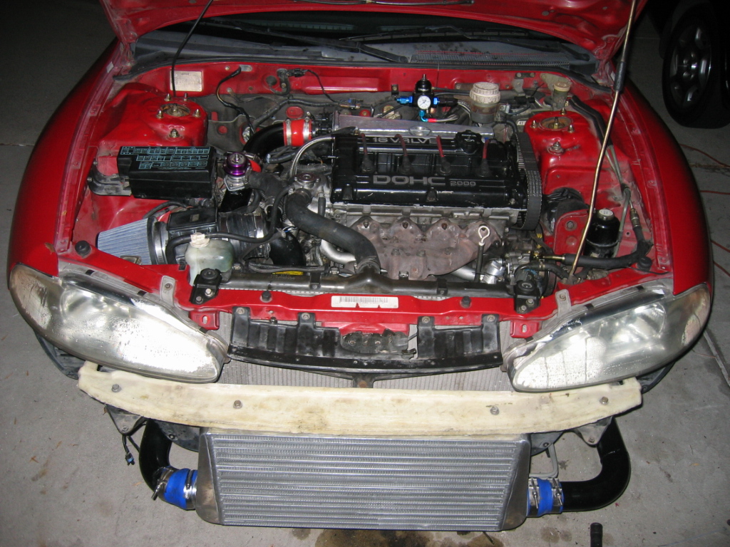

here are the new pics.

Old 10-15-2007   #28
Re: Project Uber Fast GSX
Those fuel lines look so big, haha!
Old 10-15-2007   #29
THEY ARE! Have you seen the magnus fuel rail before, I can almost fit a quarter in the barrel.

I love the new intercooler the dimensions are 31x11.75x4" from siliconeintakes.com after driving home boosting here and there, the hot side is warm the cool side is freakin ice cold. last night my intake temps never got over 67 degrees.

Just curious, but at idle, dos your magnus make it sound like your car has a huge vaccuum leak? I've got one on my 1g and it makes a high pitch whisteling sound, but I don't have any leaks.
Old 10-15-2007   #37
yes it does, and it always throws me off. Because it idles kinda rough so i hear that whistle and think its a boost leak. It almost sounds like its coming from the throttle body. its great to know that im not the only one expirencing this. I like to think of it as the horseys wanting to come out and play.
