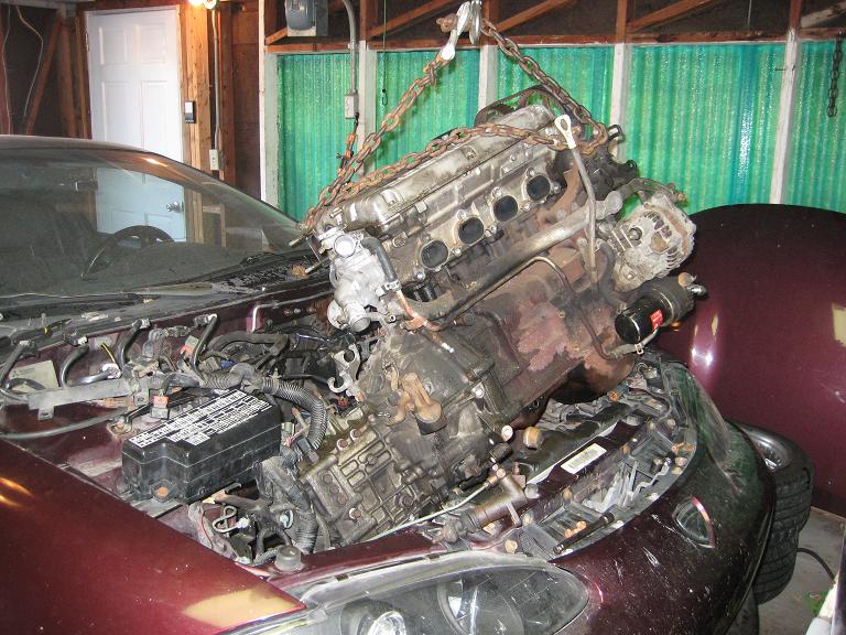

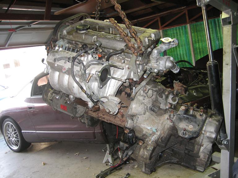

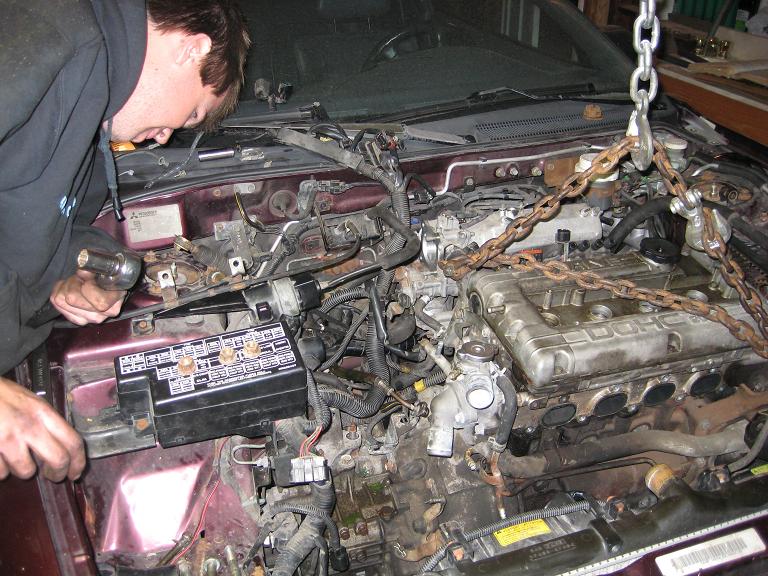

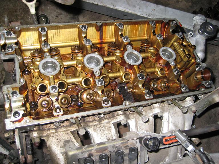

Here are a few pics. I have way more, but it's too many to post. The first ones are of pulling the motor out, I was able to do it without help amazingly.

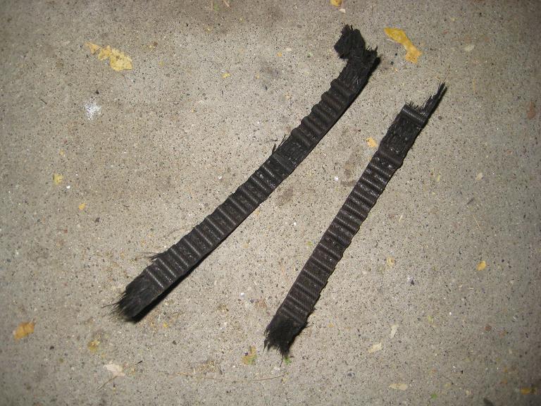

I also included a picture of some remnants of the balance shaft belt, I was pretty lucky it didn't affect the timing belt, no idea how long those were busted inside the timing belt cover.

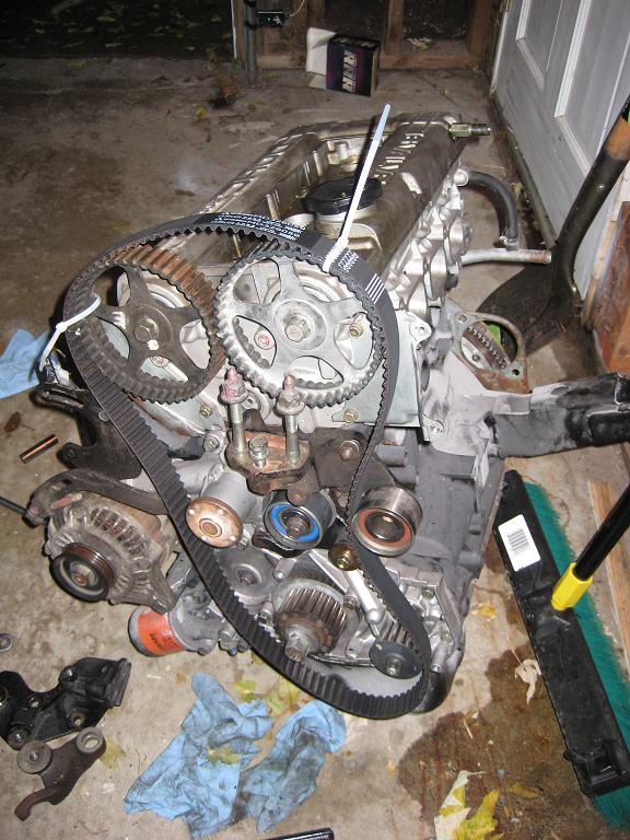

Lastly I included a shot of the new motor with the valve cover and cams on, and also the old head that looks like it's made of copper.
