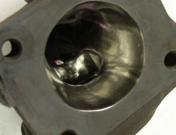

Here is a 14b that I did for a member. The wastegate outlet is also ported, but I couldn't get a decent pic of that. It is so damn shiny that I couldn't get the camera to focus on it decent! I took about 20 pictures and these are the best.
Not too shabby for $50, eh?

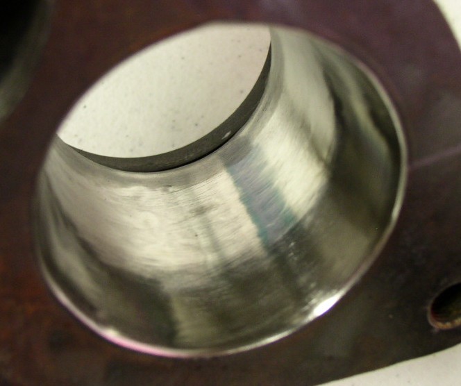

Another

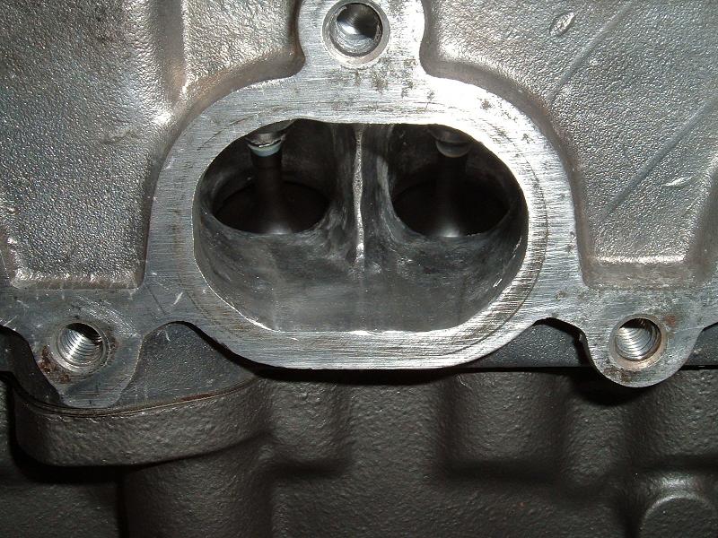

Exhaust outlet

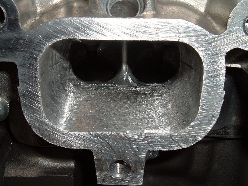

Bellmouth and polish of the compressor intake

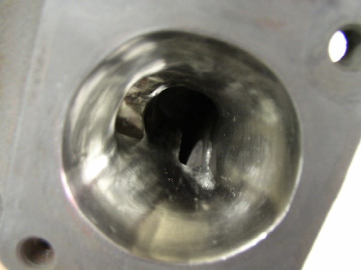

Lastly the compressor outlet

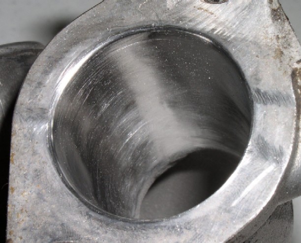

Here are some pic's of my head that I ported. It is pretty extreme on the exhaust side and there are about 15 hours of porting in the head.

It doesn't take much on the intake side, it is already pretty big.

That head is a stage 3 or 4 head, there is 16 hours of port work into it. The pictures don't do it justice at all. The exhaust ports are about 50% bigger than stock. That would be $325. It is pretty extreme though, I can do something in the middle for $200 also.
