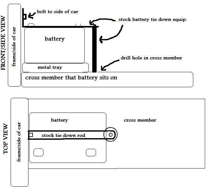

Thanks again guys. If you look at my how to thread on the battery the tie down I made was all kinds of ghetto. The way I have it now is a little better than what I had then and it did pass inspection at the track. I'm gonna come up with something even better tonight and I'll post pics.
Here is what I'm planning on doing although there is a hole in the metal tray that I will use instead of drilling one in the cross member.

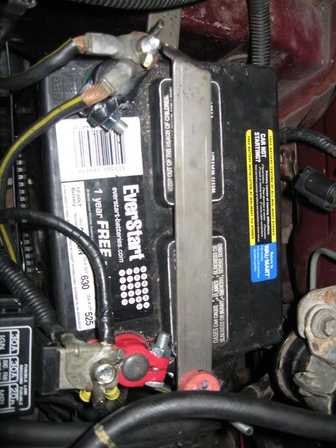

Old 08-04-2008   #36
eagle talon guy
eagle talon guy's Avatar
Join Date: Mar 2007
Location: Monticello, MN
Posts: 331
Send a message via AIM to eagle talon guy
Re: 4g63tcrazy's ride!
Thanks Michael! Post up a pic of the bracket. I wanna see how it worked out for ya.
My friend really liked your car too by the way. haha
Here are a couple pics of the bracket/battery...
-Michael
(^^very old pic!)
6 Bolt build in progress
eagle talon guy is offline   Reply With Quote

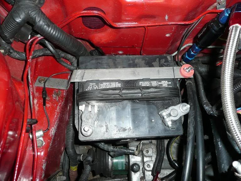

Old 08-04-2008   #37
That bracket looks really close to the positive terminal, I would want something in between them...
On my 2g I was able to use all stock parts to drop the battery like that. There is a nice screw hole where the battery tray originally was, and I use the stock tie down and j bolt, just about 8-10 inches lower. All I had to do was bend the stock tie down a bit to line up better. All the stock ground wires even reached (barely).
Old 08-04-2008   #38
eagle talon guy
Join Date: Mar 2007
Posts: 331
Yeah, I used the wrong hole to mount this. I have to redo that and re-situate the tray and it will sit on the other side of those caps.
-Michael
(^^very old pic!)

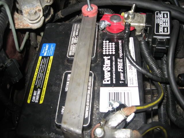

Old 08-04-2008   #39
4g63tcrazy
is Nashty
4g63tcrazy's Avatar
Join Date: Oct 2007
Location: Stillwater
Drives: Cyborg from Japan
Posts: 2,080
Yeah here is a pic of how the bracket is supposed to sit. DAMN I need to repaint my bay!
-1990 Mitsubishi Cyborg 4WD-
