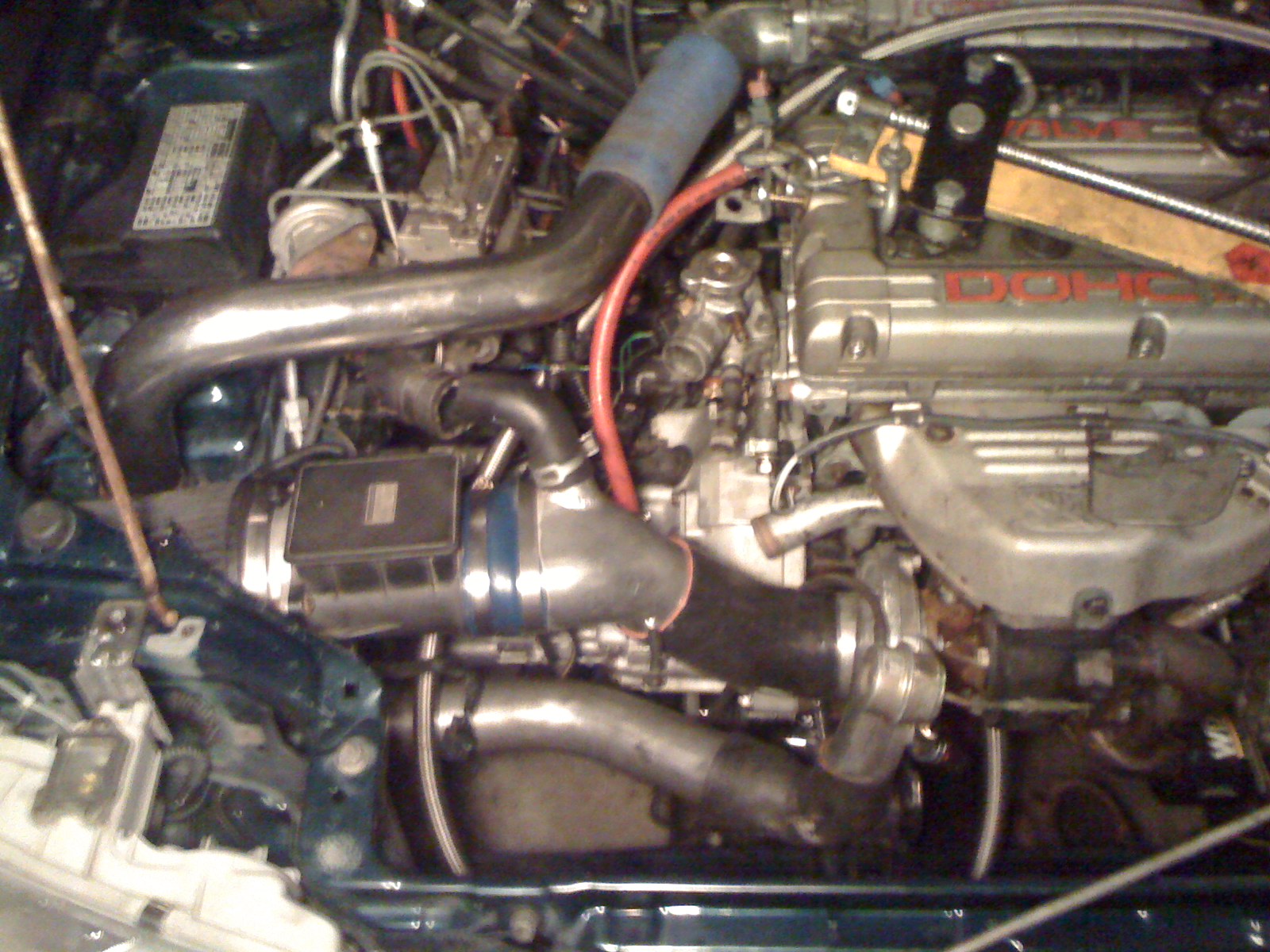

From everywhere. JK the whole engine/transmission was coated with gunk and grime, i just finished cleaning the whole assy up today, see attached pic. it was black when i started this. and I have added a bottle of dye to trace any leaks WHEN they surface

Also, if John Gosh looks at a block, feels the metal, and says "there should be no problem with block strength if you drill a hole right....there" I am going to believe him over what anyone else here says. DSM pro or not
The second picture is a counter-measure to Boostcreeps picture

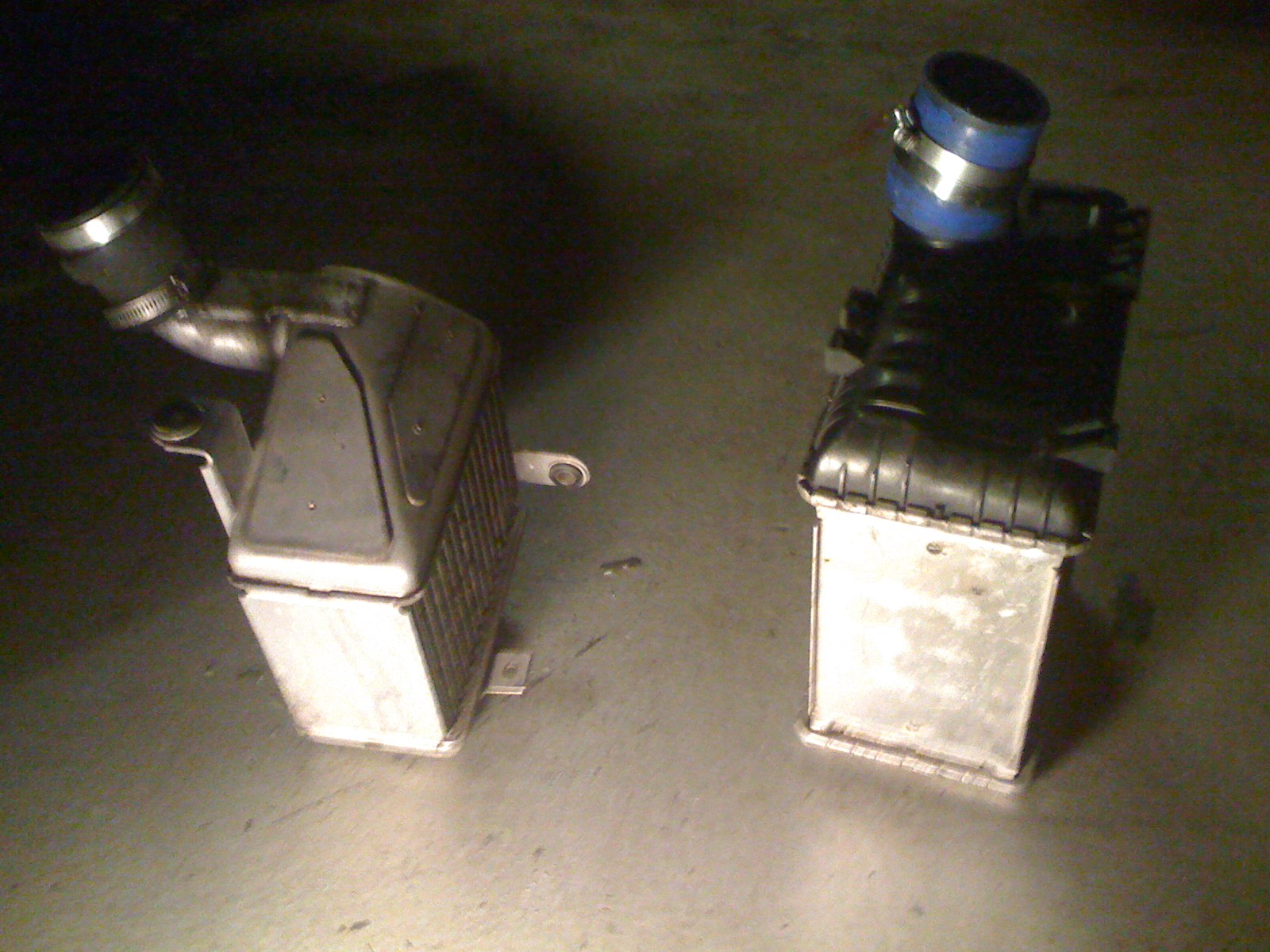

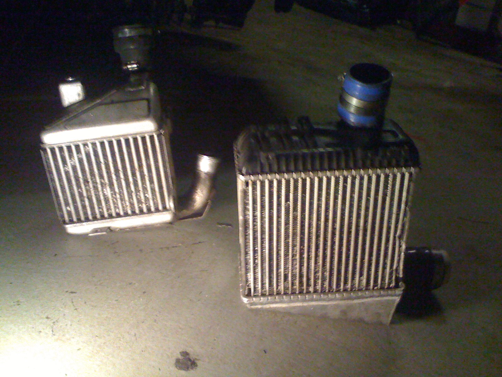

Pictures are of my intercooler piping and my supra sidemount. I know that it is really old school, but who cares? it was free!
I really want a FMIC, but im saving up for a house and I just cant budged it in right now.
