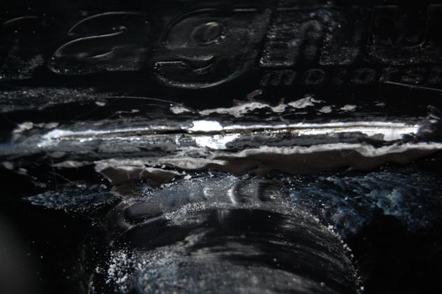

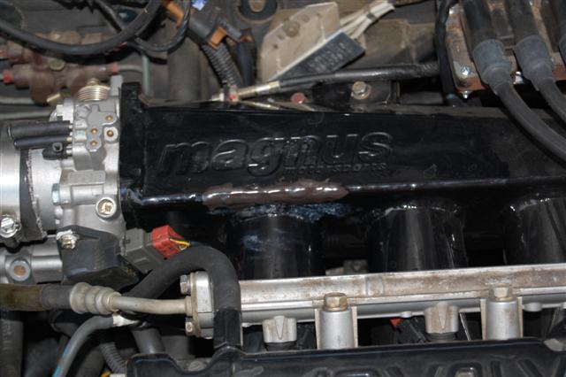

Thought I'd revive this thread. I was up in Duluth driving to my cousins wedding in Virginia, rolled into it in 4th gear and heard a loud pop. From then the car wouldnt idle. Pulled over thinking I had a blown off a pipe or something like that. I didnt see anything wrong so I started pulling plugs when I noticed the intake mani.... No pictures yet but, there is a 4" crack along the weld on right above the runners. Needless to say I had to rig it(tape, bubble gum, some paper, and a shoe string) to make it back to Duluth and now I have some JB Weld on it so hopefully I will make it back to St Cloud to get it fixed up properly. Yea for magnus!!

Old 09-20-2009   #24
Re: Magnus Motorsports
We need some pics man! and pics of the temporary fix also

95tsi
95tsi's Avatar
Location: Duluth
Drives: a pos
Posts: 722
not quite as epic as some but, either way its a pos. Sorry, no pics of the really stupid Macgyver'd roadside fix.
The JB weld bandaid.
what lies below

As Jakey noted earlier in this thread, I had my problems with Magnus, and I gave them a fair thread about it, as some of the issues were not all their fault, although most were. But what did go wrong on Magnus's end never should have happened.
Not that I'm trying to defend Magnus on this, but there are two different issues in this thread.
1. The out of the box problems are very disappointing, especially for the money these intakes cost. Never should happen that way and just a visual inspection before boxing it up would/should have caught it. I don't think they pressure test each one and I can't think of anybody else that does either. But that doesn't mean others don't, I just don't know of them. Either way, Magnus dropped the ball on this one.
2. On a SMIM, there is a constant flexing of the metal that over time can crack a weld. Boost somewhat "balloons" them up a little and vacuum pulls them inward. This is a problem when using flat sheeting in this type of application. If the plenum were a completely round tube, the stresses would be distributed evenly. Welds are by nature meant to handle straight pulling forces, but when flat sheets are welded at 45 deg, 90 deg or 120 deg angles, and those flat sheets flex due to boost/vacuum, this causing flexing at the weld, which over time will fail. So over time a weld will crack and/or blow under boost. It's just the nature of using sheet metal. The bigger the areas of the sheet metal, the more flexing there is. That's why they seem to crack closer to the #3 & #4 runner. If you want to avoid it completely, go with a cast piece. Downside to a cast piece is extra weight.
