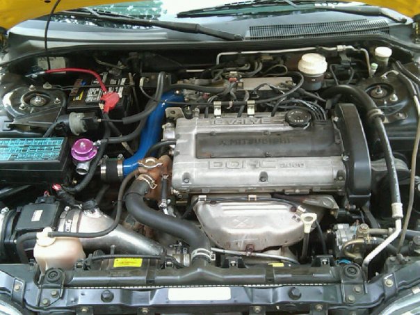

its still a virgin but suprisingly clean

Why are you venting?

Re: new guy from plymouth
i know i know its how i got the car just havent got around to take care of it yet not sure why people do that
T0 hear that loud BOV y0!!
My car was like that when I got it also, it ran like shit.
Old 08-18-2009   #30
Vented BOV was also the first thing I noticed.
Second thing was the dejon S pipe to the throttle body, I used to have one and the flange is super thin, I had to use some RTV to stop a boost leak there, a gasket didn't do the trick. Just a place to check for a potential boost leak.
Oh and welcome
vented bov fixed megan racing downpipe installed thanks to my man pat out in rogers thanks for the help yesterday bro......we didnt get to the megan o2 housing yet since pulling the stock o2 housing is a pain without pulling the turbo but we will get there eventually lol
Tell me about it.
I don't even think it's possible with the turbo bolted to the manifold, with the rearmost bolt having a hard line half an inch in front of it. And dropping the turbo off the stock oil feed line sucks even more.
Tell me about it.
yeah can just about imagine lol oh well its almost bigger turbo time
If you don't go for a new turbo, at least replace the hard oil line with a SS line. That way if you need to, you can drop the turbo away from the manifold without draining any fluids.
