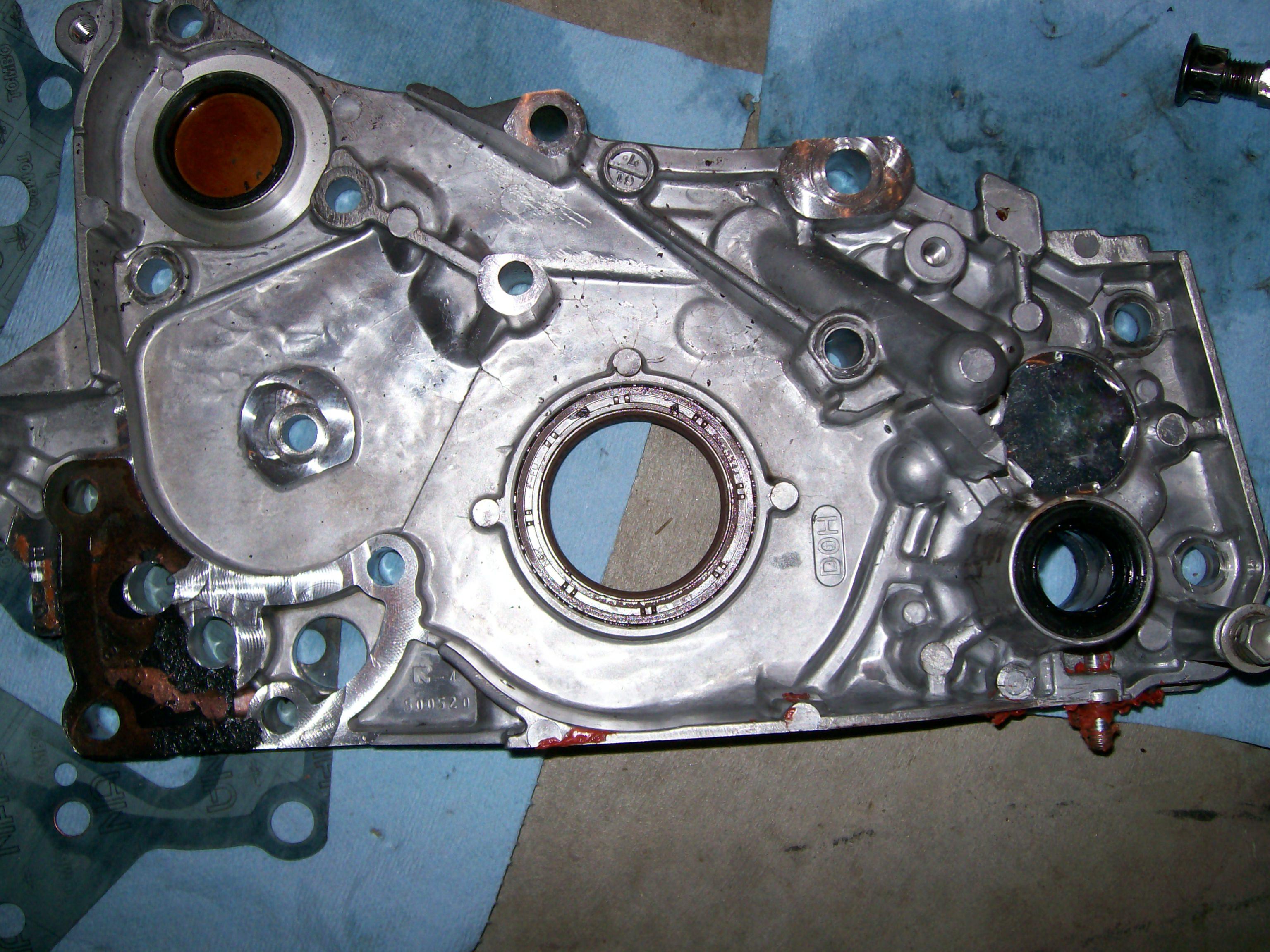

So you/they used a gasket on the pump cover?
I'm pretty darn sure you arent supposed to use a gasket on that cover at all.

On the small gear cover no. Im pretty sure hes talking about the oil pump front cover assembly.
But yes with a gasket there would be too much gear endplay. Also it could of had too much preload if those bolts on the small gear cover were too tight.

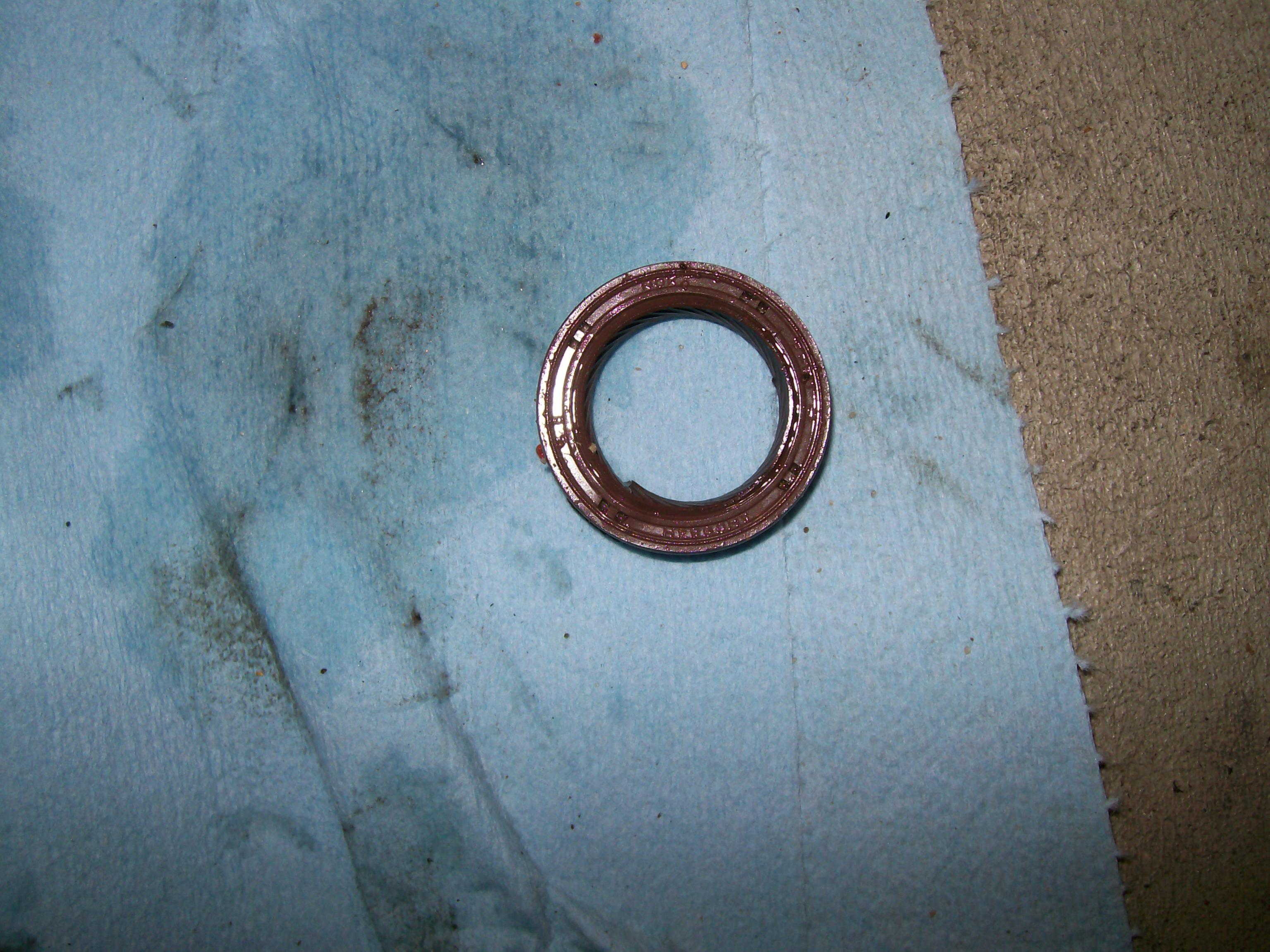

Here are the pics of the front of the cover. And the pic of the brown seal is the original seal. I replaced it yesterday with a black one that I had laying around (new) to see if it still leaked. That was before I took the pump off the block to find that it was messed up.
The DOH lettering on the front matches the other 2 old Mitsu pumps I have laying around.
