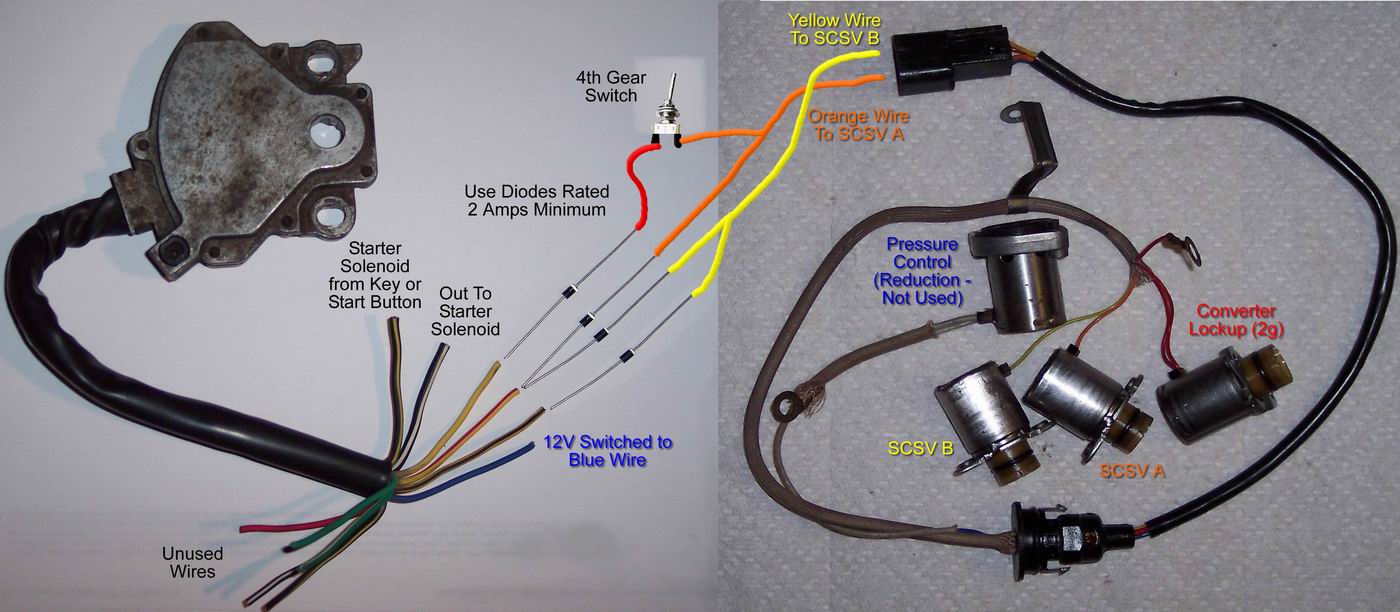

I've made alot of progress since my last update. The auto trans is all bolted up.I just need a few more things to button everything up. I desided to go a little different route then I originaly planned. I bought Goodharts Nitrous kit and will be using it to stall up on the stock converter. I also ditched the idea of using a reprogramed TCU for the Kiggly manumatic mod. The Manumatic mod eliminates the need for a TCU or shift box. You simply put the shifter in the gear you want and the trans shifts a full line pressure . I will probly go with a ratchet shifter whern I havesome extra money.
All I have left to do is:
1. Install the nitrous kit.
2. Put the center counsil and drivers seat in
3. Install trans cooler/ reinstall radiator
4. Put upper intercooler pipe back on ( from the looks of it it will just clear the trans)
5. Wire a few things. power to trans(kiggly mod), nitrous controled by DSMlink
Pic of kiggly manumatic mod attached.

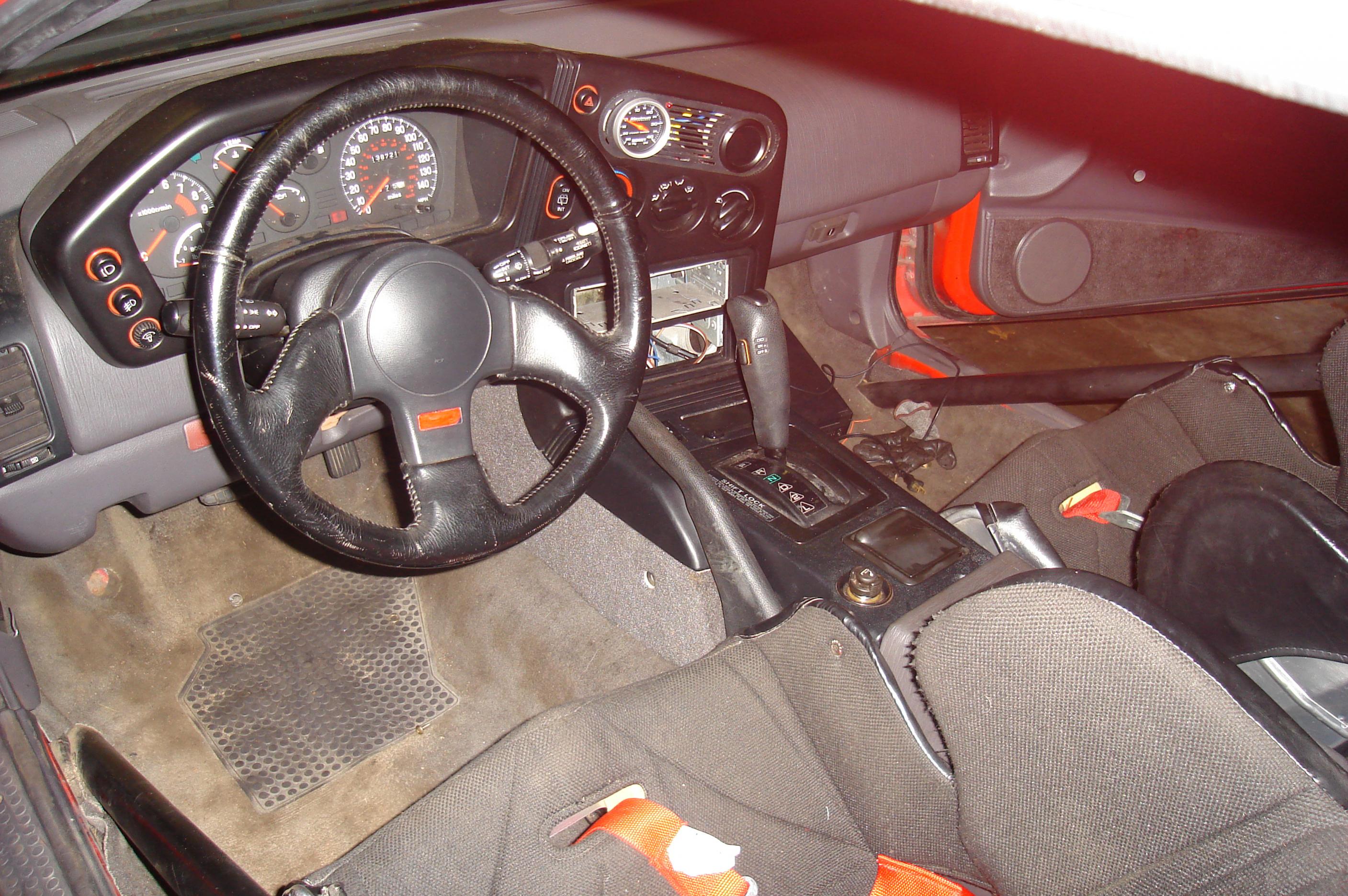

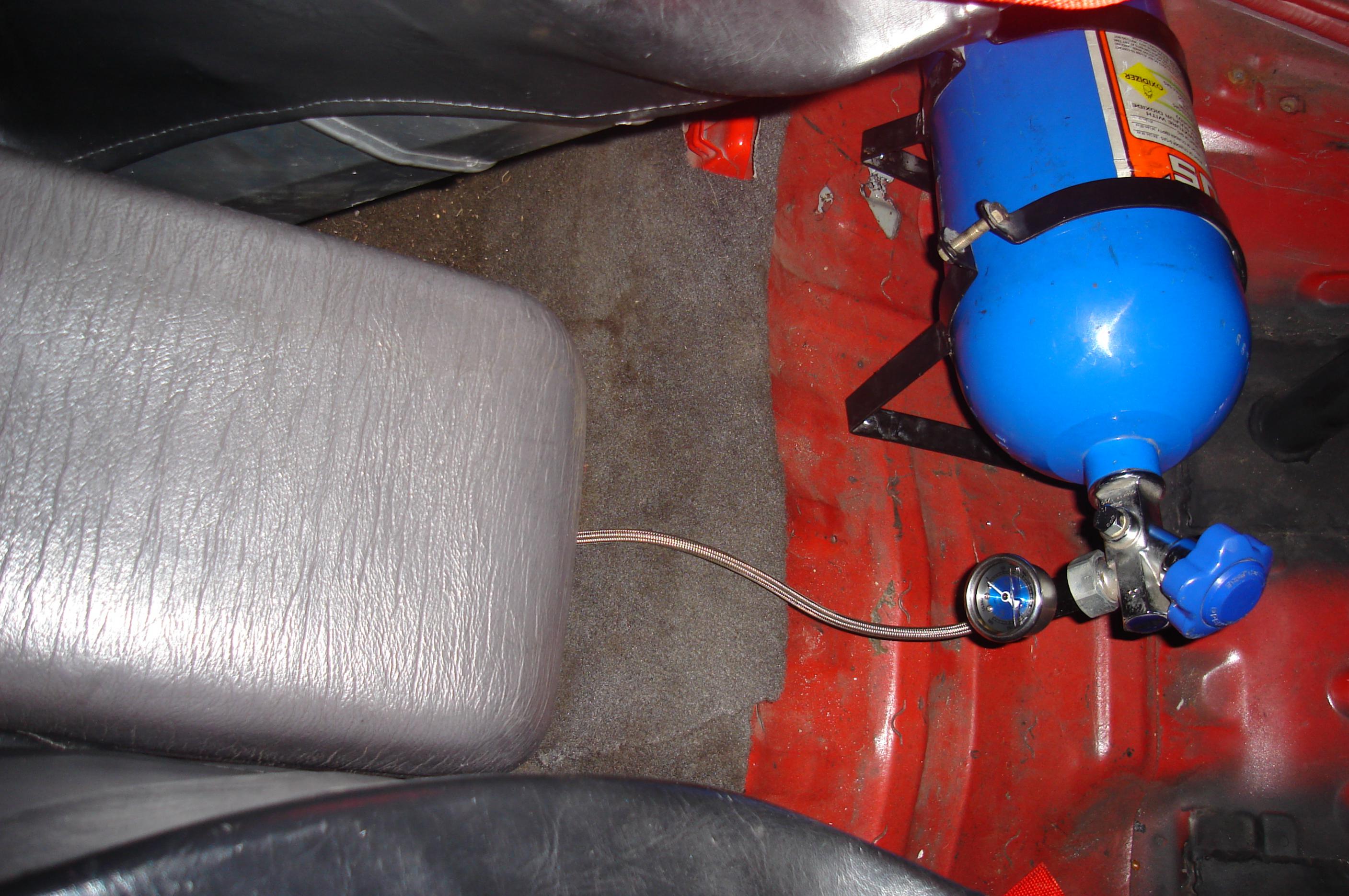

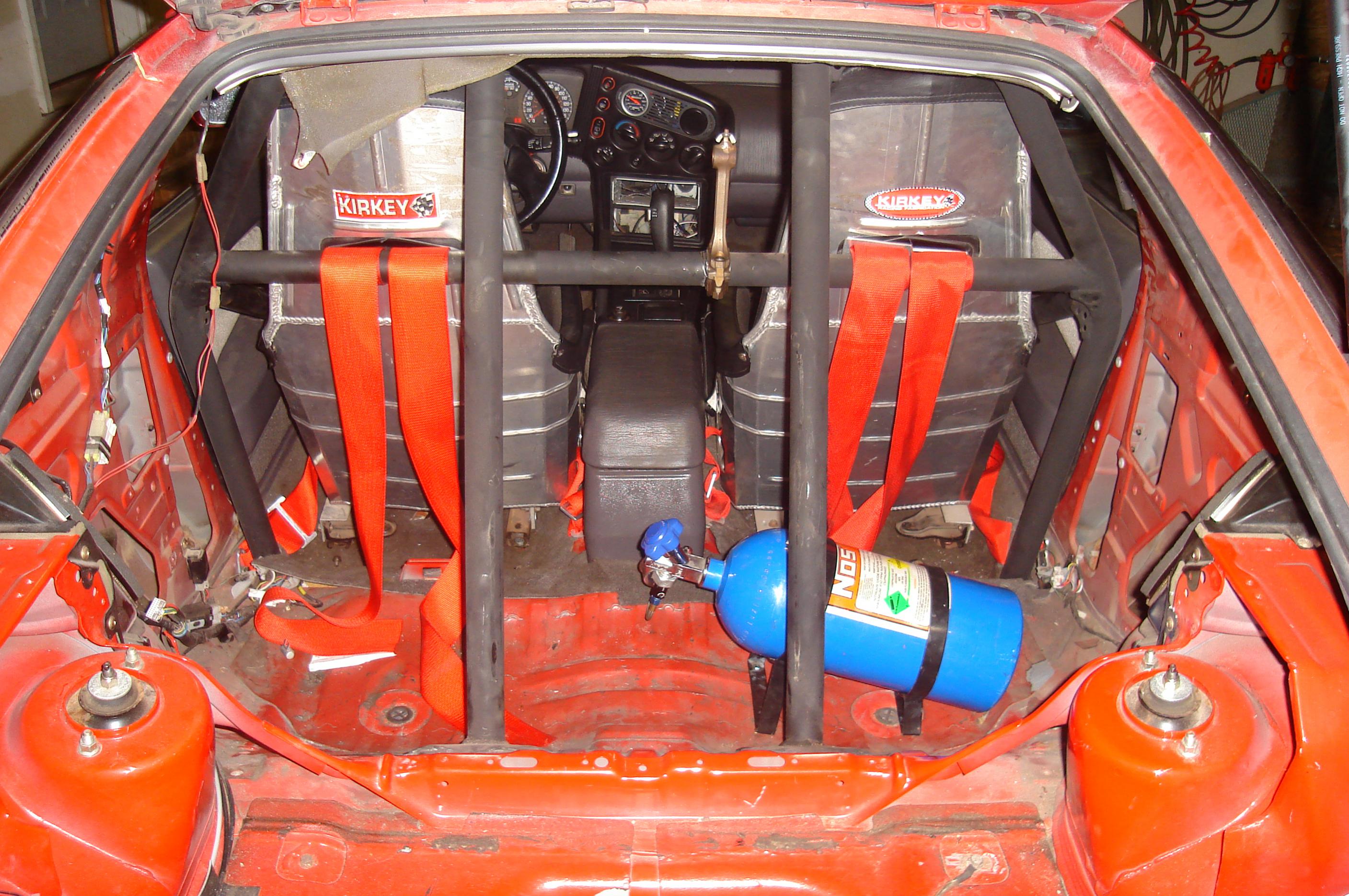

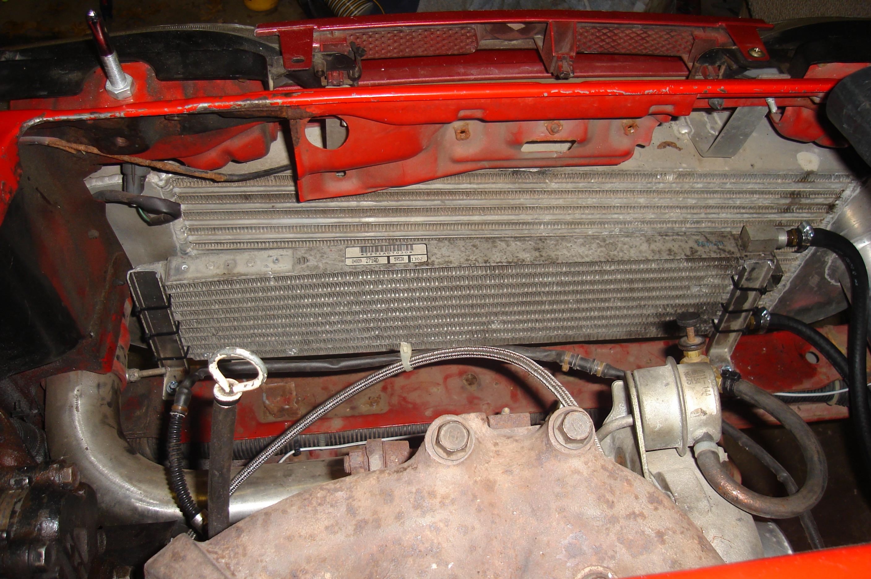

2:00 AM progress update. I got alot done today. I got almost all the wireing except for the nitrous buttoned up. I got the cooler installed and plumbed, and Radiator back in. Got all the interior back in (even got my cigarette lighter working for laptop charging etc.) And I got the nitrous bottle mounted and line run to engine bay. Not mutch left to do till its driveable.

With the pick up tube in the nitrous bottle you are going to want to angle the outlet to the back, not the front. Looking good.
