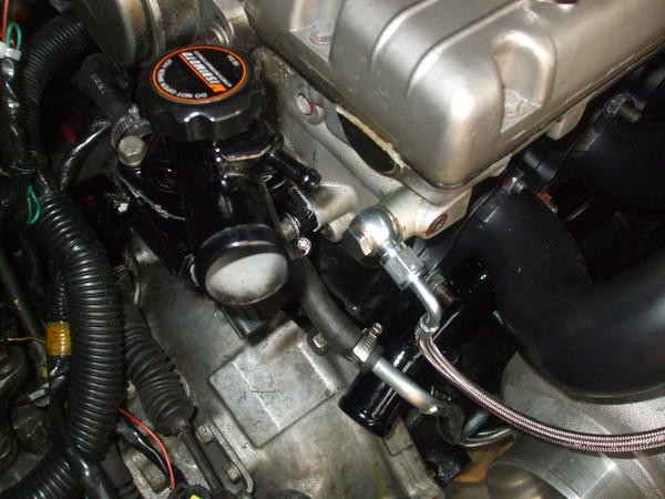

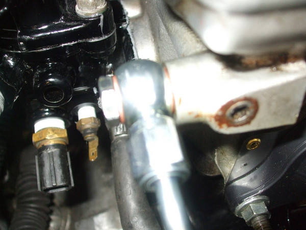

pictures of completion of my fuck up. Thanks Mike and Paul
