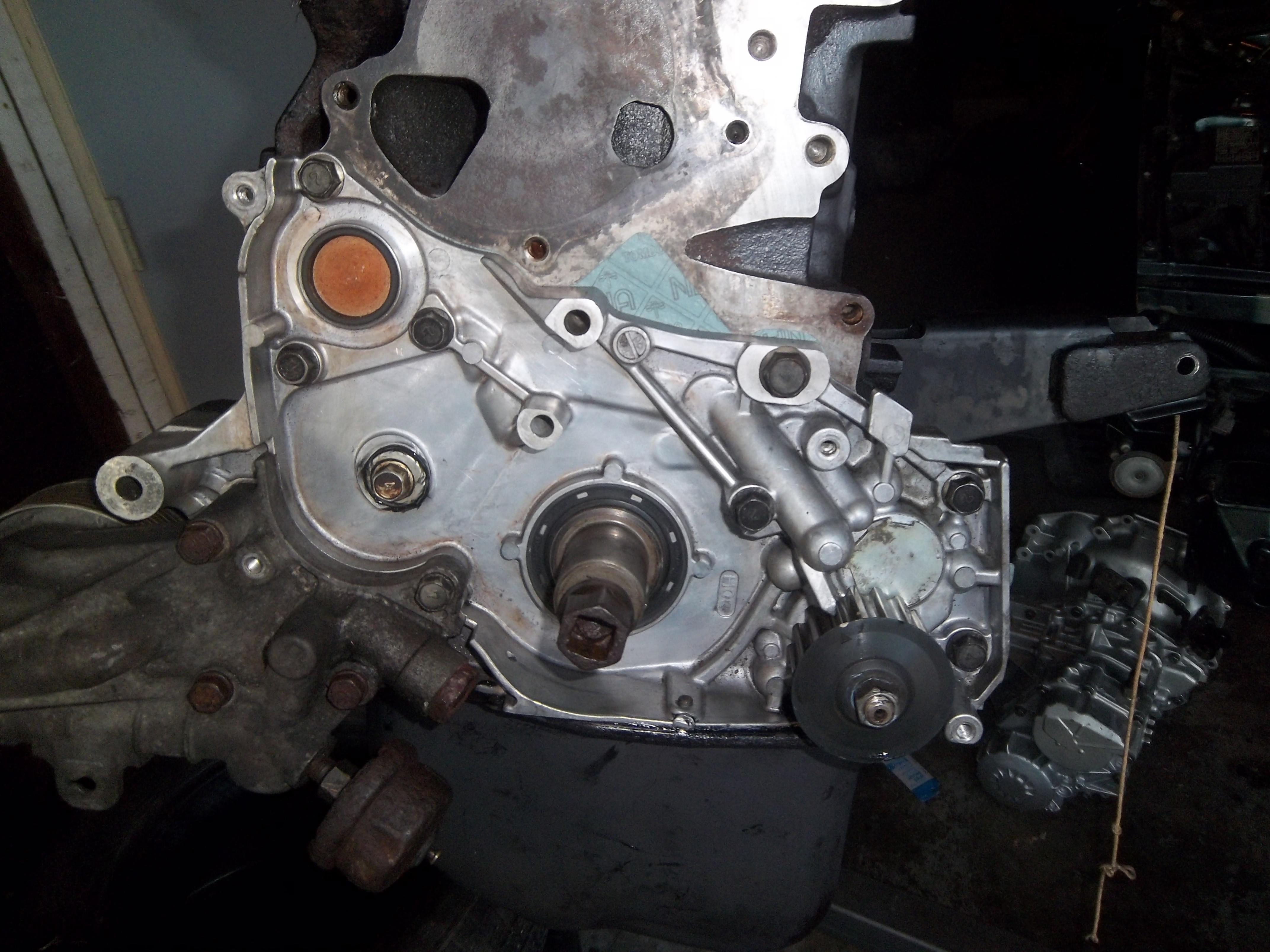

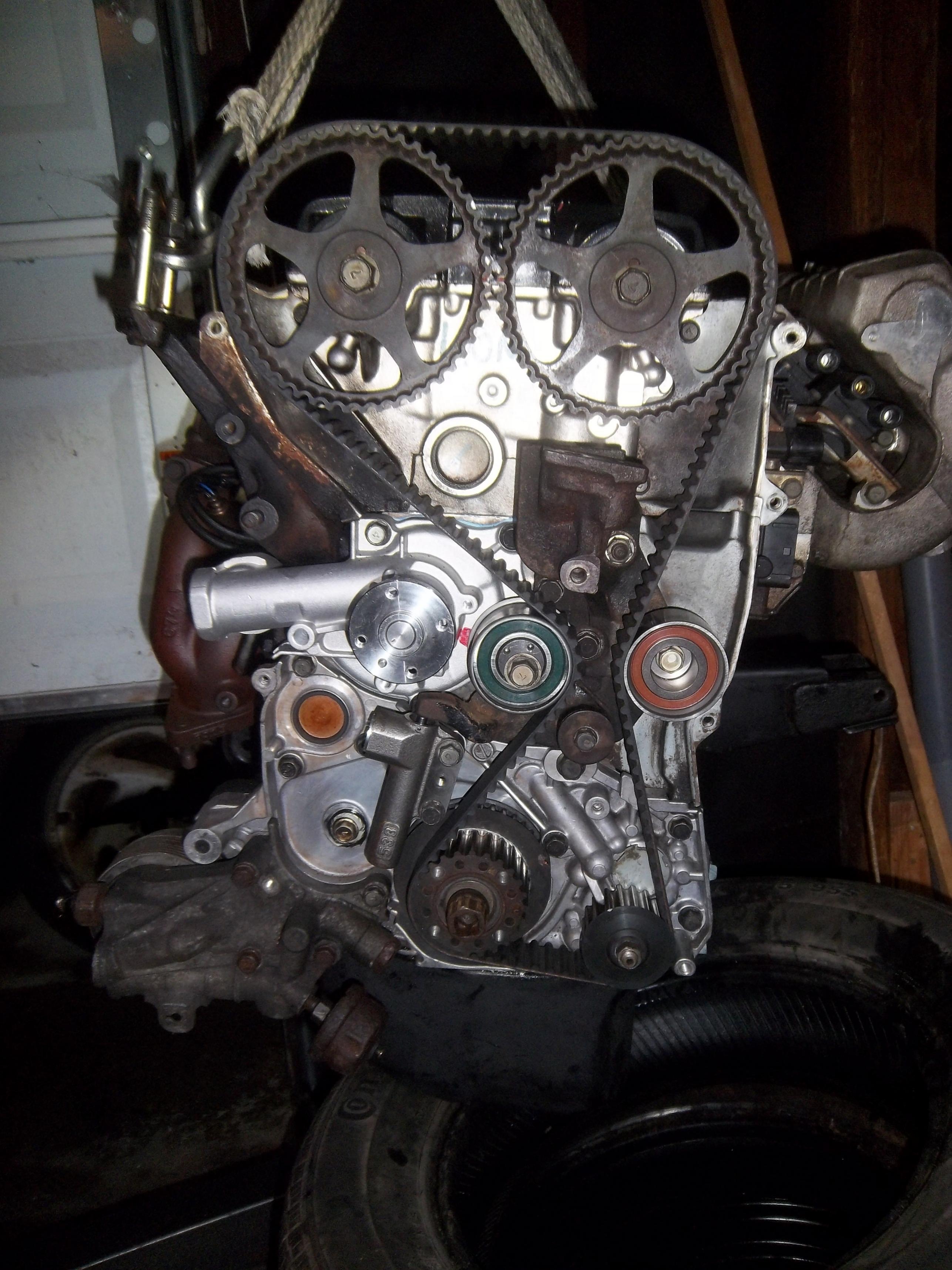

So with the motor out of the car, I decided to clean up the stock motor a little bit.
Freshly painted block and oil pan
Balance shafts eliminated
New front case gasket, oil pan gasket, front and rear crank seals.
Next thing is a new water pump, head gasket and head studs. As funds become available I'll get the clutch, injectors, wideband and eventually Ecmlink V3

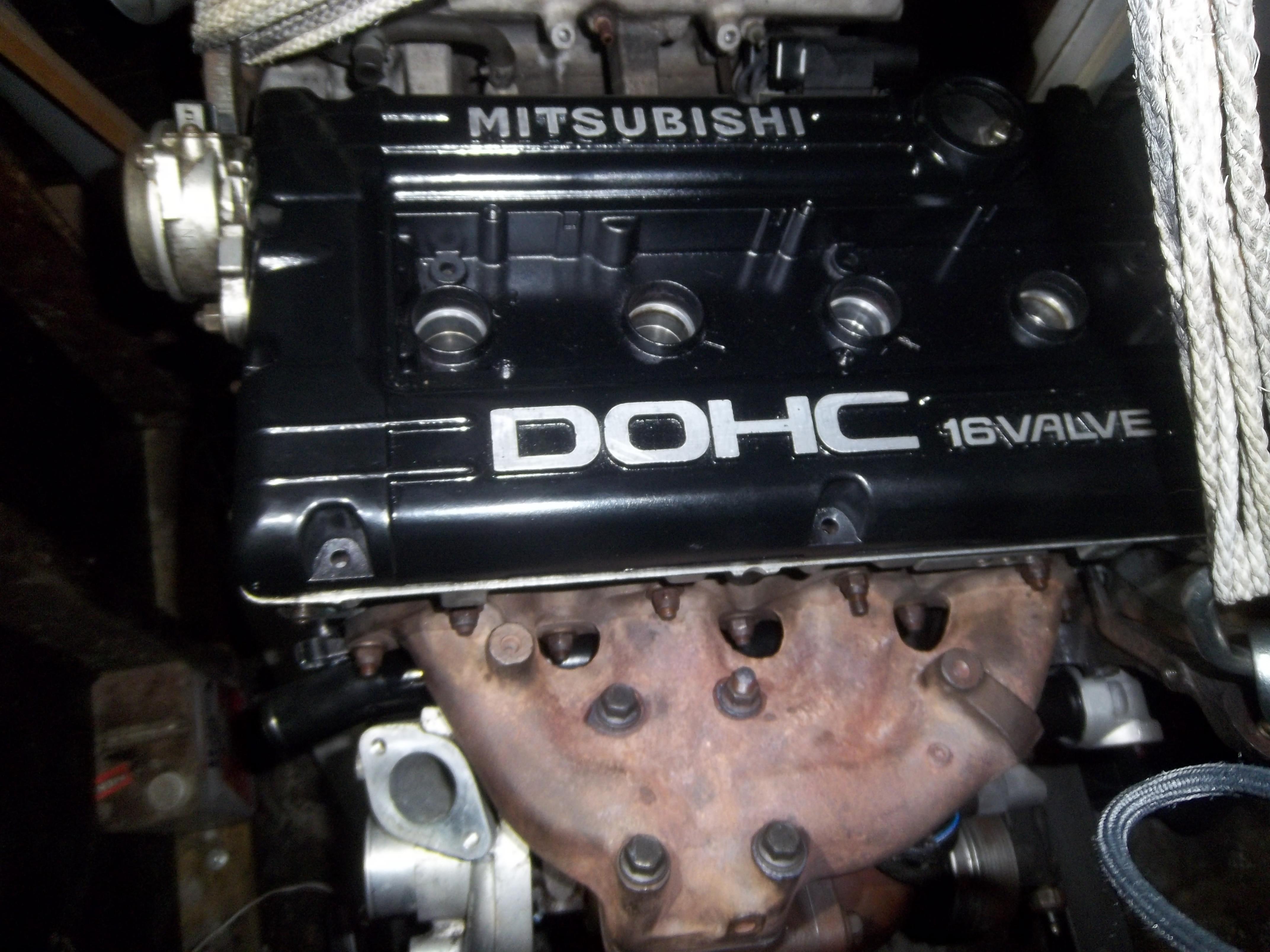

New water pump, OEM composite head gasket, ARP head studs, 100 miles on the timing belt and components so I reused them. Painted the valve cover black. All new turbo gaskets, intake/exhaust gaskets.

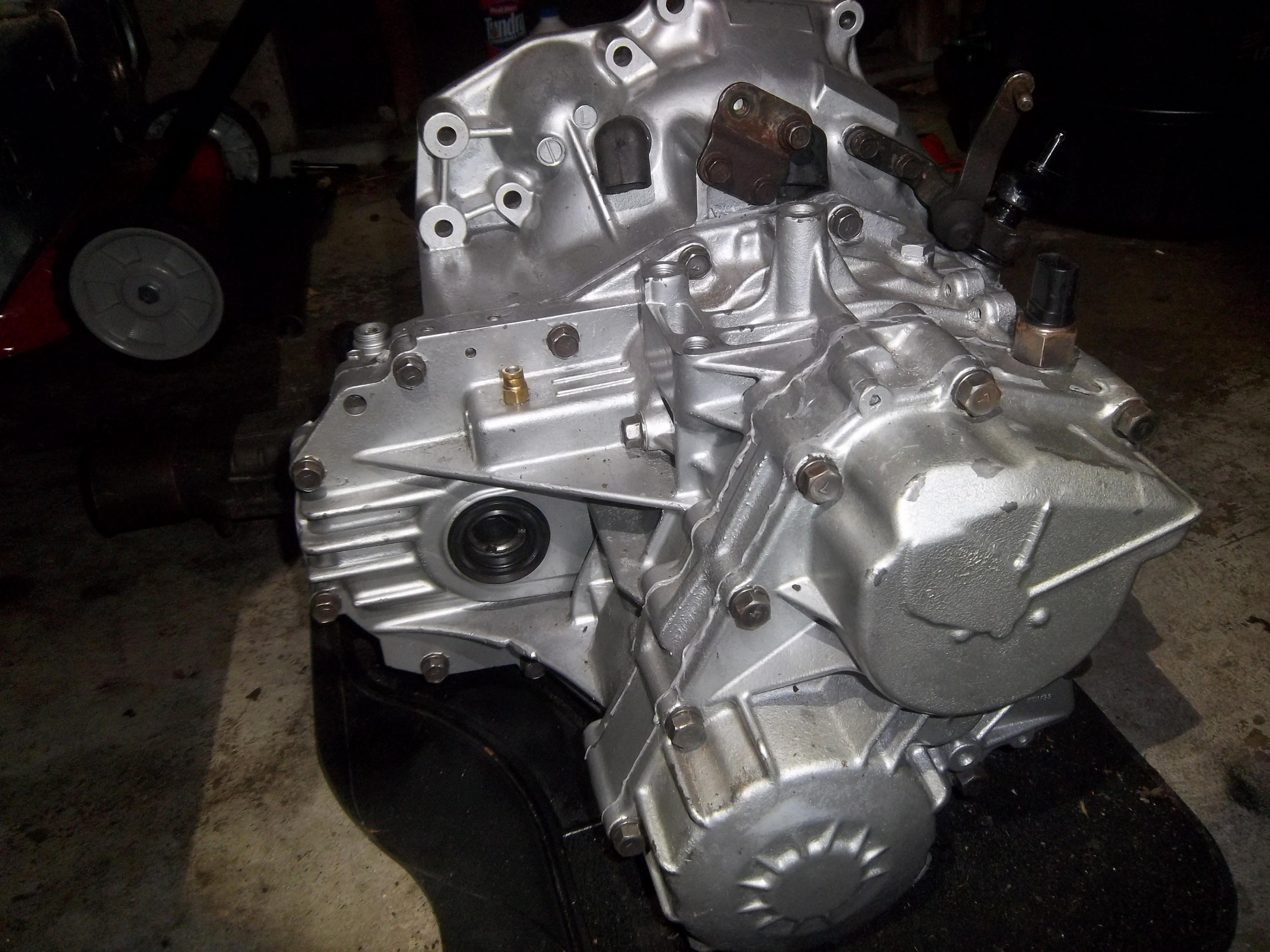

Next, I buy the clutch so I can bolt this baby on the motor and drop them in the car

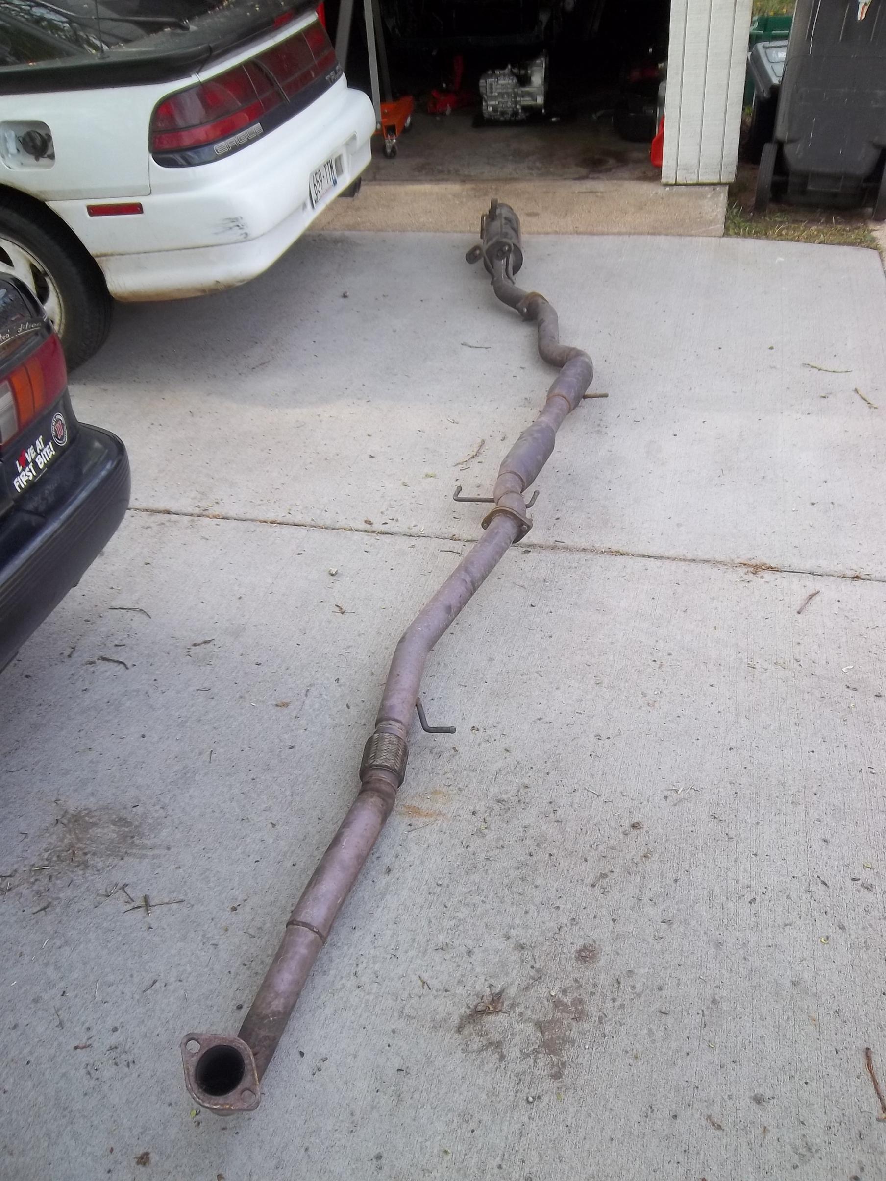

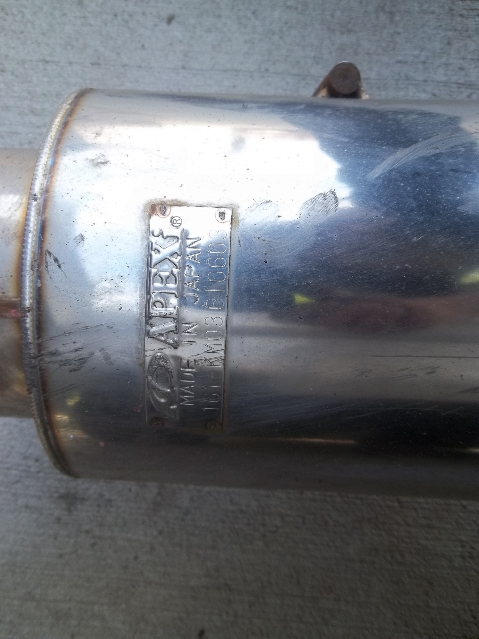

Apexi Exhaust pics. Full 3" with 2.5" down pipe

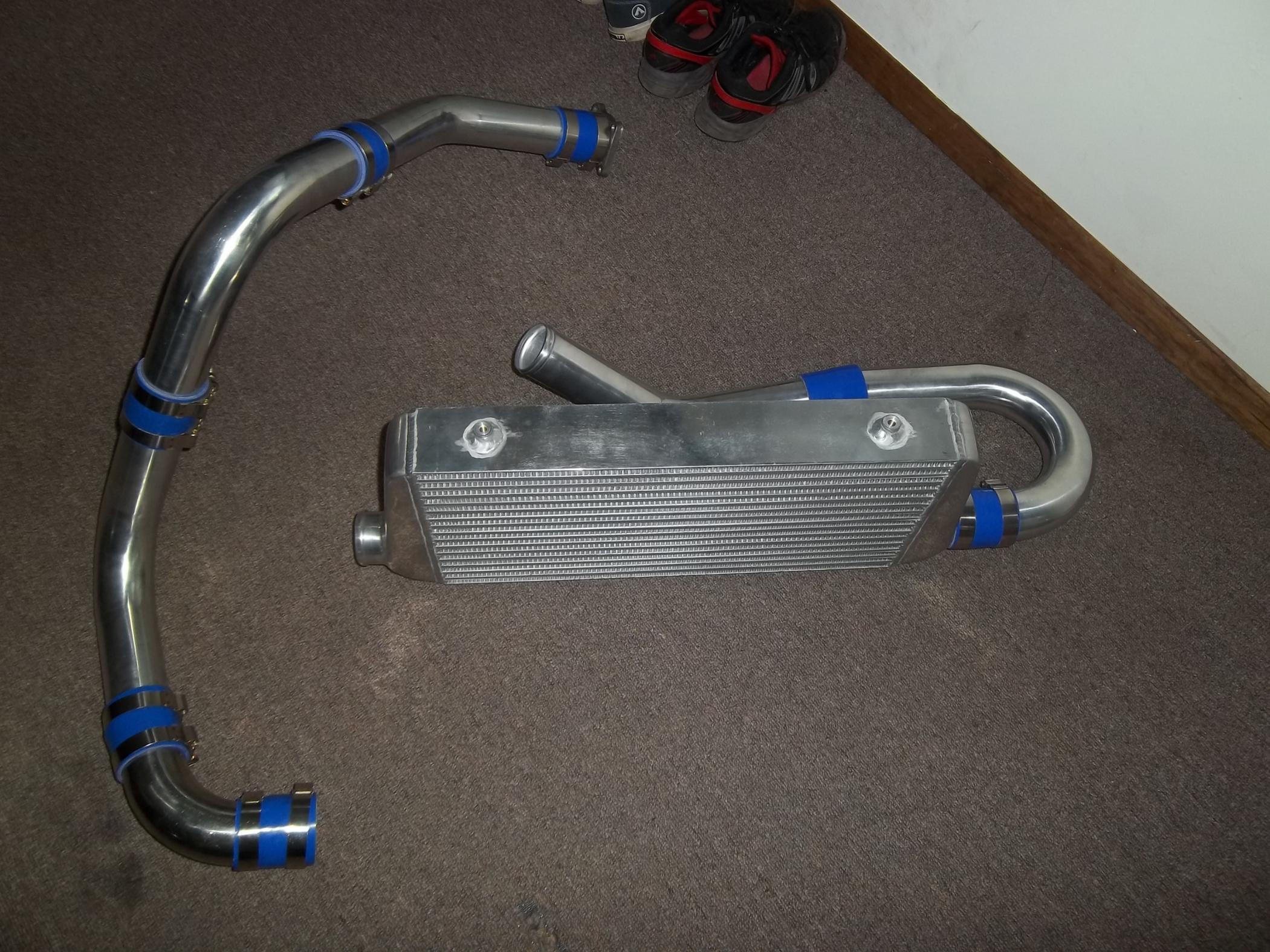

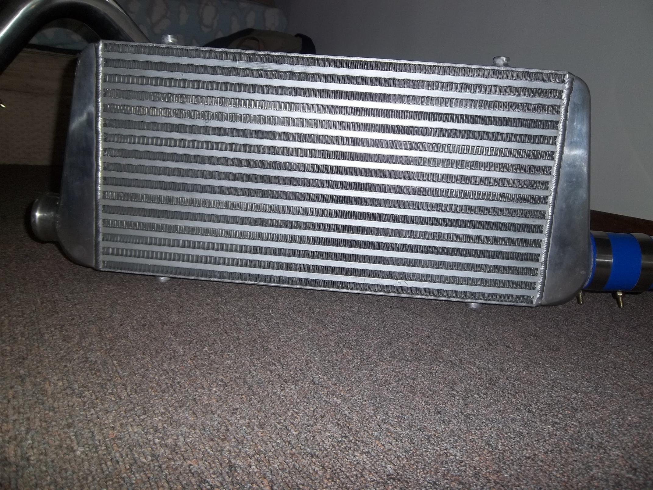

Ebay FMIC w/2.5" piping

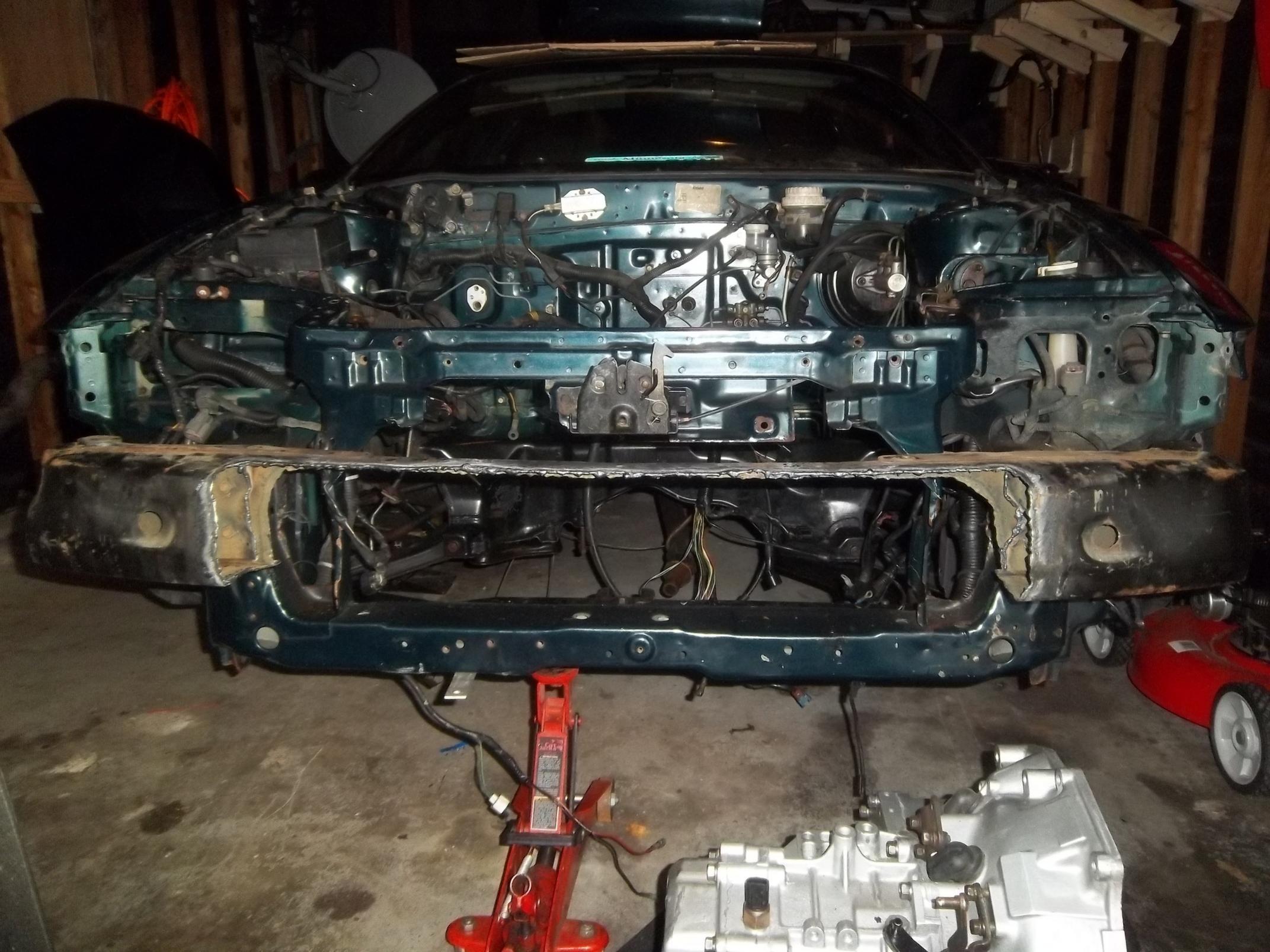

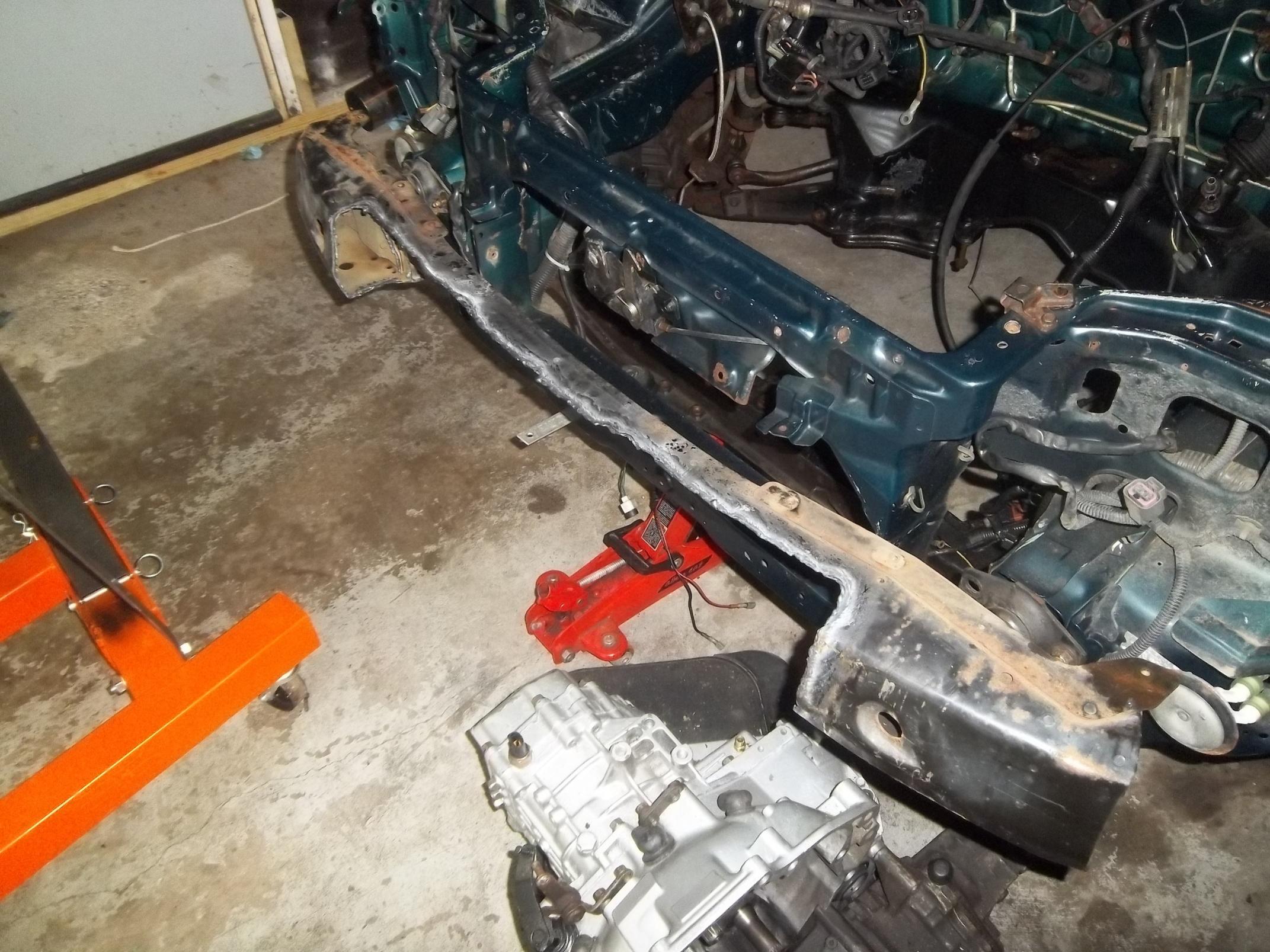

Bought this 1gb bumper today, didnt take long to cut it up for the FMIC install (thanks to an oxy-acetylene torch).

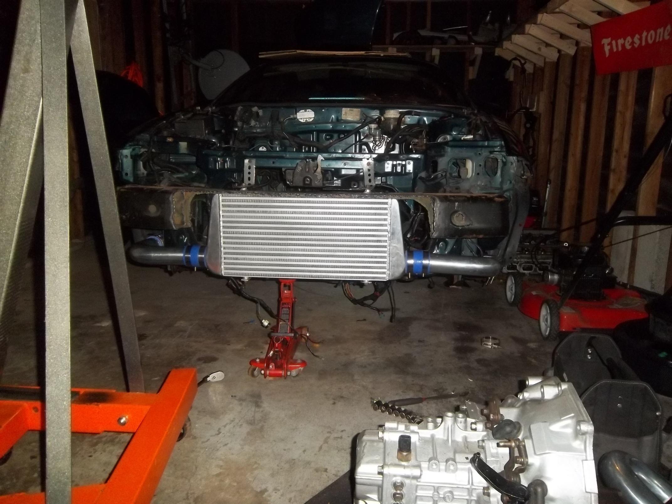

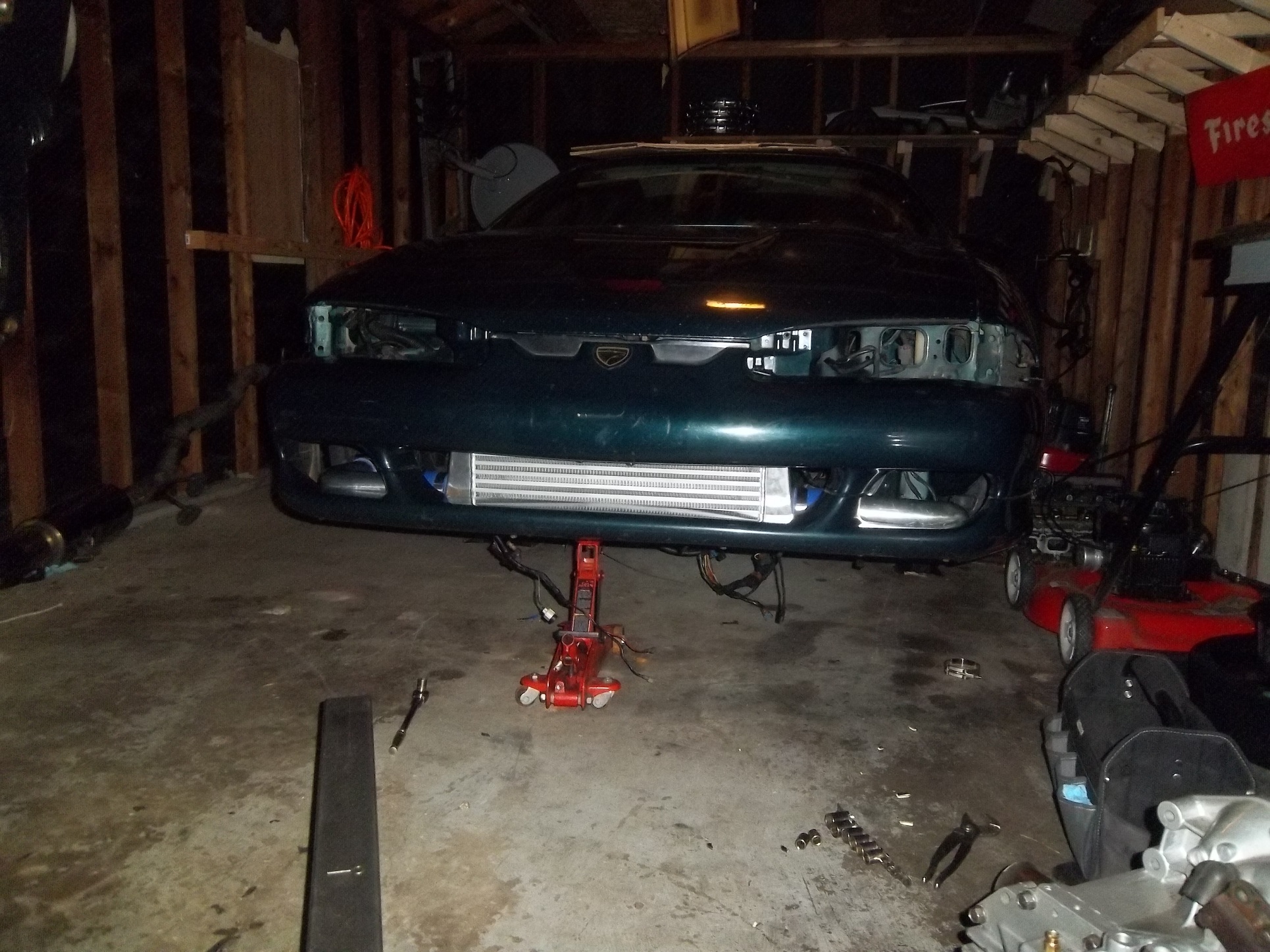

Re: 1g 6 bolt 4g63 tsi build

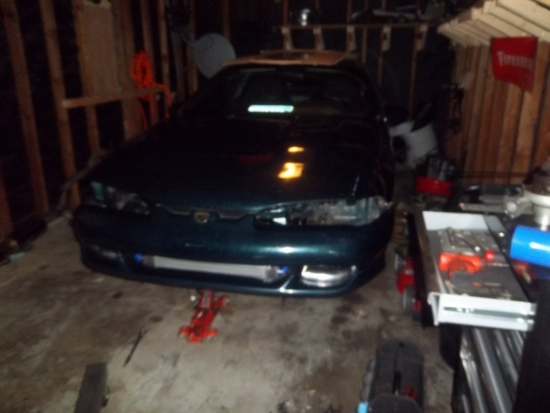

Installed FMIC, took some pics with the hood and bumper on. Going to be buying the clutch soon.

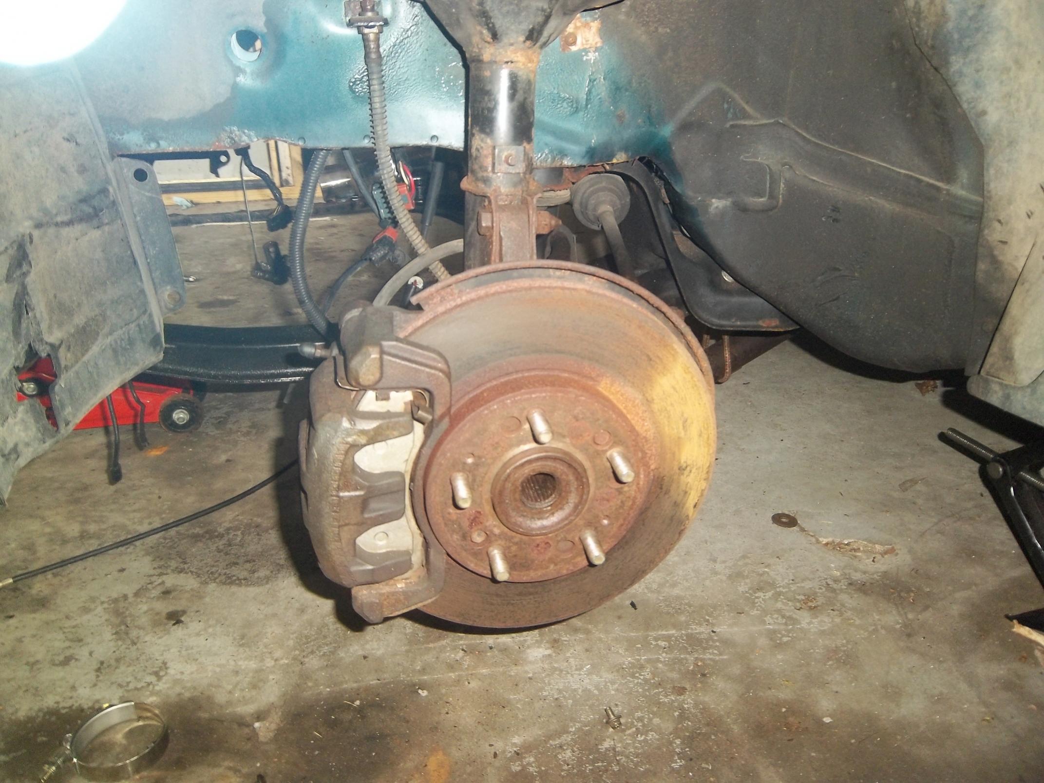

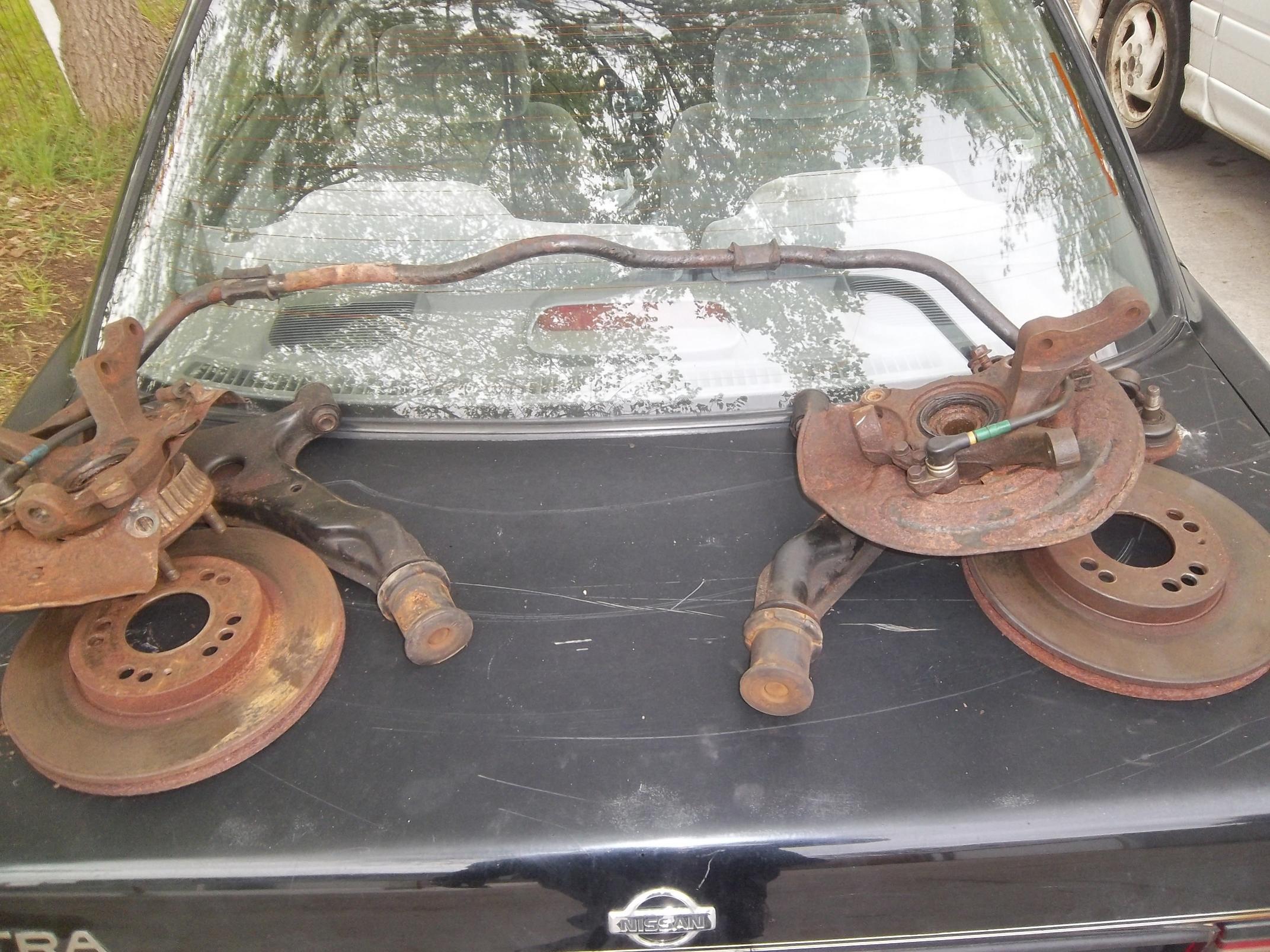

I dont know how long this thing has been sitting, Ill be bringing these parts to work so I can resurface the rotors, press in new lower ball joints, and press in new front wheel bearings. The ball joints both had a lot of play, and the bearings felt very rough.

The rotors should be fine, they have probably 5k miles at most on pads and rotors on all 4 corners. As soon as you step on the brakes the rusty film will get knocked off them.

Good looking build man, i sure hope you have something else supporting the car other than the floor jack like in the above picture...i'd hate to see a car come down and sqaush a mofo
