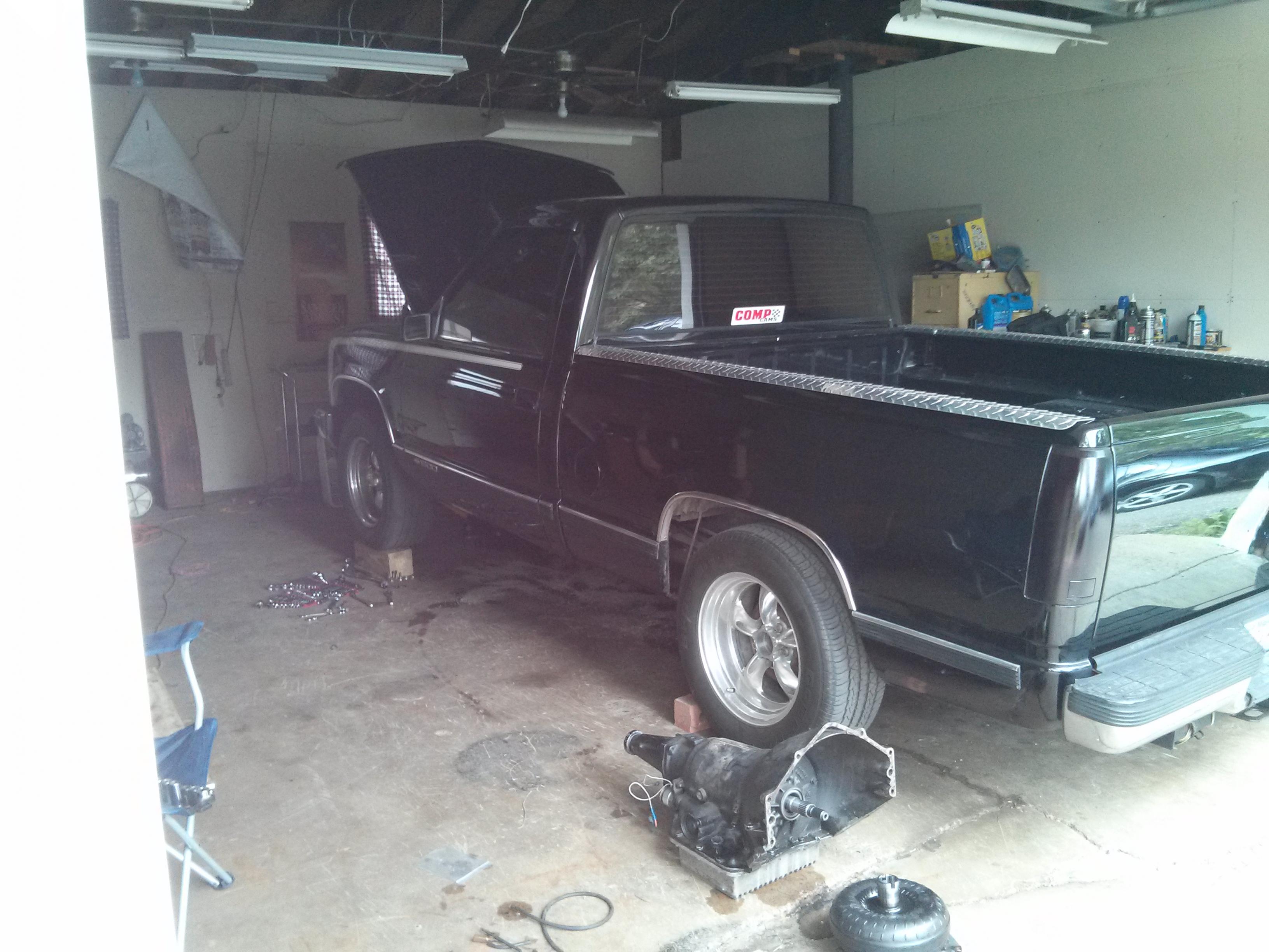

Old 07-07-2013   #29
93gtpeater
Location: stillwater
Drives: cbr 1000rr repsol
Posts: 1,451
Re: project darkness
Well it only took a couple hours to get the transmission out. Now am looking for a place or person that can inspect the transmission before I order a new converter. Hopefully I will have it back together in a couple of weeks. If anybody knows of a good place/person that can inspect my transmission send me a pm. Here's a pic.

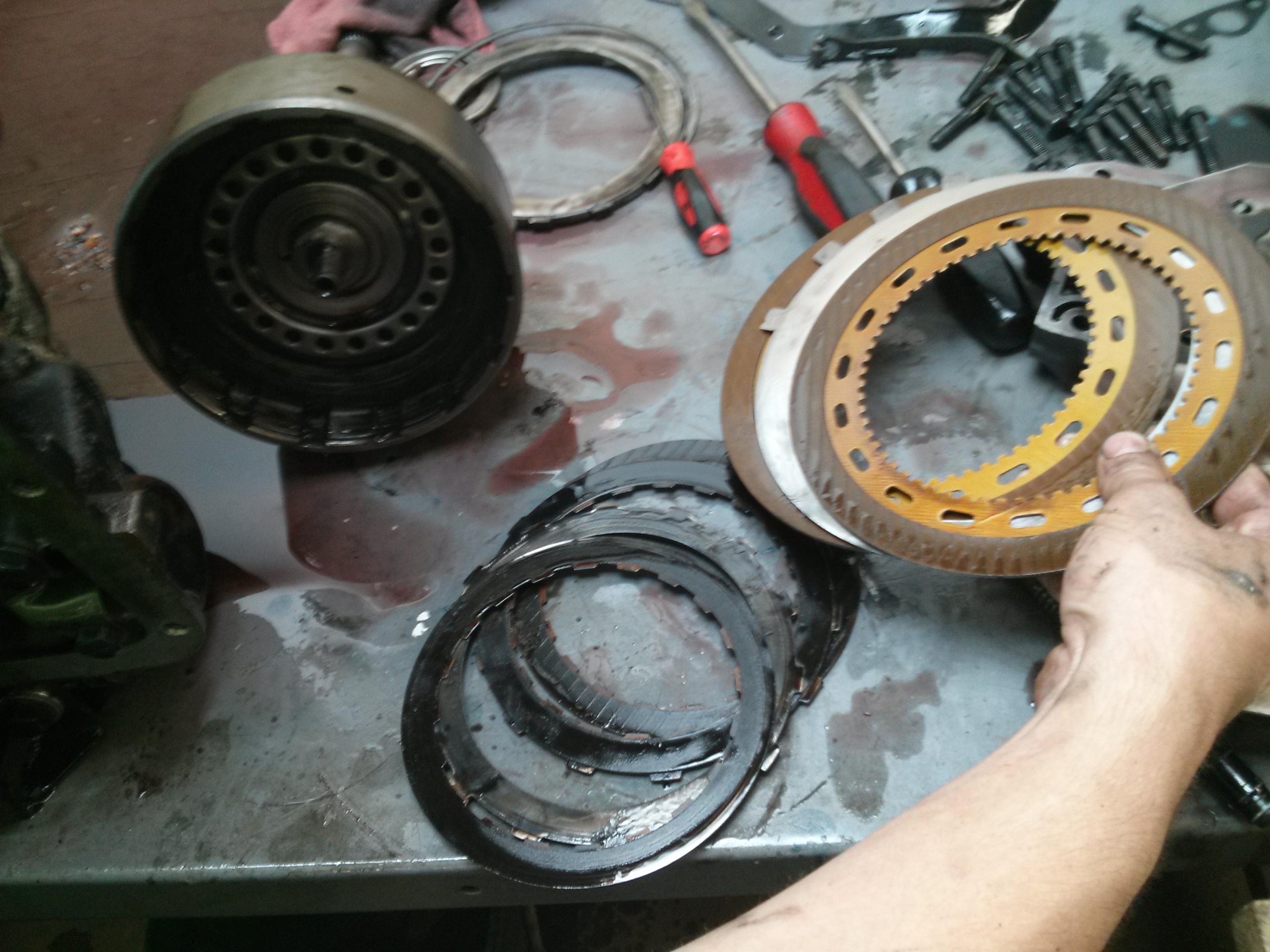

Old 07-10-2013   #30
93gtpeater
Posts: 1,451
Well the transmission is getting rebuilt. Pulled the pan off and it didn't look good. Lots of metal shavings.... Took the pump out and started taking the clutches out. We gout done to the 1st clutch pack and it was smoked. Here's a pic. I am sure you can tell what ones are bad. I should have the transmission back Saturday and hopefully if I have help I could have the truck done Saturday night. I did some research and found out I am really pushing this transmission to the limit. So maybe over winter if I decide to build this truck up I will buy a fully built th400 which will be good for 900hp. Shipped to my door for 1750.

hmm 900hp truck
