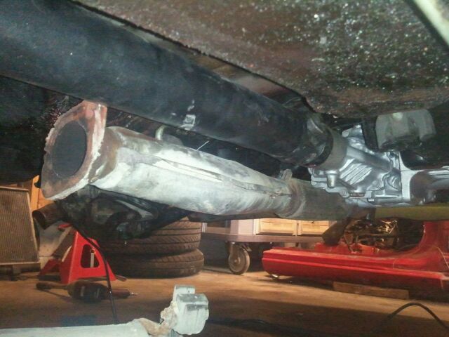

I will look to see if it might be hitting the downpipe.
The driveshaft looks pretty darn straight when it's bolted up and I tried my best to align it exactly where the other bracket that I removed was. But I don't have a tool to measure the angles of it, so I have no real evidence.

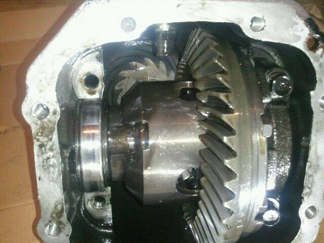

Idk if this pic helps but this was right before the last cap went on. There was no excess play in the pinion gear when I grabbed it from the flange where it connects to the D.S. And I never touched the lsd part...If that's what you are referring to?

Yeah with a new ring and pinion, you will most likely have to re-shim the pinion or differential carrier. Without the proper pattern, you can get vibration and can cause a lot of damage to the differential carrier.

Pull out the cover, mark like 5-8 teeth with some gear marking compound, and turn the pinion until you can see the pattern on the ring. You will want to spin it both ways. The rear end has to be able to spin so it would be easier if the driveshaft and axles weren't in it. Otherwise I think you should be able to spin it with all 4 wheels in the air in neutral.

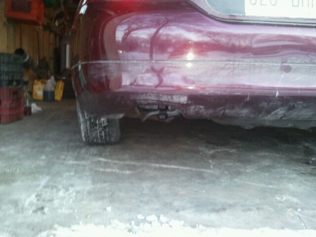

That camber issues looks pretty bad. I would definitely fix that asap as well.

Heres the positive camber and toe issue. Toe isn't as far out as I remember but is still definitely positive.

Holy shit, that is some serious positive camber. You know how "stanced" cars only ride on the inside edge of the tire and how dangerous it is? That is basically what you are doing, except riding on the outside edge of the tire.

Holy shit @ that pic. Doesn't take an alignment machine to tell you how far out of whack that is. I'd get that corrected ASAP. I'd be fixing the things I know are wrong, one by one, and go from there.

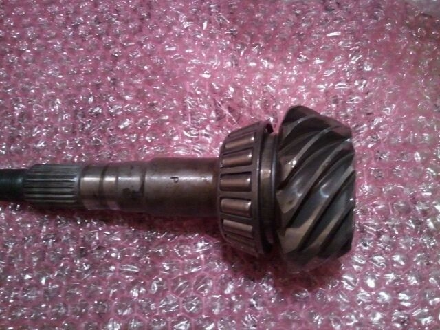

Just thought of what it could possibly be!! When I did the ring and pinion gears I never swapped this bearing and spacer over I just used the one already on the pinion gear that I received!
I'm guessing I was supposed to do that!? f me if I was lol
