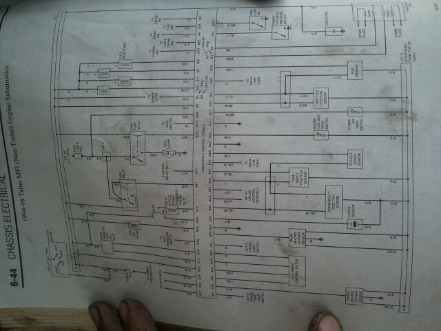

Got an update. The whole bottom side of this schematic (side with crank and cam sensors (on the right)) is not getting power.
Everything on the top of the page is fine.

is that linked to the mdp fuse? also another thought. how about a sensor ground that connects those together? I don't have my book in front of me.

Here is the ecu pinout. I don't think the 420a's have a mdp.
http://2gnt.com/index.php?d=1998_ECU
Still could be the computer, have not re-tested this since ripping the remote stuff out. Check Engine light still doesn't come on when turning key over which makes me think it's ECU related.
