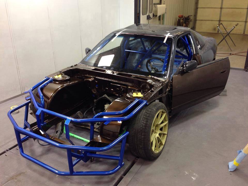

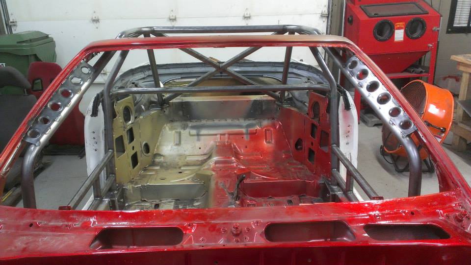

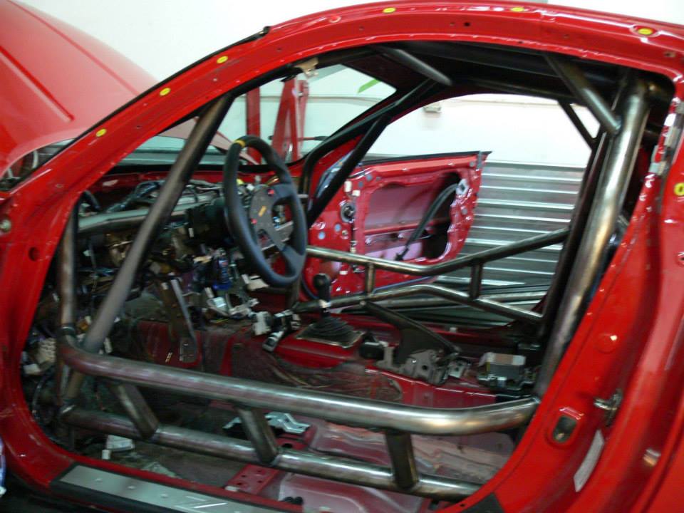

Patience metal fab seems to be big into tubular stuff as well and they can get certifired.
I have talked to these guys (turns out the be the company that did MAP's sponsored drift 240sx) and I really like what they do. I'll check in with them when they are open. Racecraft thought I was nuts, and I'm waiting on a reply from Vassil. Worst case I just go tubular front end with new strut towers front, and have Patience do a new floor pan along with a roll cage connected to the rear strut towers.

I also contacted the fab team that did the green 240 drift car at MAP's show and he estimated roughly 6K give or take for taking the shell and adding in a tubular skeleton throughout allowing all the stock stamped metal to still serve as mounts and shaping, yet have the rigidity needed to not worry about strut rust, floor pan damage/repair, etc. The issue I felt with going with that option was simply the feeling that cars or at least street cars weren't their biggest markey/forte along with a long time frame which didn't bother me however.
Are you sure he wasn't just quoting you on a tubular front suspension/structure and/or roll cage? That seems awfully cheap. You do realize that once you remove the unibody, you have little to no positional references right? This is a massive undertaking to do it right and get all the pickup points dimensionally the same.
If all you want is something rust free, just find another pristine running/driving DSM from down south or something. It will cost you less and be far less hassle and you'll get what you're expecting.
Originally Posted by dogwhistle View Post
IThe car would continue to be driven on a regular basis (currently everyday, but doesn't have to stay that way by any means.) I would mainly be interested in something light, stiff, safe, and resistant to the usual corrosion and abuse that most DSM's suffer from.
I don't think you realize what this would actually be... a stripped out, loud, harsh, rough, bare bones race car. Even trying to fit all your creature comforts back in there would be ludicrous and difficult. You would NOT want to daily drive it.
Are you sure this is what you really want? I'm seconding Nate on this.

Eric's car (green 240) was far more than $6k to tube chassis.
I agree with single. I don't think you know what you're asking for. My caged and back-halved 1g was ridiculous. Just getting in and out of it sucked hard. Too loud for the street, absolutely zero creature comforts and #becauseracecar problems left and right.
My 10pt caged / not back-halved 1g was ok on the street but not even close to something I would want to DD. Again, did have #becauseracecar issues because of a billet stall on the freeway. In all honesty, the only time I took it out was when I knew for sure something special was out. I'd scout first with my DD.

I would even suggest subtracting tubular front and rear subframes. Just get a clean southern car and have a cage added by bulfab, etc. Do maintenance on it, get it in good running condition, add necessary upgrades for tracking the car, and go have fun. I am basically currently doing exactly that with a new racecar for WRL/Chumpcar. LMK if you want help or advice.
