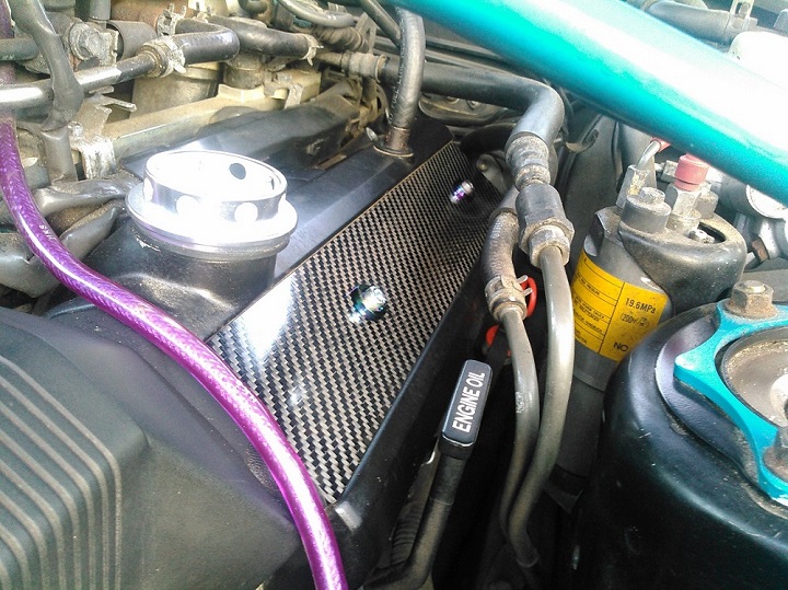

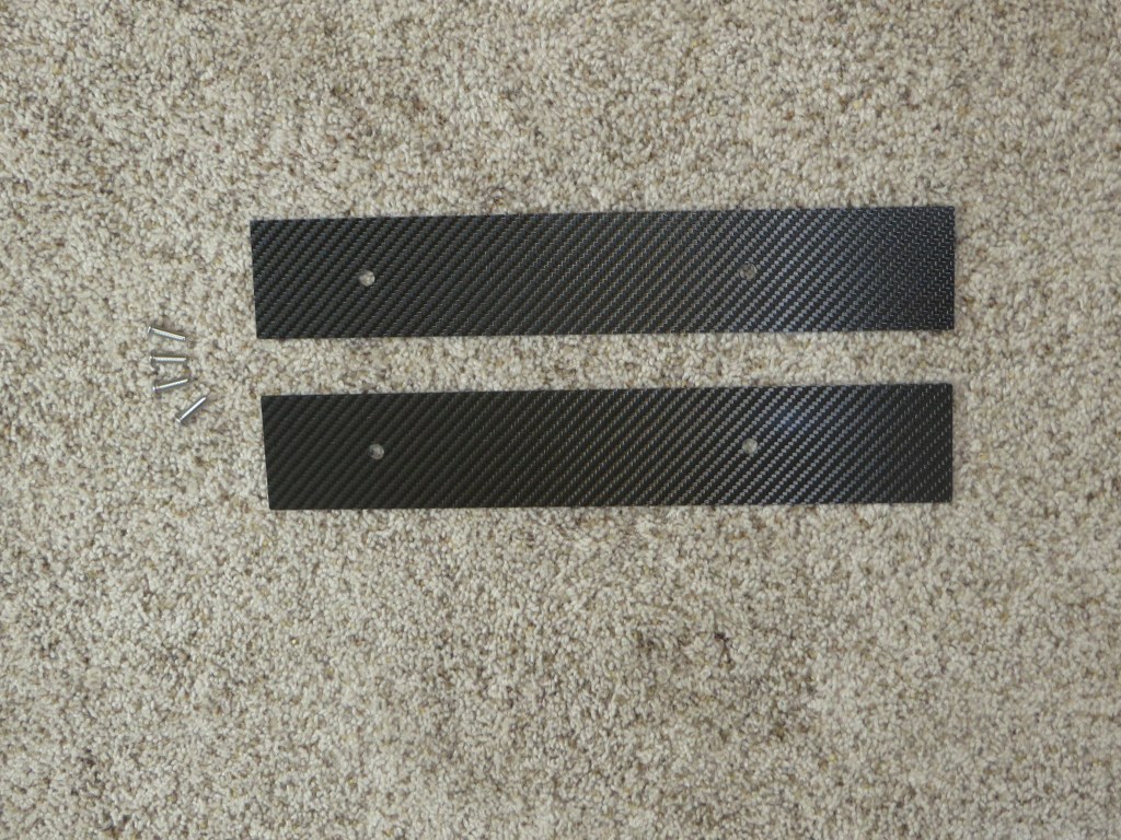

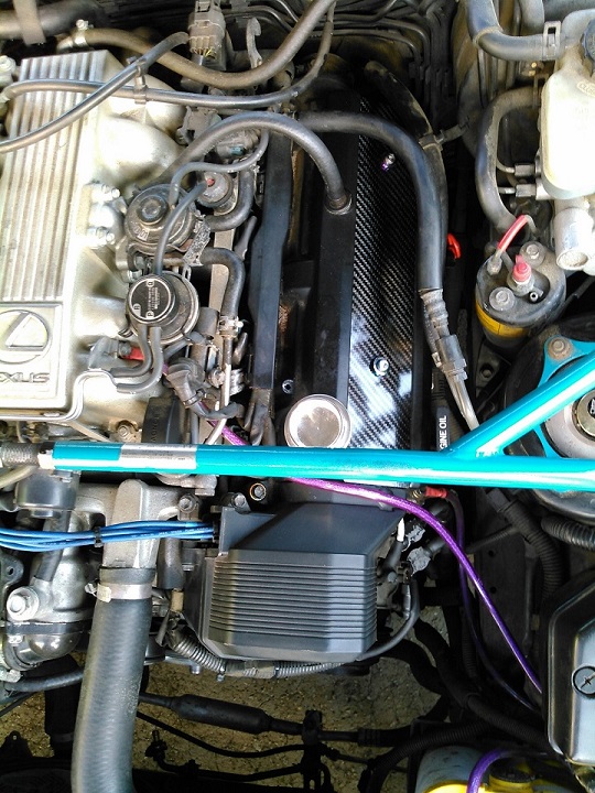

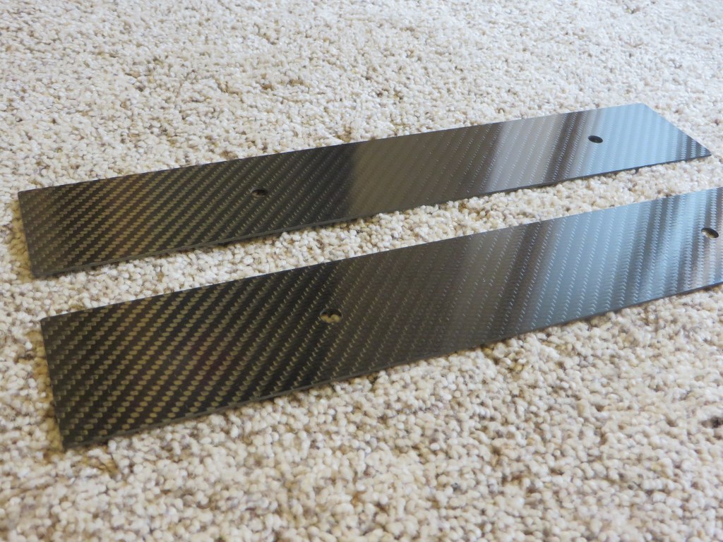

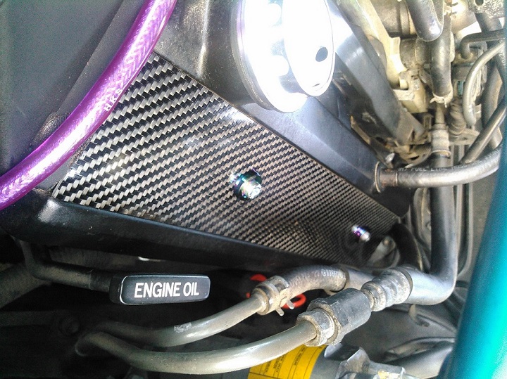

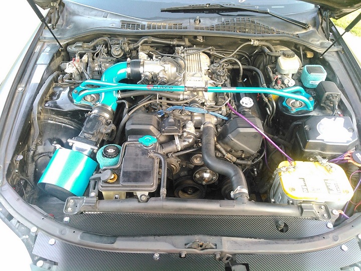

Another very simple piece. It's a spark plug cover for the 1UZFE (SC400) motor. Someone with my other covers asked if I could make it for him. So he helped me with the prototype set. Said fitment was spot on, he was really happy with them. So I made a few more sets. One local guy (red drift SC400) has a set now, and two more sets just got thrown up for sale today

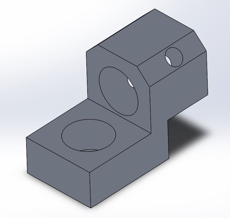

Also I'll throw this one out there too. It was a very small piece that Rosey and I both designed, and Rosey machined from Aluminum. It's a small shifter linkage piece that can be used to make a shorter shifter assembly for a CD009 transmission. There's shops selling shorter shifter assemblies for the CD009, but they range in price from $230-$350. They are out the door solutions which is great, but for people on a tight budget that don't mind a little DIY action, they can use this piece to make a homebrew shorter shifter setup for around $70. Thanks again for the help creating this Rosey!!
Here are some pics of the small little linkage piece. And then all they do is buy a 240sx short shifter off eBay ($40-$60). Then they just cut a few inches off the base, drill two new holes, and use this fitting to couple it to the trans shaft.
240sx short shifter - modified:
The aluminum linkage piece:
And the end result:
