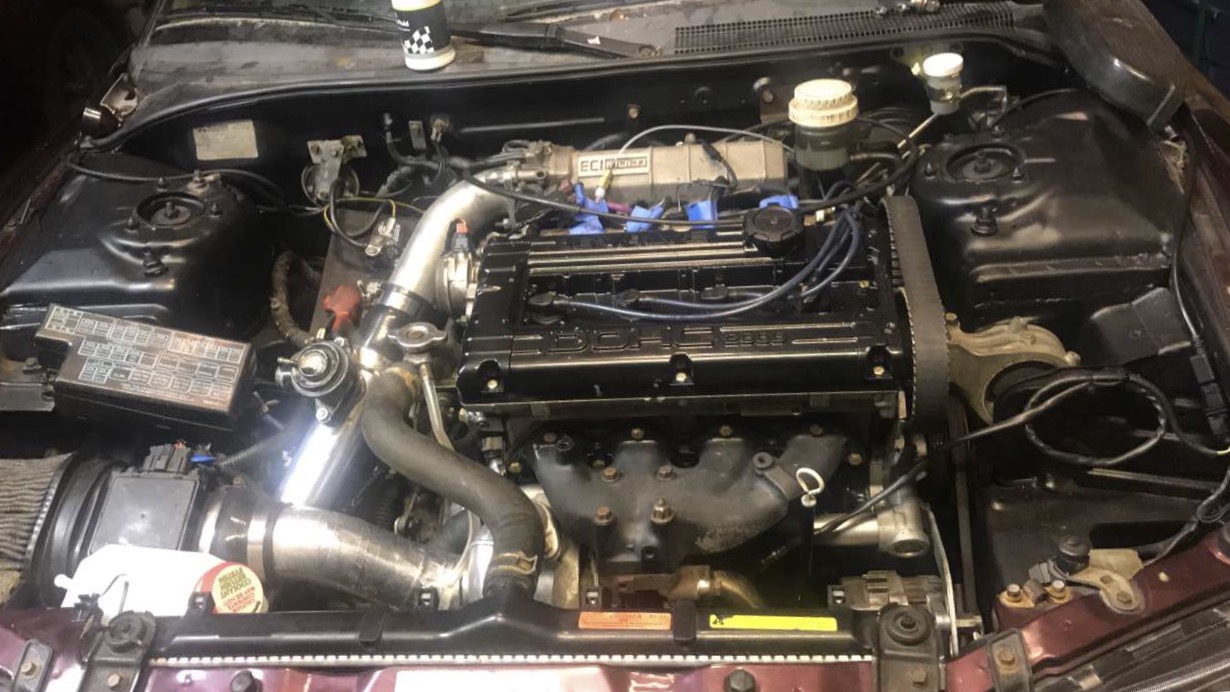

Put some fresh 93 in it and it started right up! Need to get a couple gaskets for the exhaust and put the suspension back in. Also got an axle and ac bracket. Should be driving soon

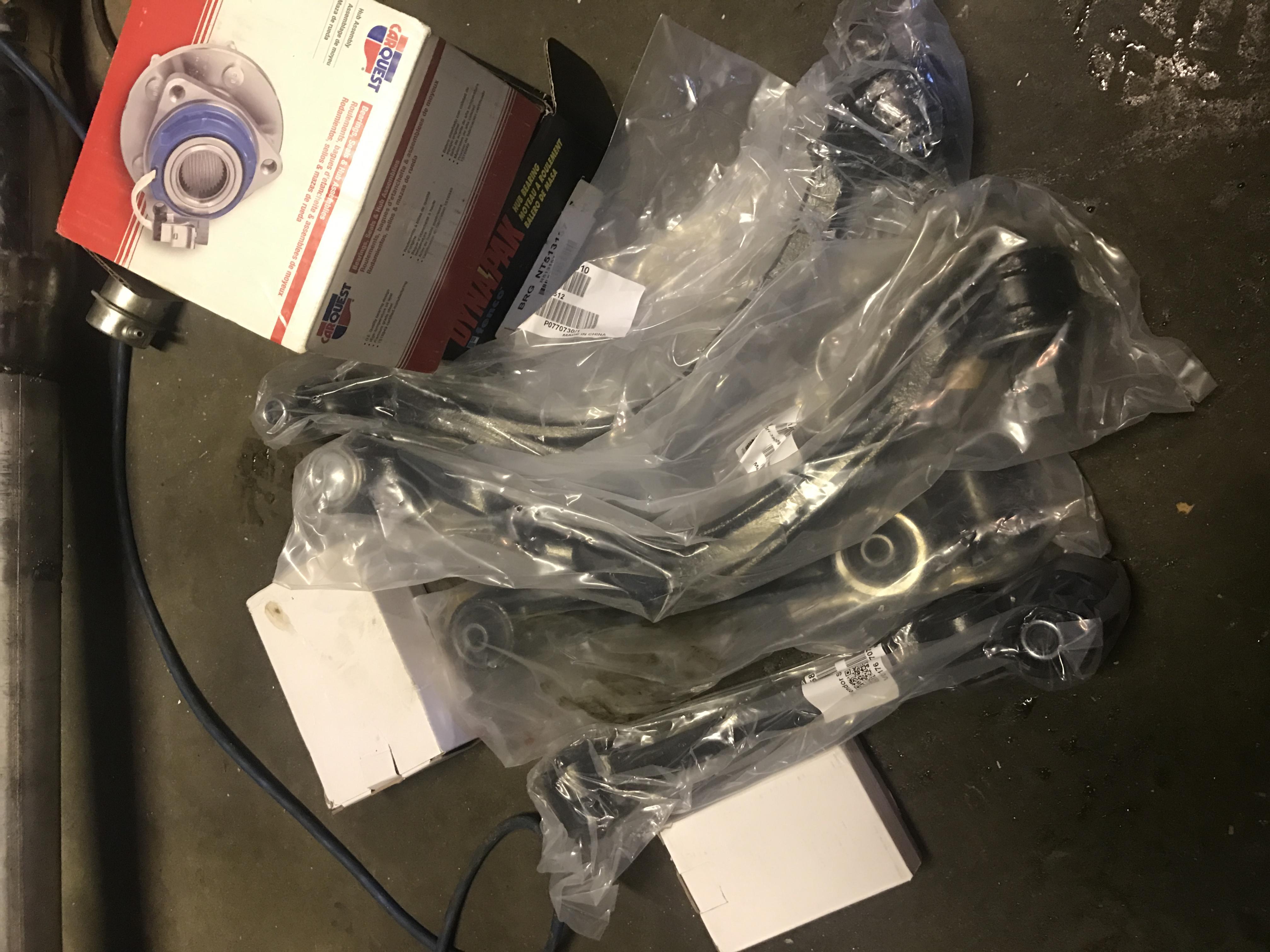

Almost everything in the front end was loose so installed new wheelbearing hub assemblies, upper control arms, both lower control arms, outer and inner tie rods, axles and sway bar links.. will be ordering link this week for it with a eprom ecu.

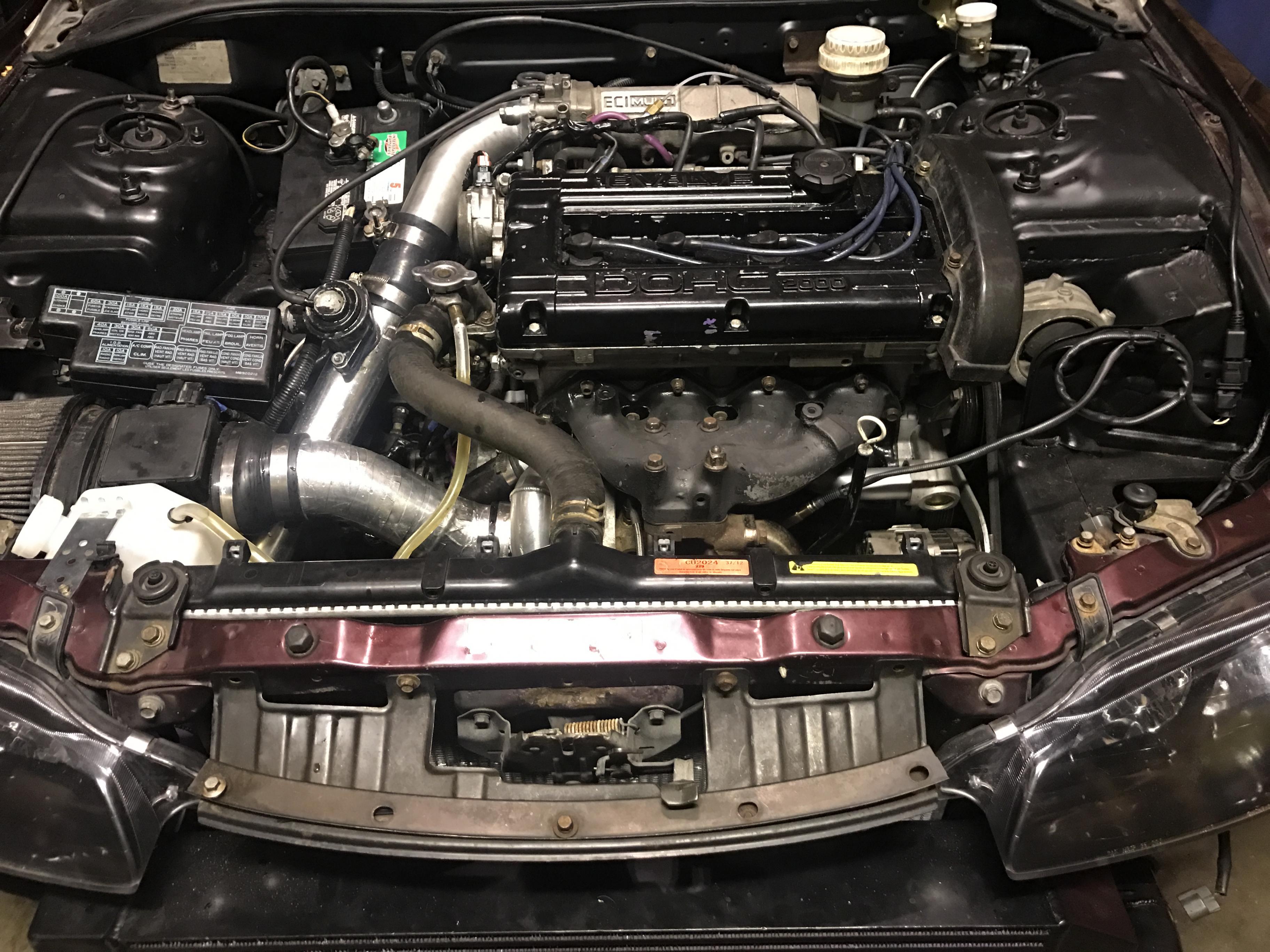

Another DSM "saved" from the previous owners hack job/ neglect. Just need to throw the front bumper and hood on then the rear seats and center console in. Going to work on the base tune tonight.
