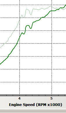

Enes's Avatar
Posts: 2,789
here is part where the turbo bites back..

ipt
Posts: 25
Have you done a compression check lately?? I was getting compressor surge and I was getting it because I had a burnt exhaust valve in the #1 cylinder. It was all pissed off.

Enes
Enes's Avatar
Posts: 2,789
I will check it tomorow night.. good point, if the exhaust can't escape it should have issues..
but then again i should have issues with making boost as well, or at least delayed..
