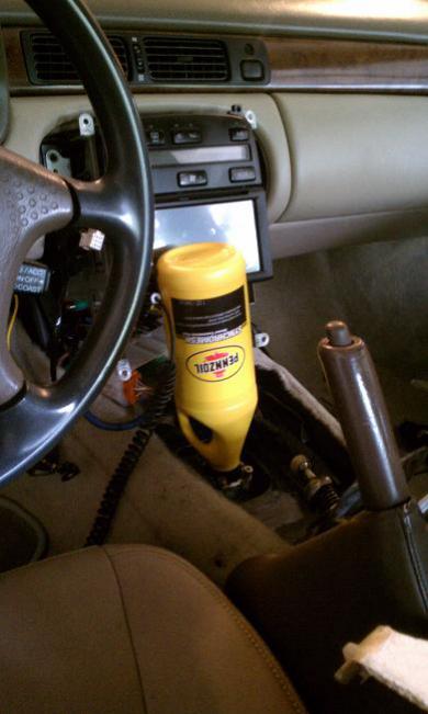

Nothin but the best for the Ol' Beanie lol.
Just trying to join the STS club (Super Tech Son)

LOL, this is my favorite picture of this thread! Is that your new short shifter? :P

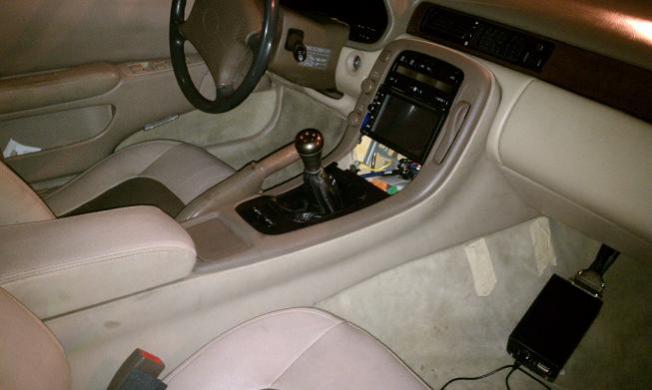

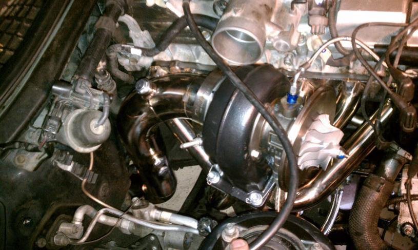

Got a little bit done today. Got the interior back buttoned up from the tranny removal/install.
Also made a little bracket to hold the oil dipstick steady since I removed the massive oem bracket that originally held it. Used some of that spare metal strapping stuff again, I'm starting to like this stuff!
Also I went to TNT and picked up a 6' length of -10AN SS Braided hose for the drain. fits over the 5/8" barbed fittings perfectly.
Thanks to Andrew, he gave me this chunk of 2.5" stainless to use on my exhaust. I still need some more bends if anyone has any laying around hit me up!!
Here is how she sits currently. I found that the turbo flange on the exhaust mani is not flat at all. Not sure exactly how to fix that, but I plan on just taking it to work and pressing it against the belt sander for a few minutes. And hopefully the gasket seals it up the rest of the way.
Other than that, I'm pretty much getting to the point where piping (IC and exhaust) is all that's left. Getting close, woohoo

Re: Project Lex
See that ground cable? Switch it so it is underneath the metal strap you put in. I did a similar thing on my X and it ended up causing a *really* bad ground. I was basically using a bracket for the starter/alternator harness inbetween another ground and the block. It looked nicer the way I had it and you do but it miiiight cause problems.

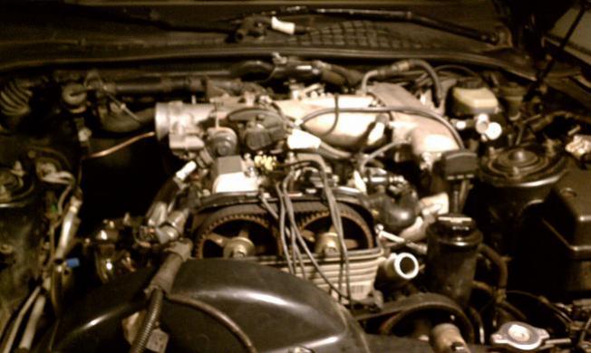

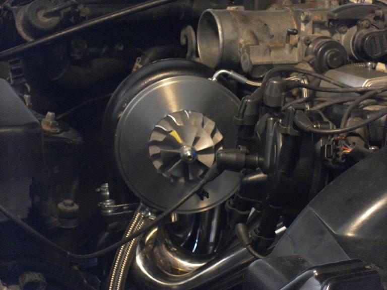

Installed the 4-Runner distributor. Only 2 of the 3 holes line up, wondering if that's normal???
Took the manifold to a sanding belt. Got the T4 flange a bit flatter. Brought it home and threw it on. Installed the turbo hot side. This should ensure the bolts don't loosen up
Put the rest of the turbo on. The return is a tight fit. The turbo will have to be clocked slightly which you'll notice. Otherwise everything is going fairly smoothly
Started w/ Turbo on No comp cover as it's out for welding. Turbo spinz!!!

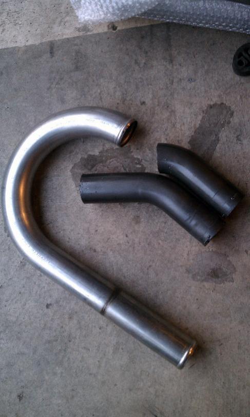

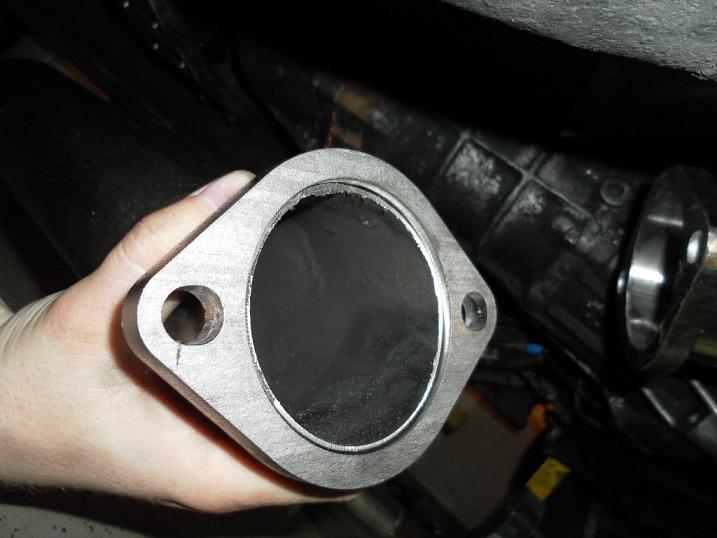

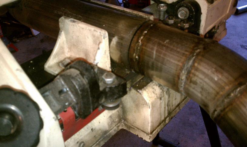

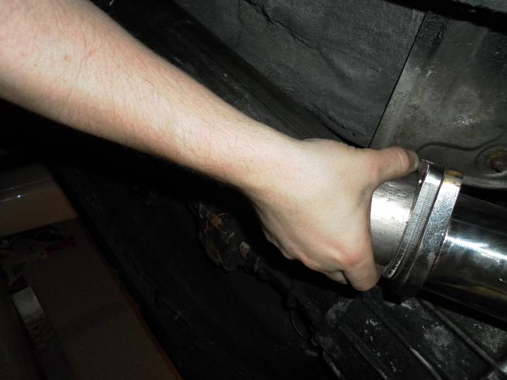

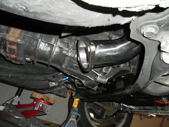

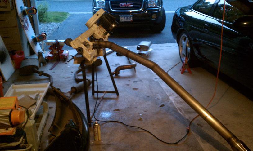

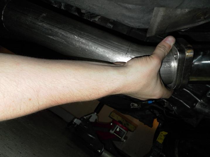

Little bit of progress. So the exhaust plan is 3" downpipe going to dual 2.5" in the rear. Got the downpipe tacked up with the Marmon Flange that mates to this turbo. Fits like a champ!
Grabbed a section of the Talon's old exhaust to start cutting it up to make the rest of the 3" portion. Grabbed a 3" flange and gasket from MAP, thanks again guys!
Here's the only piece I managed to get done tonight, but I'm glad I got it done because I suck at fabbing and I thought getting this angle just right was going to be a biatch. Took me a couple cuts and test fits to get the angle just right.
Gettin that angle juuuuust right
Done, just need to get it welded up!

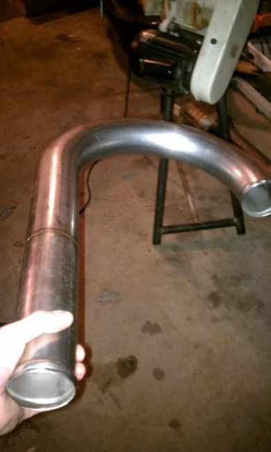

And found an old 2.5" SS Upper IC pipe from the talon that had SS bends. So I cut those off and those are added to the pile of 2.5" random SS bends to use for the 2.5" portions. They're still powdercoated, maybe I'll leave em and see how long until it burns off
Huge thanks to Momin (Speedfreak) for taking the time to weld this up for me, and Aaron for lending the equipment!

Re: Project Lex

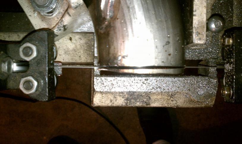

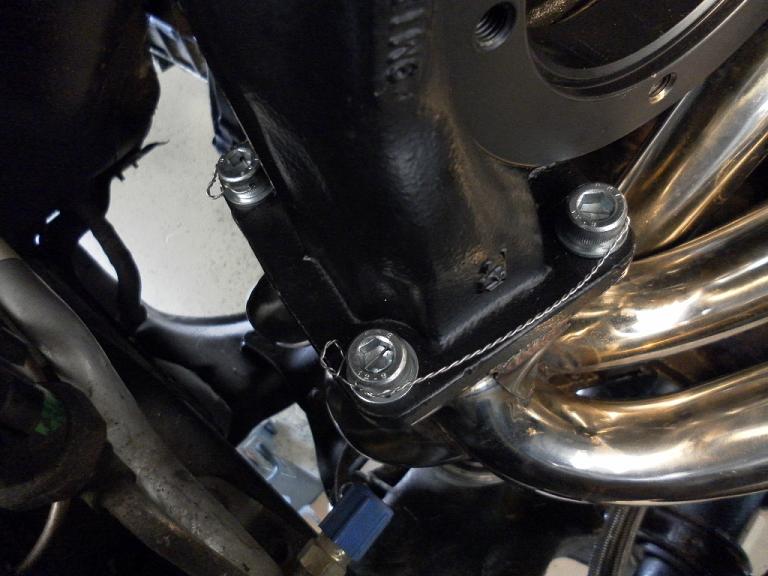

Dont mean to be a debbie downer here, but i dont think thats quite you're supposed to safety wire bolts.
I think its supposed to look like that, so that if bolt A tries to loosen it actually tightens bolt B.
I have no experience with safety wire though, so maybe you know something i dont?
07 Ducati Monster S4R
05 malaguti F15
04 E55 AMG
Old 06-08-2011   #18
Re: Project Lex
Yup, I've done my fair share of safety wiring over the past 10 years (military, and nuke plants require it). That is definately the "proper" way. But doing it that way, the safety wire was going to be rubbing on a corner of the housing, which you can see in that picture, and I wanted to avoid that because I don't want it to rub off the coating, or risk rubbing to the point that the safety wire breaks. I just don't want to look one day and see only 2 bolts barely holding the turbo up (happened to me on the Talon, and is the reason I safety wire them now). They can probably loosen a half turn, but the bolts wont fall off which is my main concern.
Old 06-08-2011   #19
Super Bleeder!!
Reynolds number user
Super Bleeder!!'s Avatar
Location: grove/tempe
Posts: 3,553
Re: Project Lex
Oh okay, that makes perfect sense actually. Sorry for being a doubter!

I agree, the bolt on the bottom of the picture with the turbo flange can come loose.
