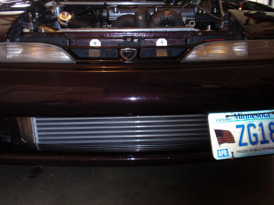

Well considering I still have my A/C condensor, and I've started to realise that I started having these issues as soon as I got that VPE FMIC, I have good reason to believe it is simply blocking too much air for me since I still have a AV condensor. So this is just one more thing I'm trying in my never ending quest to fix this issue. And I think this will fix it.
Also, I have the ETS FMIC mounted and everything back together.! But ghetto style had to use a bunch of zip ties because they place their mounting ears in a spot that isn't too friendly if you have the pop-ups, and still have AC. I'm going to see what they recommend. If I get no where with them, I'll have to just come up with something on my own.

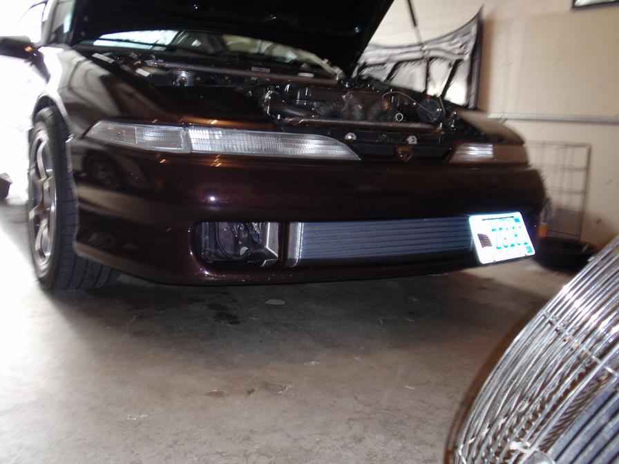

Anyhow, I drove around quite a bit today with the new FMIC. I haven't been logging, just watching the gauge, and it's already running noticably cooler. Hell tonight, the gauge was barely over that first tick mark marking the normal range! Much much cooler then before. I'm very happy about that!!!

Got the mounting situation taken care of. But FYI, anyone with pop-ups, and A/C, this won't just mount up right out of the box with where they located their mounting ears. I just took a piece of angle aluminum and bolted it the full length of the ears, then mounted it closer to the hood latch. Worked out perfect.

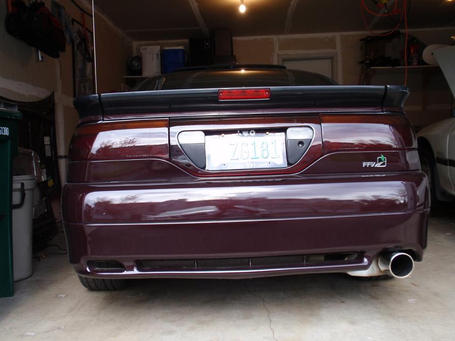

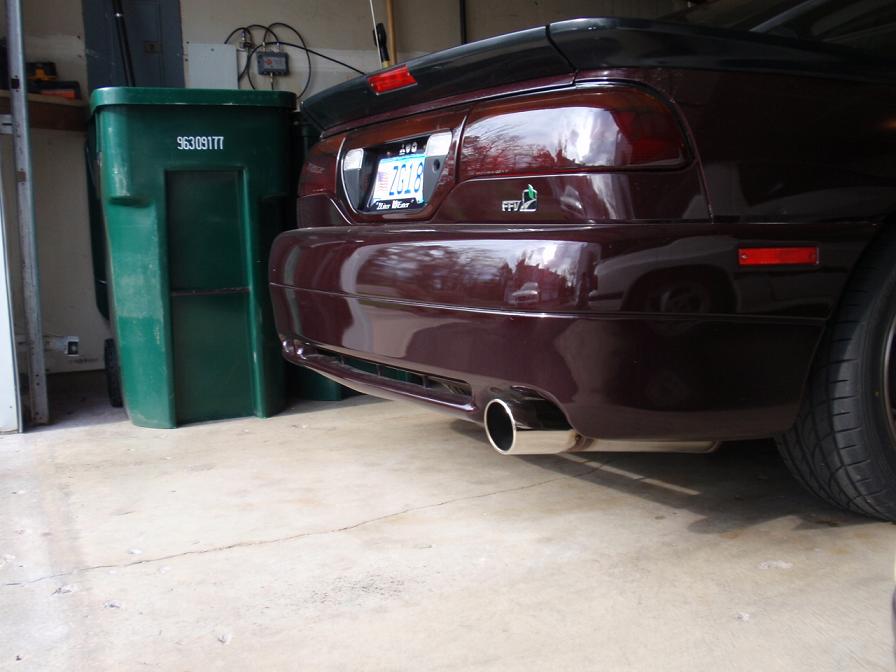

Also, another big thanks to Momin at Elite. He put the final touch on the exhaust he built me, by adding a nice little tip to it. It sticks out past the bumper just a smidge, which is exactly what I asked for, so I don't have to worry about soot on the rear bumper anymore
Changed the oil today and put a few miles on her. I think I'm ready for RF tomorrow

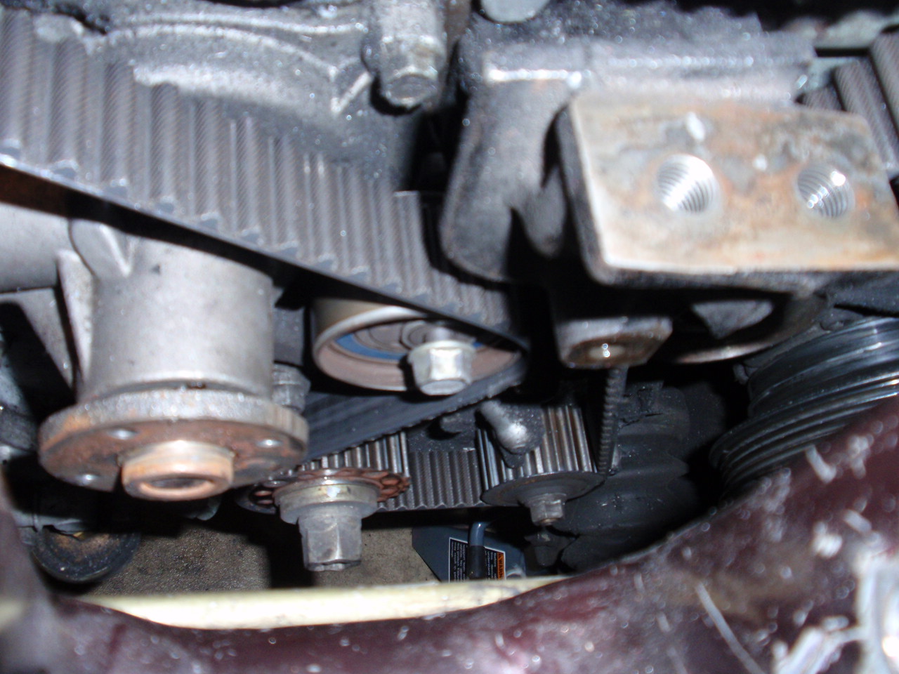

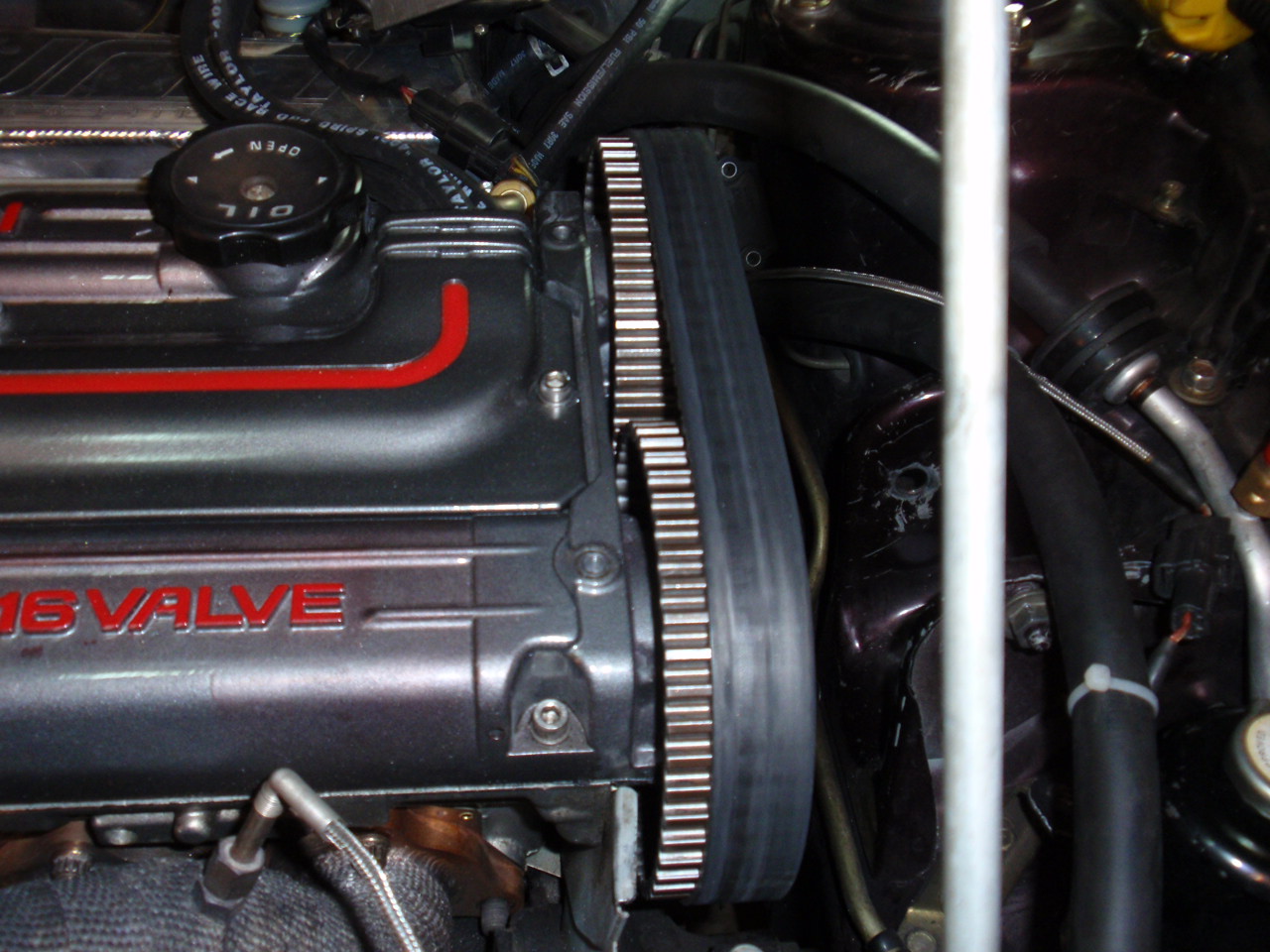

Well, today things took a funny turn. Drove it to MAP's bbq, everything was good. Later at night got to Brownman's house to do some quick pulls to make sure the car is still at where I want it to be, and right before we were gunna head out, we noticed a funny sound. Sounded like it was coming from the cam gear cover.
Here's what we found.
Drove her home nice and easy, and a couple hours later had it all buttoned up. The timing belt itself needs to be changed, which will happen in a couple weeks when I redo the headgasket, and put the L19's in. But for now, T-Belt should still last a good while as is.
So needless to say, we never got to do any pulls, so that'll be something to do on the way to the track
Close call though, man am I glad we found that tonight, and not in Wisconsin.
And big thanks to Brownman for sticking around and helping me get this resolved!!
