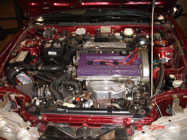

Fixed, runs better it seems like!
Wooo! It was a pretty epic HG blow out

Update:
Car was repaired, and at the MitsuStyle Fall Dyno Day, it made:
556awhp/459awhtq @ 37psi. E85.
Stock 2.0L 4G63 Shortblock
Felpro PermaTorque
MAP H11 Headstuds
Holset HX40 w/ .55 A/R Bolt-on Housing
FIC Bluemax 1650ccs
Walbro 255HP Rewired
