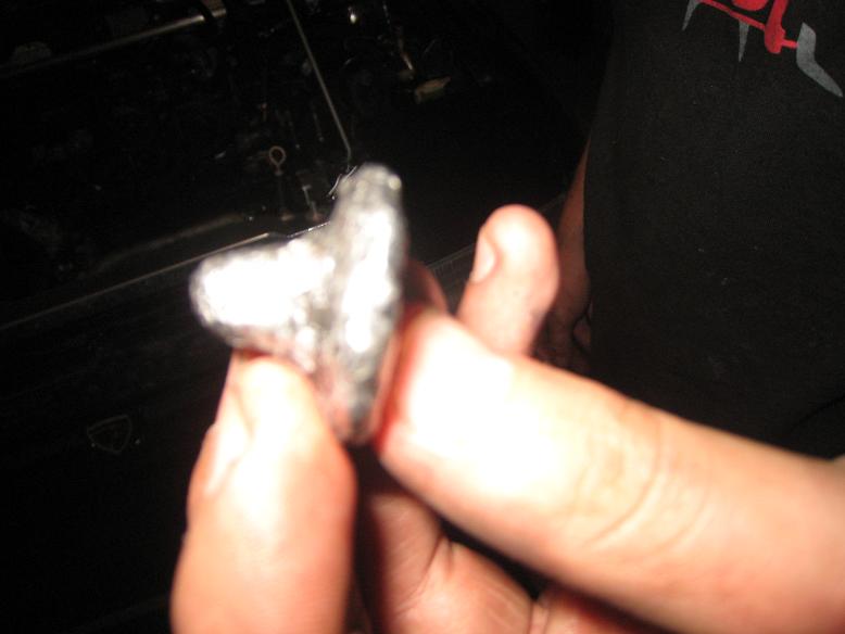

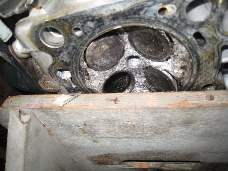

But I just got the head off. Thanks for the quick help Andrew
I think this may be a bigger tragedy then Romeo & Juliet...

Good news is that I don't think the block is trashed. The cylinder walls looked had no large gouges or anything of that sort. I'll be spending some time this week on the car, and removing the oil pan, and the rod/piston from that cylinder. Then I'll try to clean out that cylinder as best as I can, and get a better look at what condition that cylinder is in.
The head is screwed though, so if anyone has one laying around, let me know. I'll be reusing the Crower springs/retainers from this head, the cams, the rockers, and the 3g HLA's. The rest is just worth it's weight in aluminum I think.

Right now, nothing. The TB is fine, the cams still look good, everything under the Valve Cover looked good except for the busted rocker (which must have busted due to the valve in the cylinder). No idea what caused the valve to fall into the cylinder. I'm still trying to understand why my tach stopped, and if that has anything to do with anything here. Did maybe that injector die or it's clogged, caused it to run lean, and voila? I will be hooking the injectors up to a battery to test and make sure they all still function, and will clean them with some carb cleaner.
