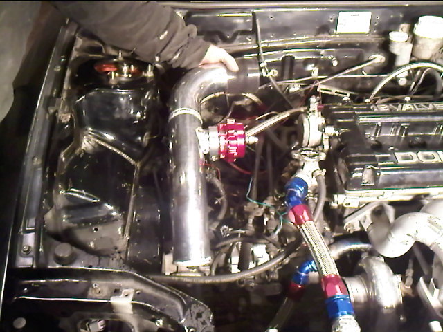

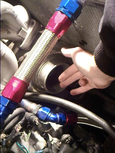

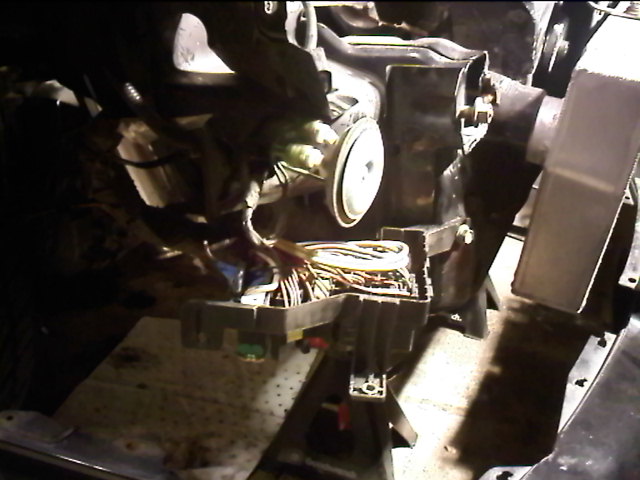

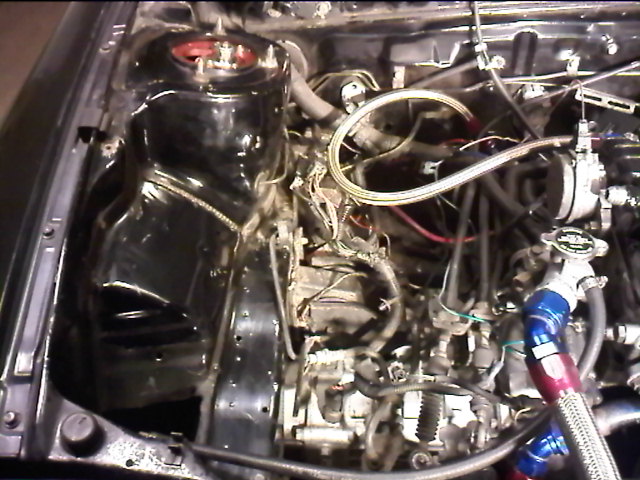

More pics. Upper pipe is done, and made. Got the 90 TPS to mod for the q45 tb (thanks Mark!) lower ic pipe is mocked and getting welded up, fuse box is relocated to the inner fender, and wiring has begun. Tomorrow, we are tackling the firewall and those wires. I'm still looking at maybe filling in unused holes, and spraying black again to make it look a bit better..

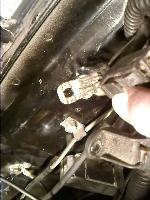

As the title states, we found more shit wrong..something rather major actually. Turns out the revving issue I had, COULD be very well attributed to a BAD GROUND-more-so, one that was NEVER BOLTED DOWN!! I dunno if it was whom I baught the car from, or when I had it apart before( I forget ever even seeing this tab) but this is what it looked like :
In the spare harness we used, and cut it out (relocating the MSD to the inside, and etc) this shows what all that ground is for, amongst other things:

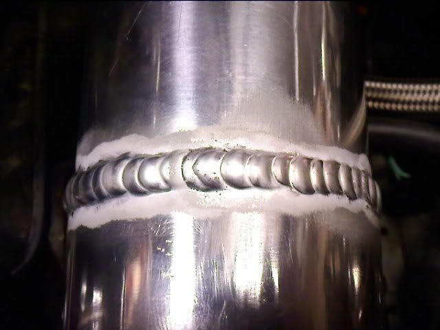

Now that that issue has been sorted out, it will FOR SURE be grounded now. The upper and lower pipes are done, BOV and AIT is on, TB is modified for the 90 dsm TPS (thanks Mark for the sensor!) injectors are in (thanks Andrew!) timing belt is done, FJO is moved over to the back far corner, intake on for mock up, and figuring out vac lines, etc.
Progress pics as of now..
JAKEY, I know you like weld X-rays:

Whenever I see that picture it makes me think of Transformers...anyways, the car does look A LOT cleaner with all the wiring gone.

The #3 engine bay ground is an important thing to have hooked up. This is a ground for the CAS, Coils, Transistor, and another ECU ground.
~John

Goddamn I love wire tucks.

Actually another one too: how do you keep moisture/condensation out of that upside down fuse box in the fender? Does it get sealed up at all or just x fingers and hope it doesn't break?

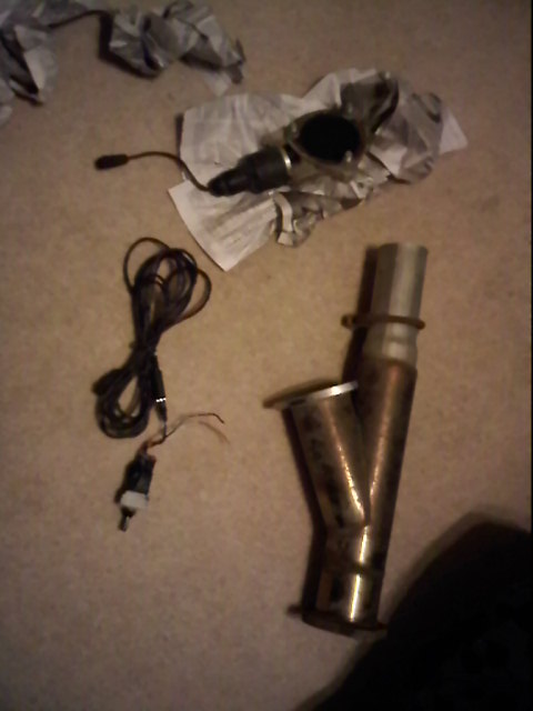

the QTP is not on the car yet, still gotta figure that schtuff out. There isn't much room that it will fit well, and have ground clearance. I won't drive everywhere with it off, but I am gonna test how it effects spool-up. If it's not a HUGE difference I may just take it off and sell it. Afterall, this is still a street car, so I have my ipod, heat, wipers, etc.
Fuse box is getting a metal plate that will seal off the bottom (now top) part of it. it will also have the stock lid covering things on the bottom. There shouldn't be too much moisture in there, as I don't think i'd be driving it on rainy days, but then again, we all can get caught out in this MN weather.

Ok, just don't set it up so water can run in there and pool and just sit on open wires/fuses. I hope you saw what happened to my evo, and that's in a stock location

Yea, i was the one saying i'd crimp those for ya? lol The metal cover should fit firther around the fuse box, and then John is gonna figure out how to hold it in place.

I didn't noticed you moved the fuse box. Did you put it in the stock sidemount location? That's where mine is and it's upside down. All I did was wrap the bottom (now top) with electrical tape. I should probably make a plate for it like you.

yea pretty much stock side mount location. then ran new wires and made new grounds for stuff too. i may tackle some more wiring tpnight but we will see.

well, I've decided to sell the QTP setup, as it won't really yield me THAT much, and I could use the money towards something better like...tuning.
