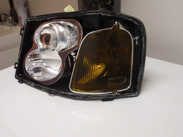

But, update time!!!

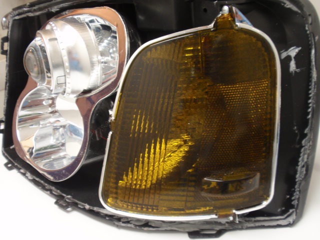

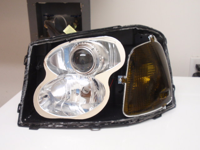

Got the projectors in the mail today. I was really hoping they were going to just fit right in without modification as that's what these projectors are meant to do. Problem is the size of the projector, and the size/shape of my OEM reflector bowl. They don't perfectly work together so some modification was required. I decided I wanted to try and keep the housing as unmodified as possible. I did have to grind away a very small spot, but it's somewhere that'll never be visible so no biggie. Had to cut away a couple spots on the projector bezel, or whatever the name is for the decorative outside piece. It was hitting the OEM housing in a couple spots, which is why I had to modify them. But I think those couple little mods pretty much took care of it all. I only did 1 for now, will do the other one someday soon. I don't think I'm going to completely seal the headlights back up though until maybe April which is when I'll be back home and will have the Balast kit.
Also I'll mention these came with some Halo Angle eye thingies that I snipped the wires on and removed. They were in the way, and cheesy anyway so you'll notice that is removed.

I should mention, that these are the G3 projectors. I think Primo has some of the G1 projectors. The G1's I'm sure would have fit without a problem as they are much smaller. But the G3's have a little better light output so that's why I went with them. But I have a feeling even the G1's weaker light output, is still probably quite a bit better than most OEM halogen setups. I still wonder if maybe I should have just gotten the G1's, but oh well.

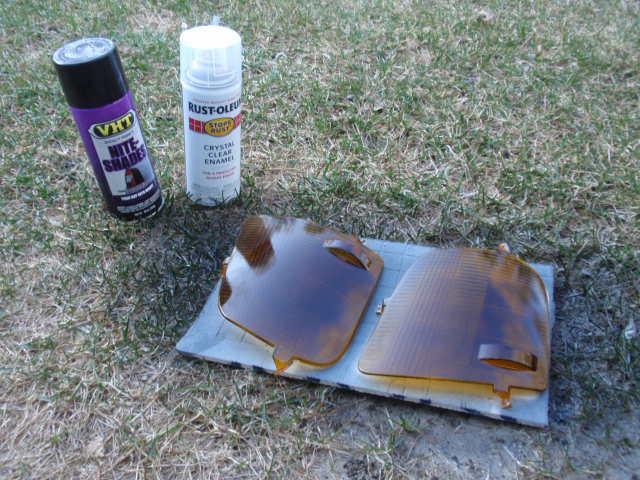

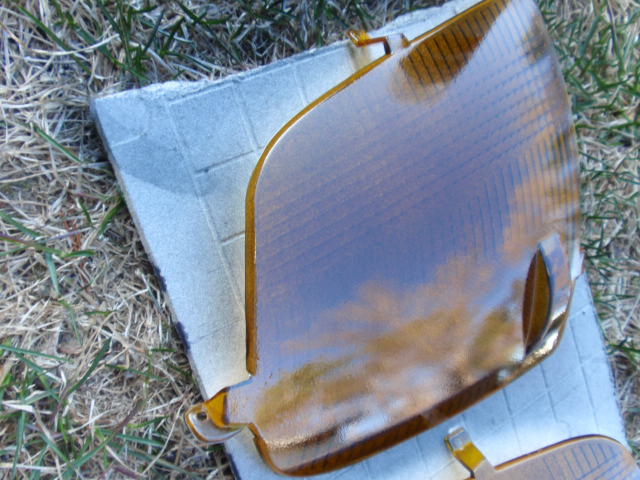

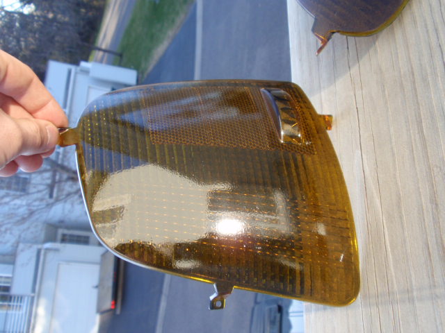

Just did a light 3 coats of niteshade on the orange reflector pieces that go in the headlight housings. And 2 coats of clear. I didn't wetsand or anything since they're going to be inside a headlight housing. Figured not worth it. The goal here wasn't to black them out, but to just give them a darker orange look. Turned out exactly how I wanted for the most part

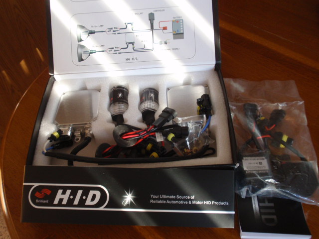

Also got my HID kit and DRL killers from Primo!

OK well got them to work. One of the ballasts is dead, so I could only play with one side at a time.
