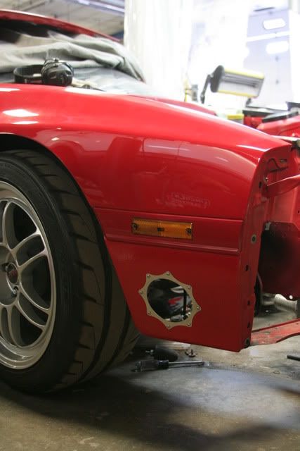

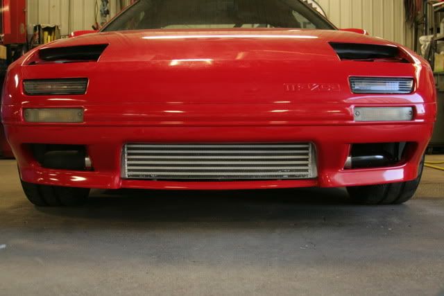

I was trimming the bumper for my FMIC and thought I might as well throw the hood, fenders, and headlights on (not bolted down or anything).

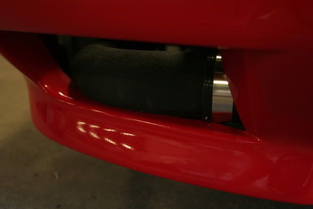

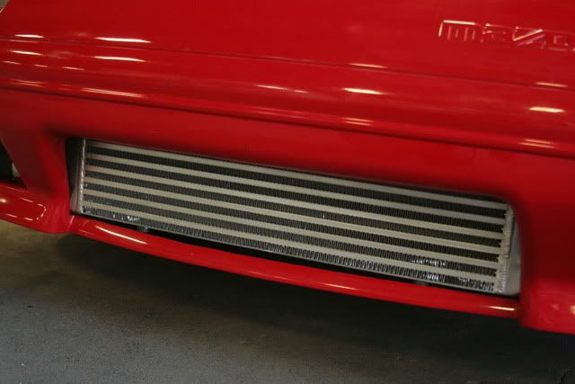

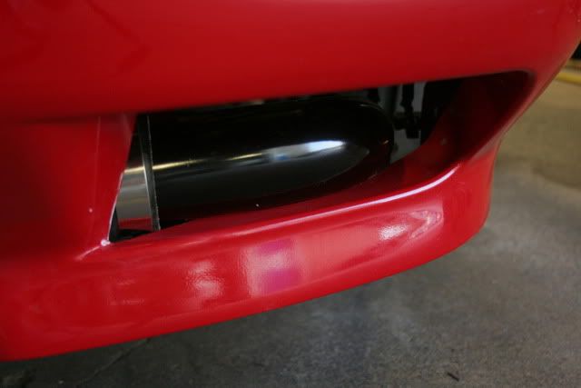

The only cool stuff I got done this weekend was I washed the car and trimmed the front bumper. I HATE when you see a nice looking car with the FMIC but then you get up close and the bumper is all hacked to shit. Not my style. It turns out that the material the bumper is made out of is so soft you can cut it with a razor blade... so that's just what I did. I probably have 2-3 hours into trimming it.
It's trimmed to contour with the shape of the IC tubing. You can see on the passenger side the finish of the tubing with the wrinkle coat. I haven't had a chance to do the coldside yet.

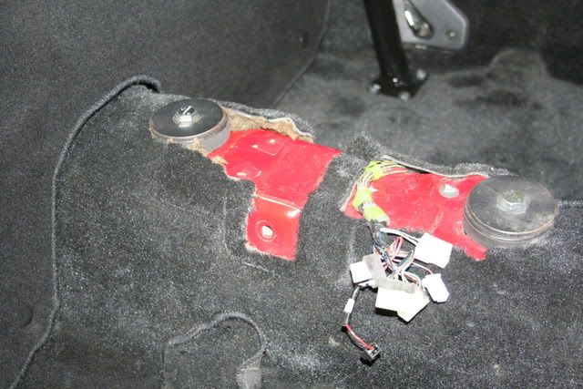

These are the front and rear Granny's torque arm mounts:

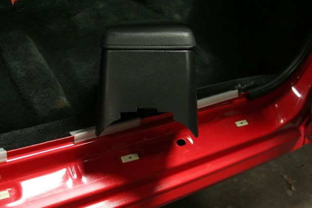

The rear mount requires trimming the carpet a little and also the center console:

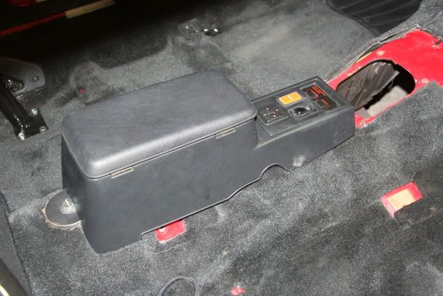

Here's the center console resting in place:

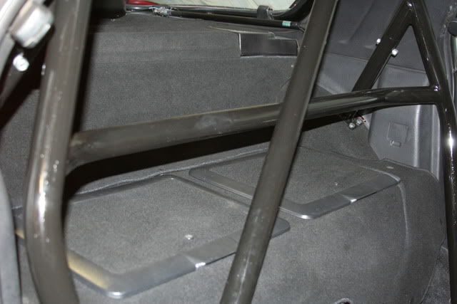

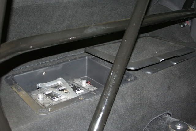

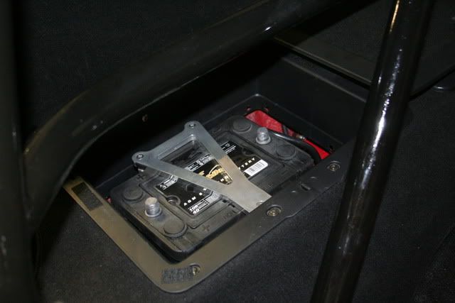

One problem I noticed (after bolting the roll bar in, of course) is that I can't open up the rear bins all of the way anymore.
This isn't really a problem on the driver's side since I can still fit shit in there, but charging the battery would be a bitch. So, I removed the hinges and put velcro in place. It looks good and is super functional - and you can't even tell there's velcro there at all. I tried magnets for a super clean look but couldn't get anything to hold in place. Maybe sometime later if it ends up bugging me that much!
AGM battery solidly mounted with 3/8" diameter bolts through the floor:

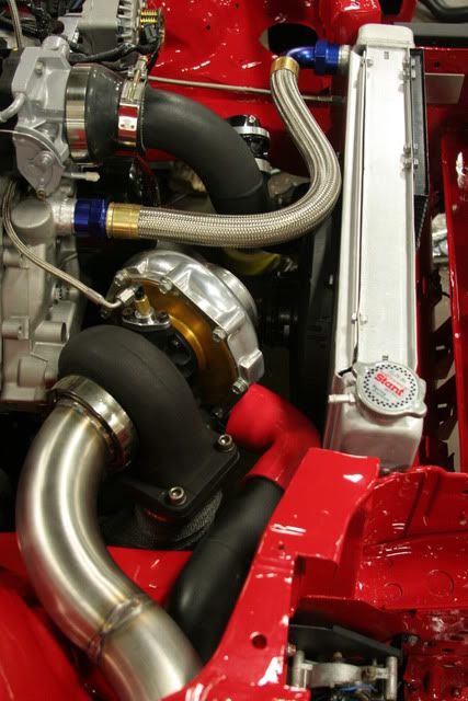

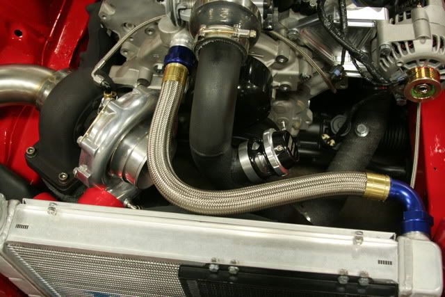

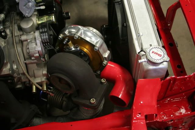

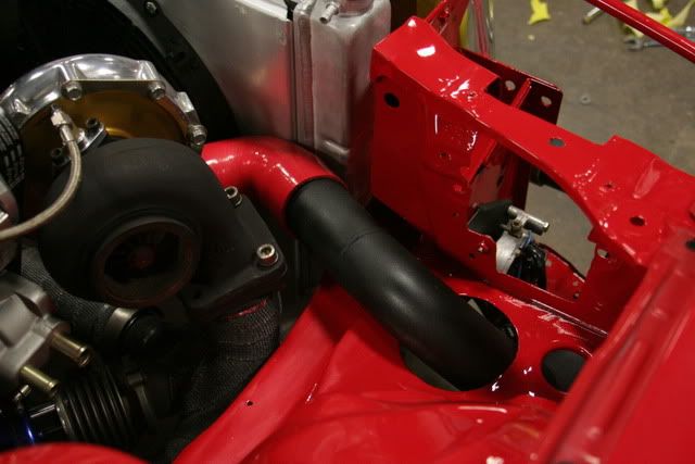

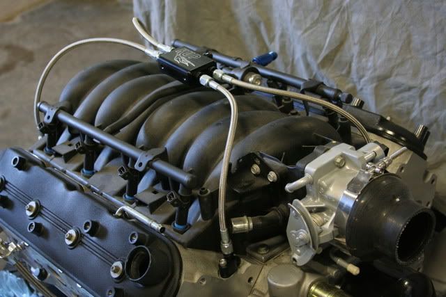

Finished cleaning up all of the turbo stuff:
Installed Kurt Urban LS water vapor system (helps keep cylinder 7 cool):

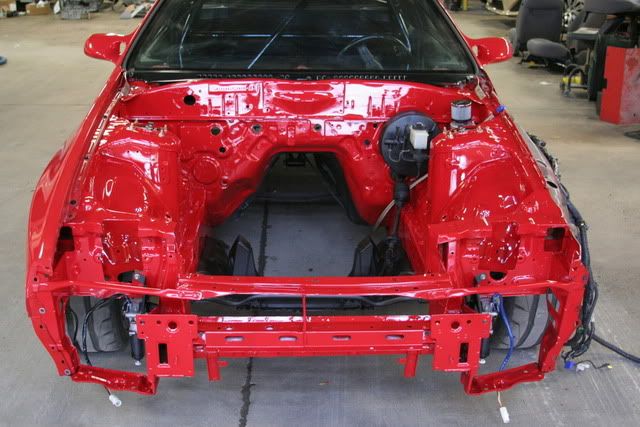

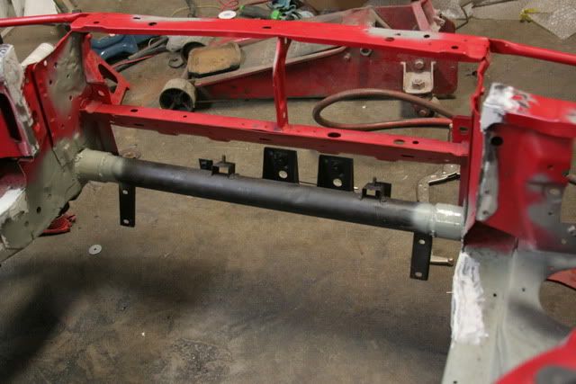

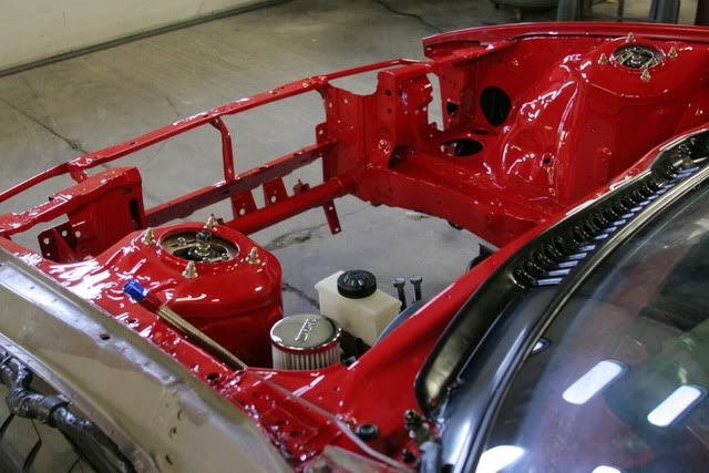

Moved the rad support about 6" forward. Now that's done, I can paint the bay this week:

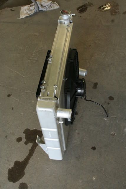

Trans cooler mounted to the radiator. I'm green to automatics so I don't know if this will cool enough or not. I'll just need to wait and see.

That cooler should do just fine on the hwy, your issue will be at the track if anything. You might want to remote mount it so you can have a fan. But maybe your cooling fan will be enough too.

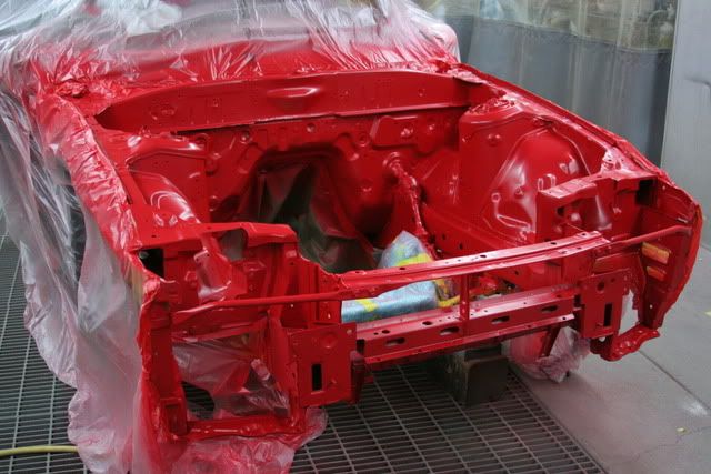

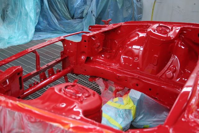

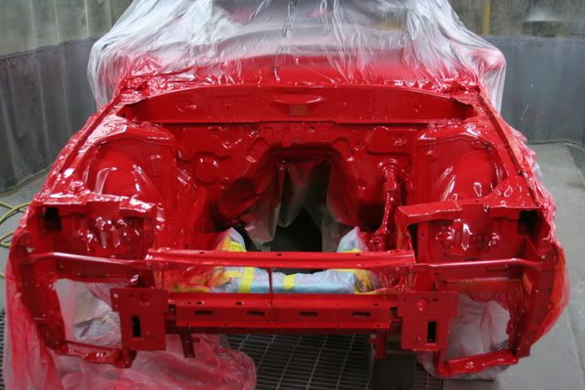

I painted the engine bay a couple of weeks ago:
Before:
During:
After:

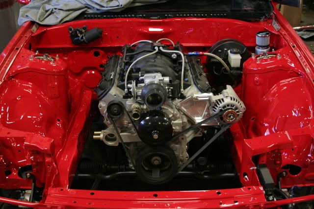

started getting the bay prepped for the motor and trans:

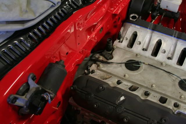

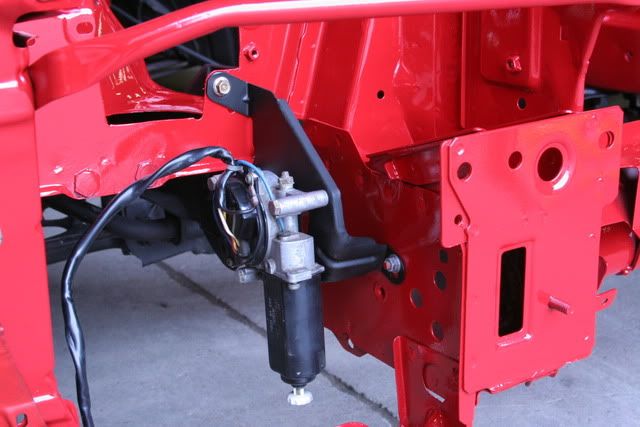

Cleaned up and mounted both headlight motors:

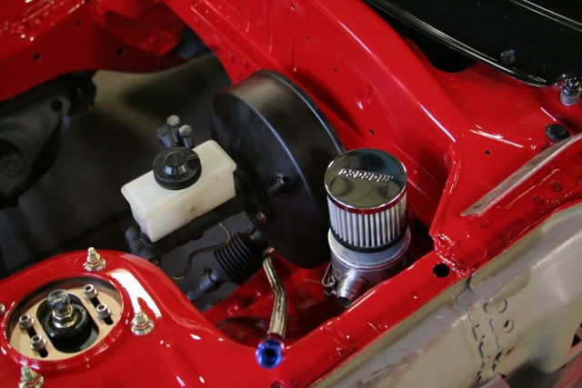

Mounted brake booster and catch can:
View from the back to the front:

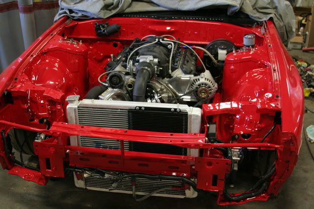

And an overview:

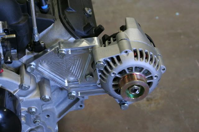

I also got my alternator bracket mounted:

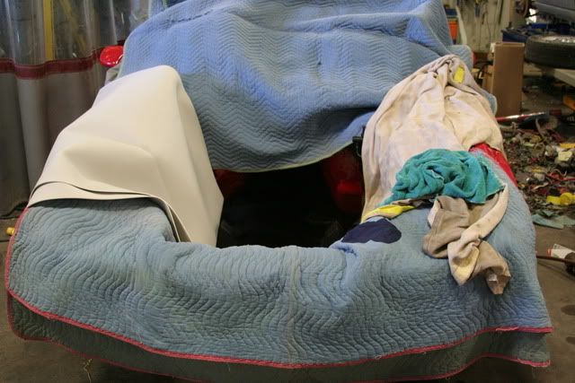

Since I was installing the engine/tranny by myself, lots of covering was necessary

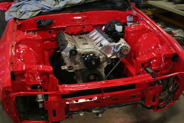

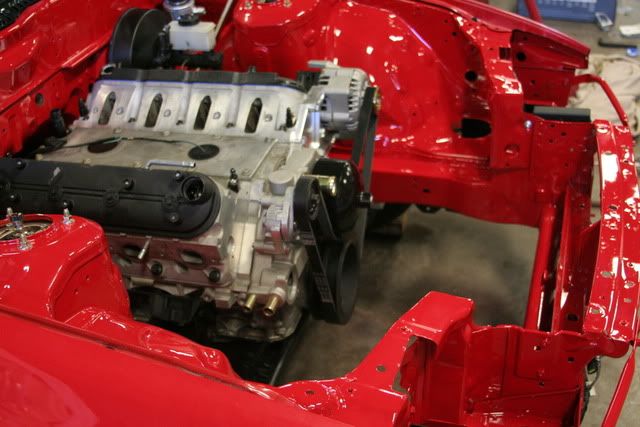

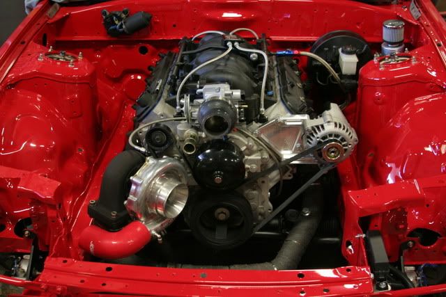

Engine in and bolted down (trans is still resting on a jack as I have to move the mount ~6" forward):
Space with the relocated radiator support:
Space behind the motor... about 1-1.5"... perfect...
Intake installed:

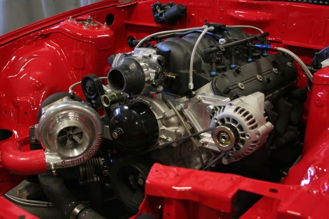

Headers/turbo installed:

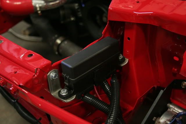

Relocated fusebox:
VERY tight fit... but it will be nice and snug:
Front view. Note the tranny cooler lines... they ended up being the perfect length.
IC tubing installed:
IC installed:
