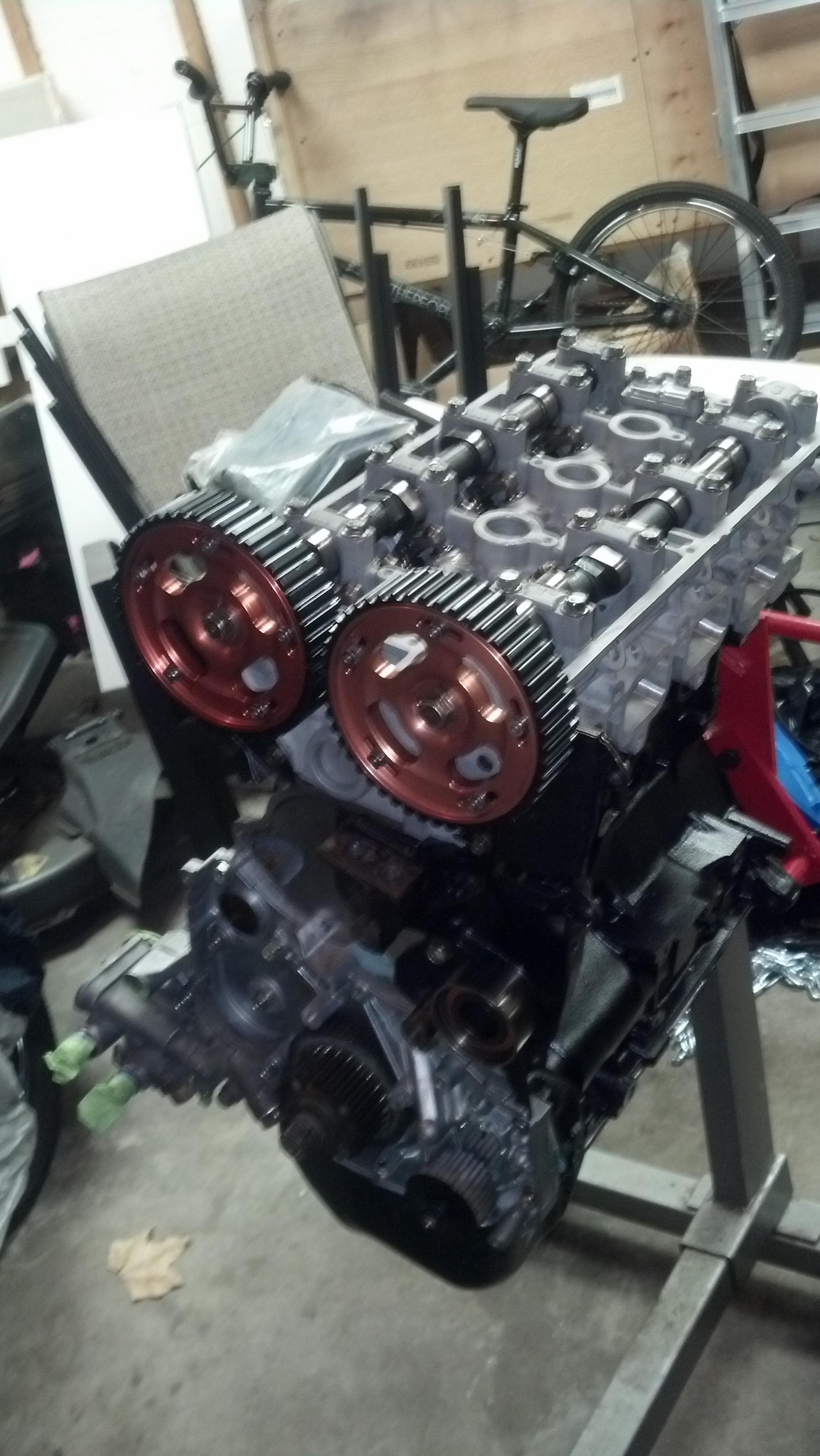

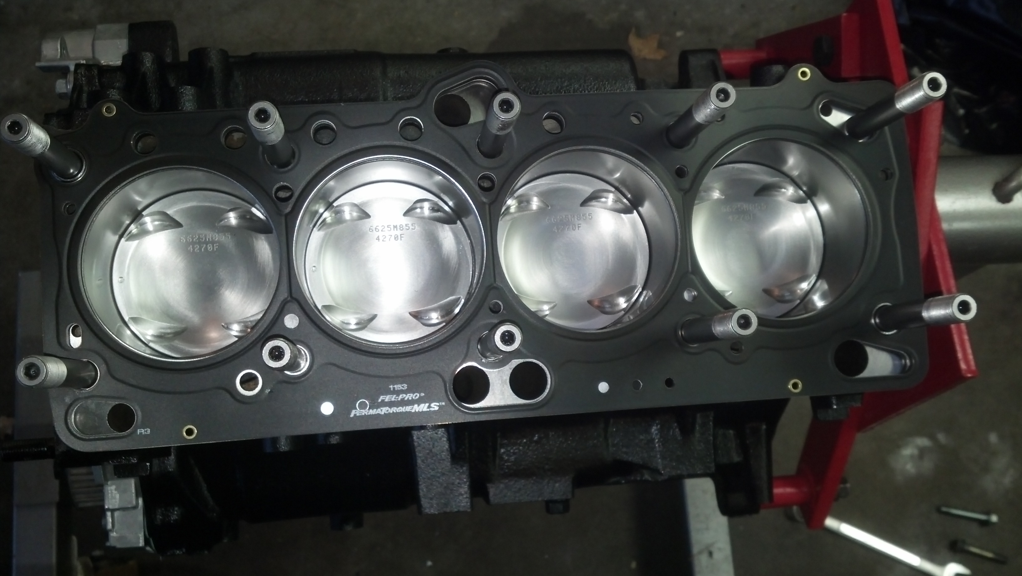

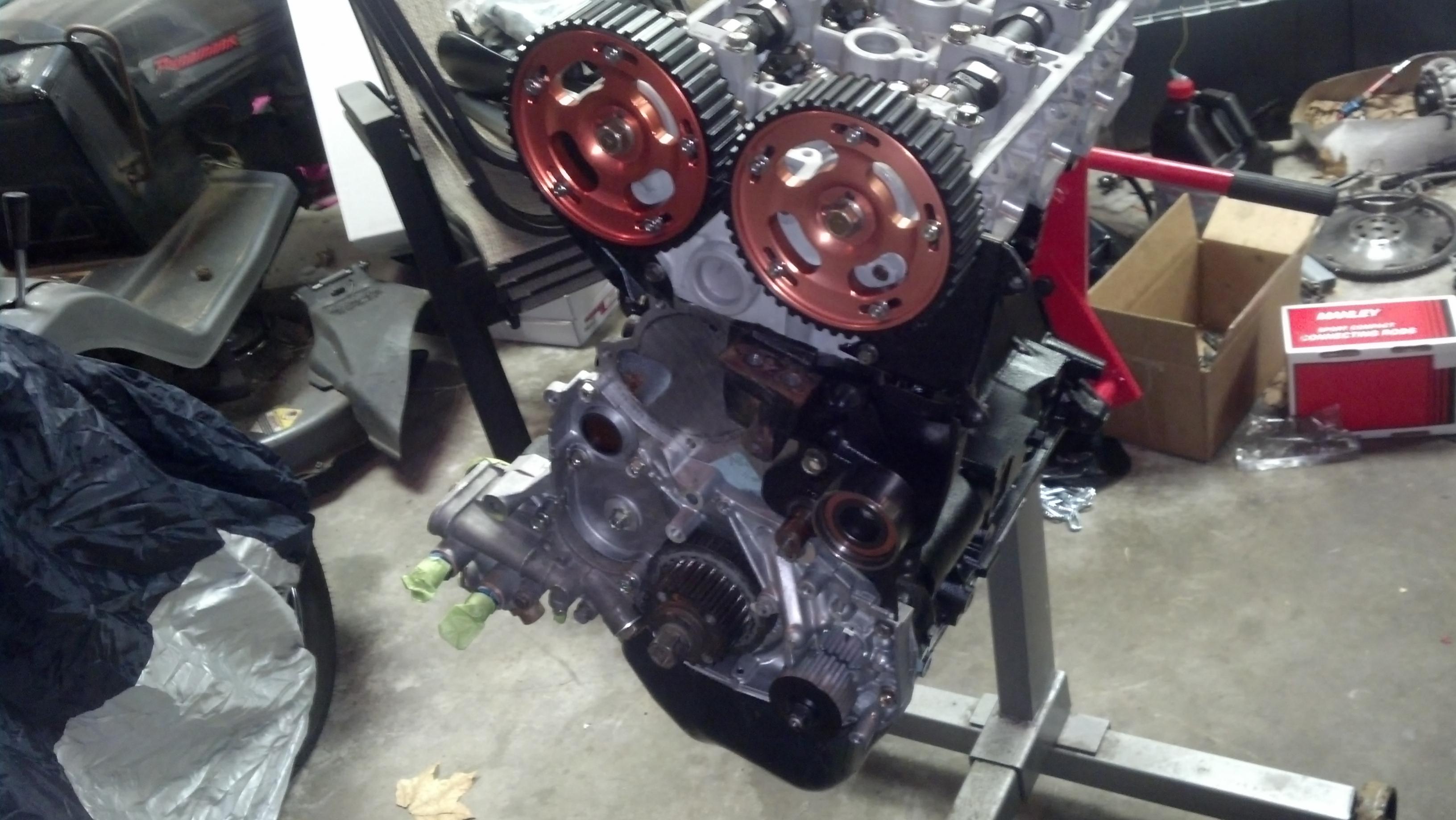

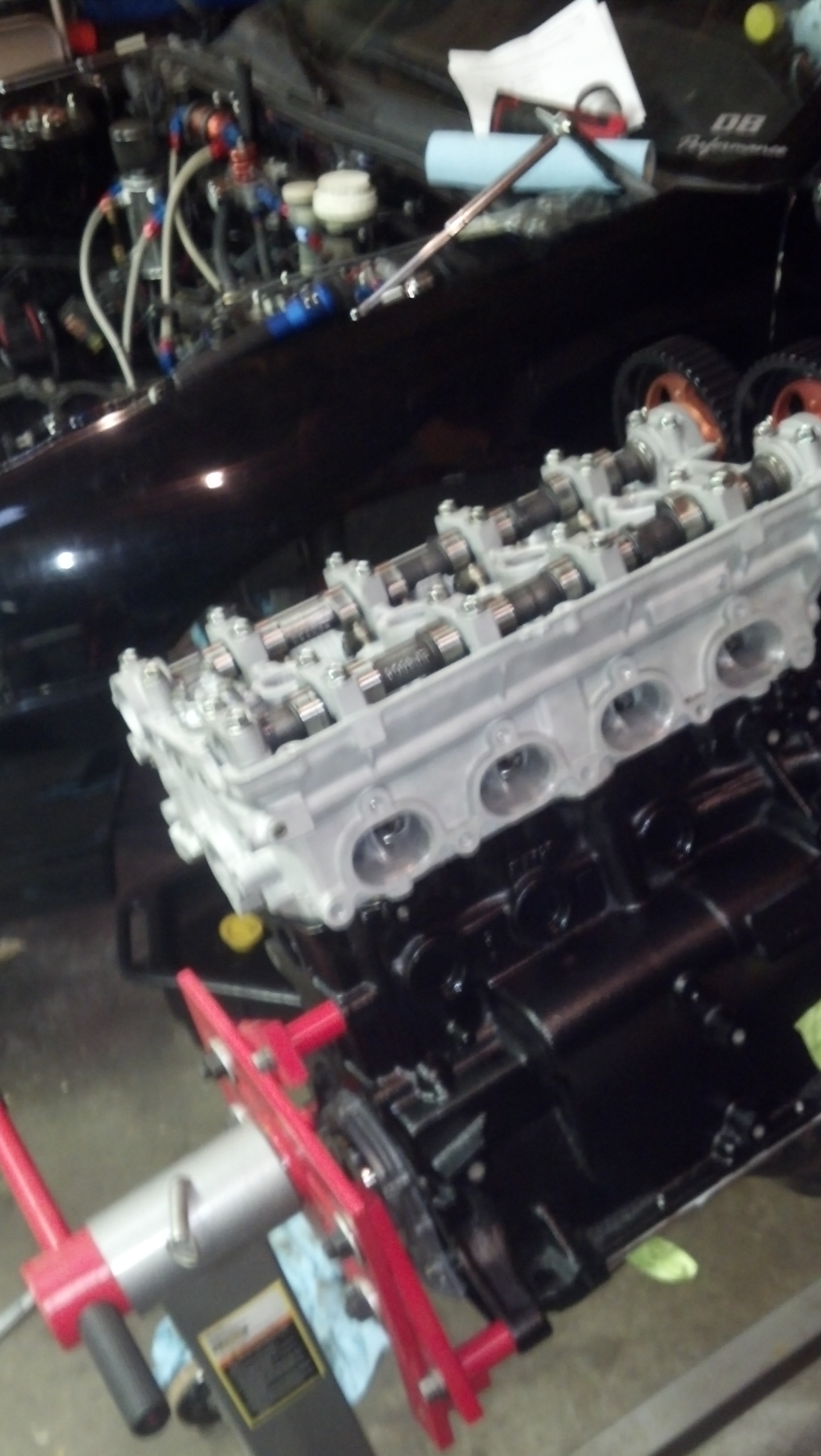

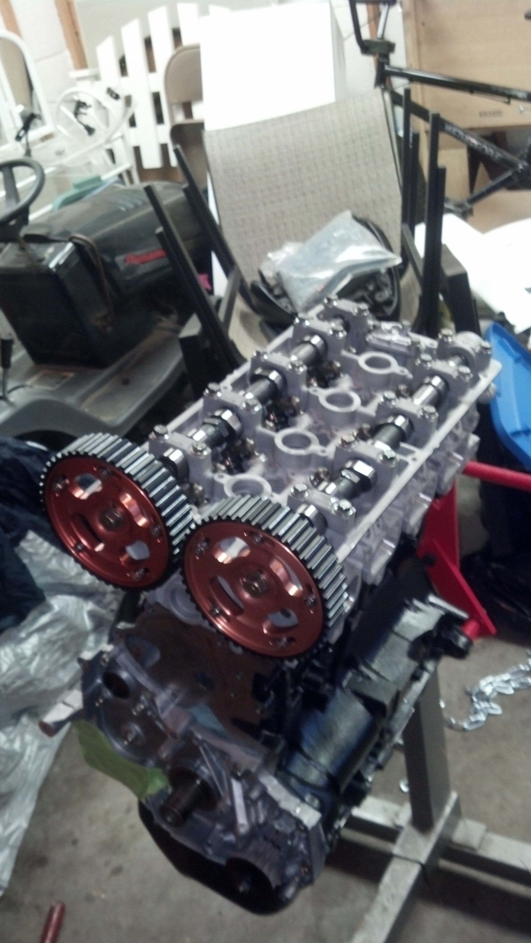

Well I got a little work done today.
ID:	13149   Click image for larger version
ID:	13150   Click image for larger version

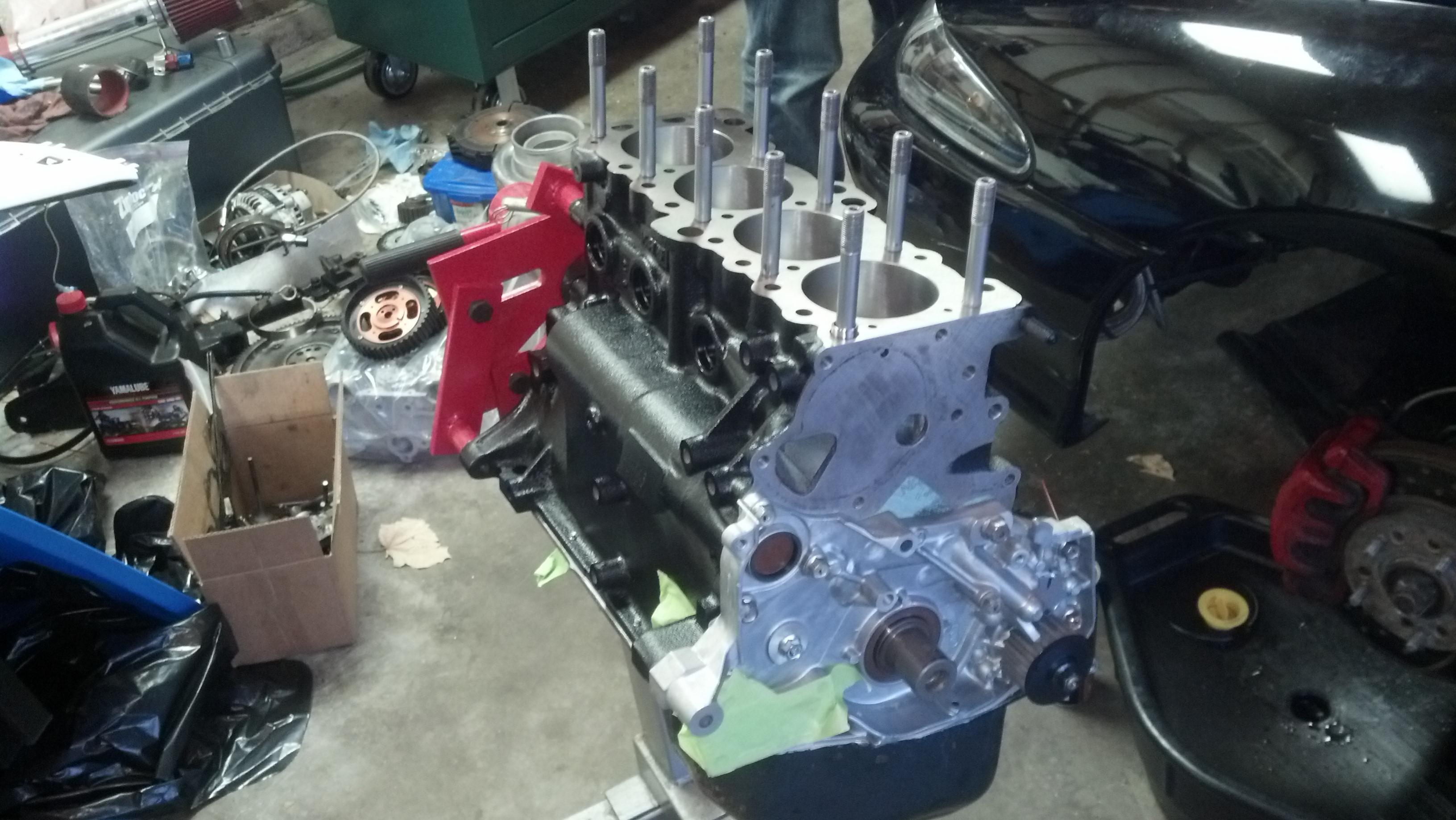

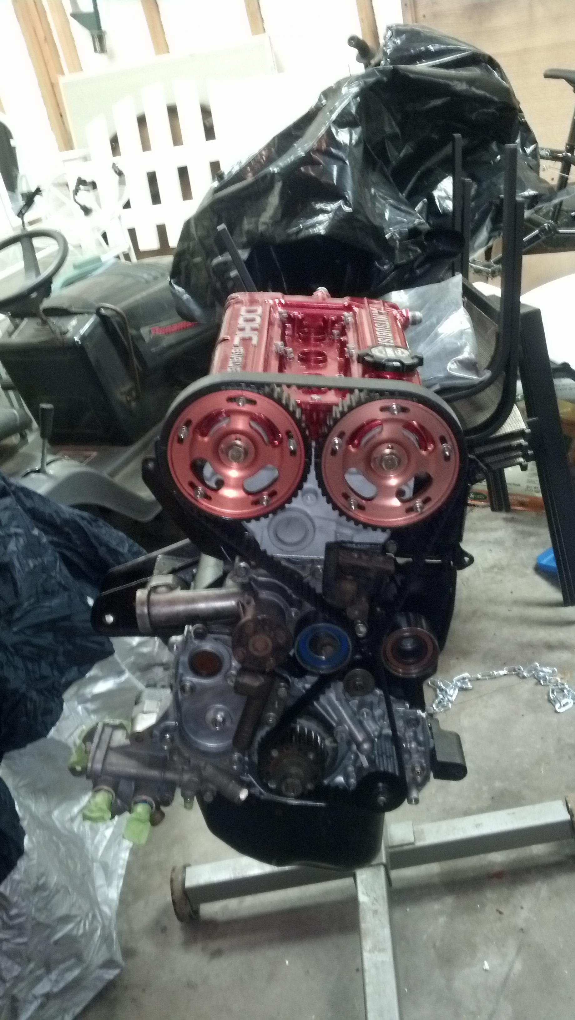

Some more pics
ID:	13153   Click image for larger version
ID:	13154   Click image for larger version

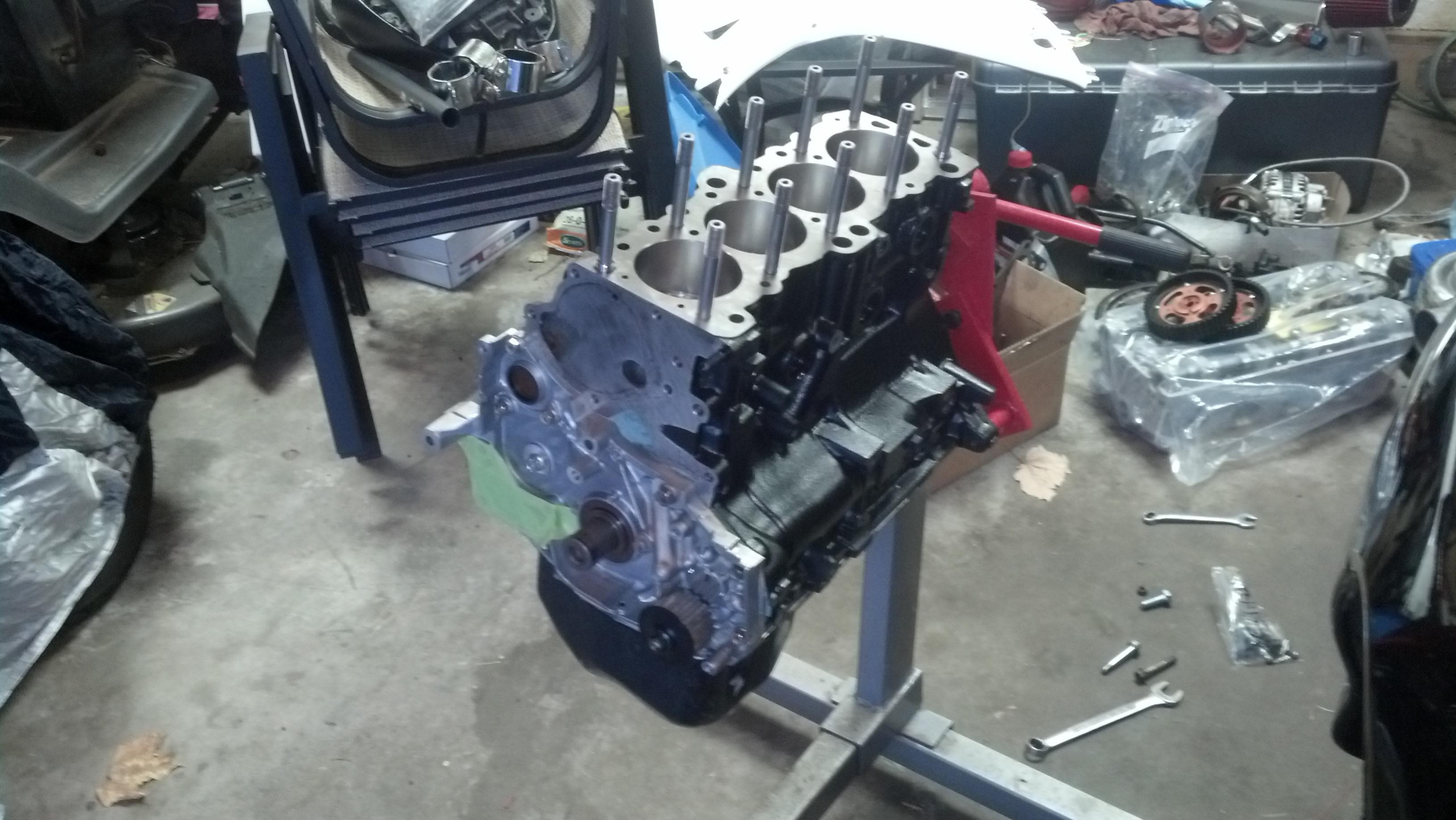

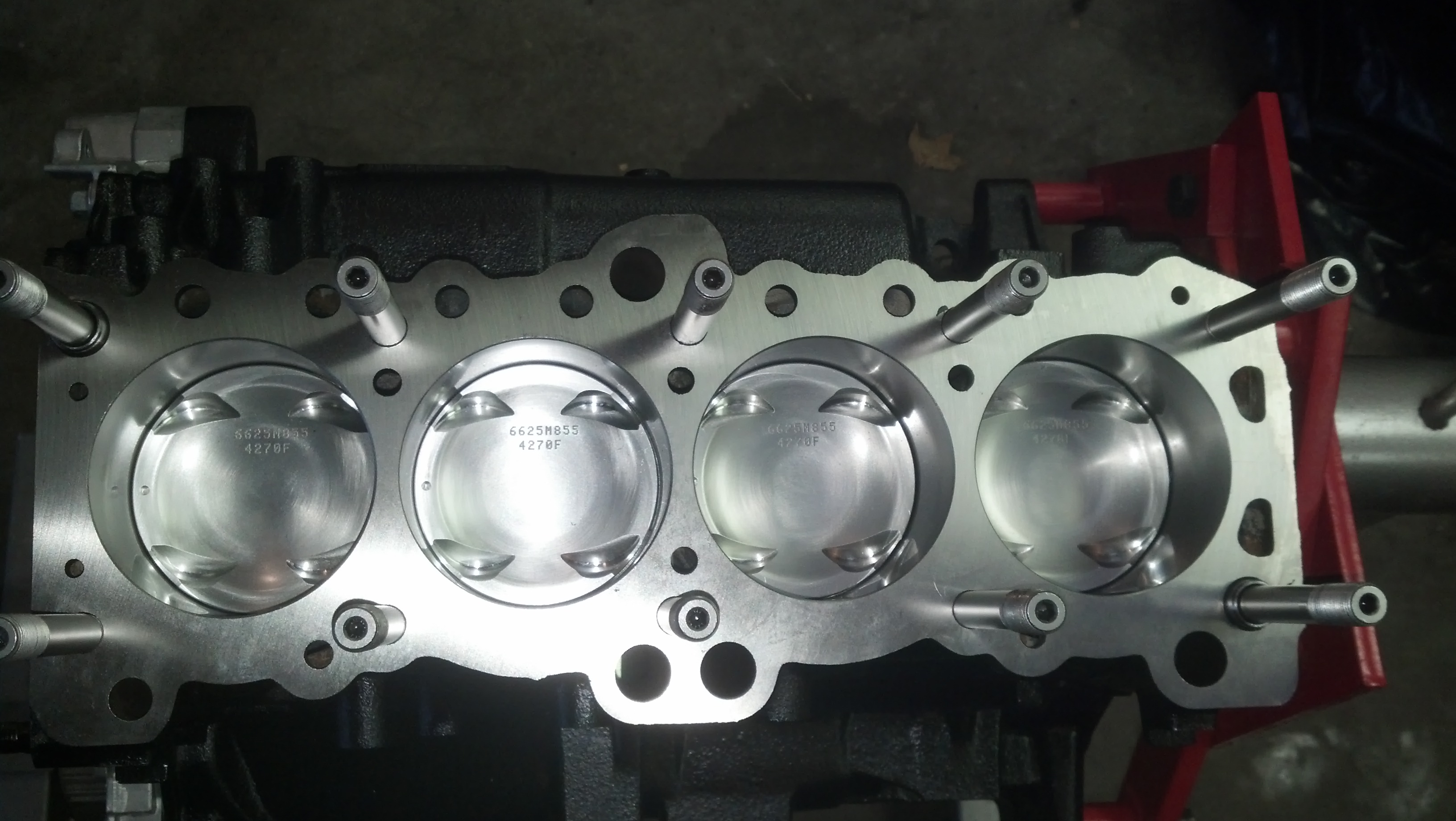

Well I got the long block assembled and ready to have the cams degreed. Now I just need the cams degreed, clutch rebuild kit and an upgraded clutch fork and the engine can go back in finally.

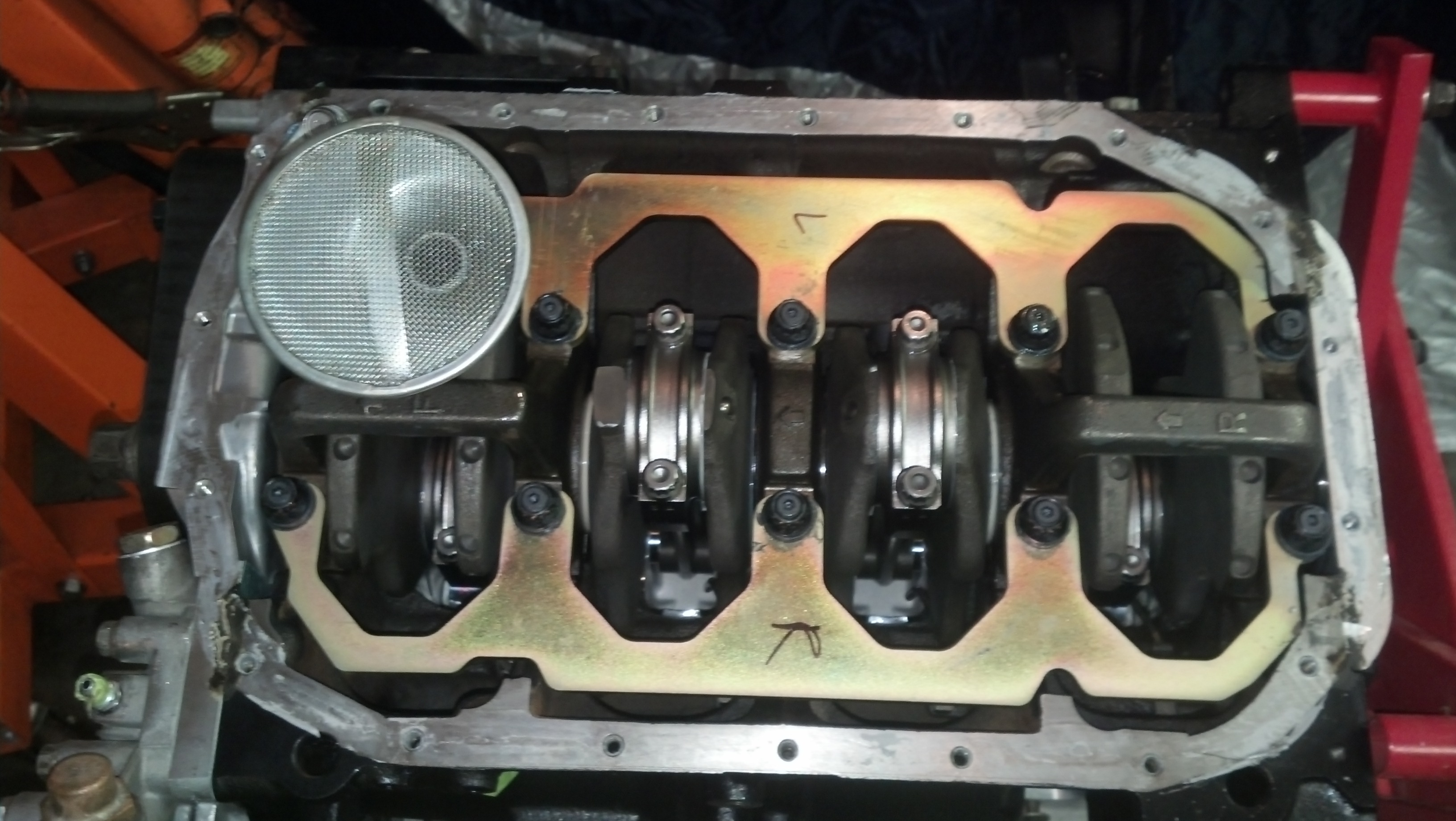

Also when I was going through my parts I found my oil pick up tube but map had already put on my oil pan. I figured map probably installed a new one but for my own peace of mind I pulled the oil pan and of course they did but I snapped a picture of the main girdle
ID:	13157   Click image for larger version
