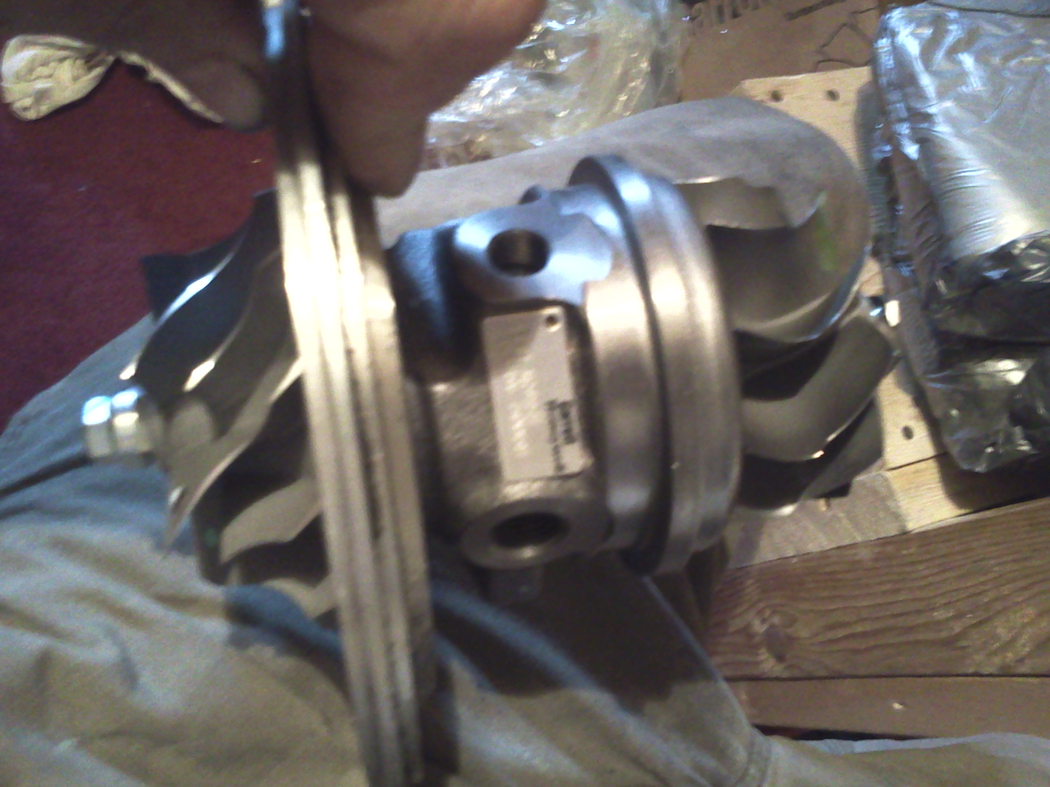

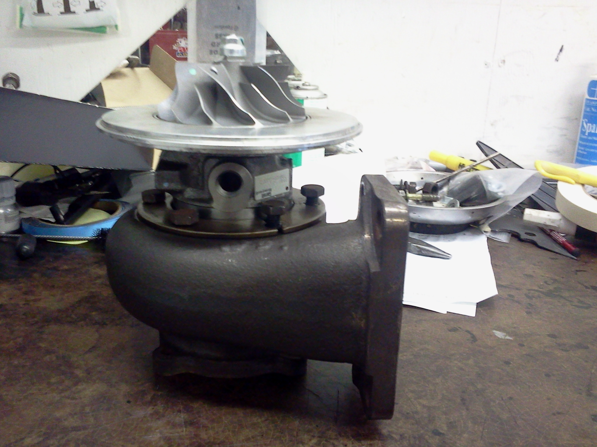

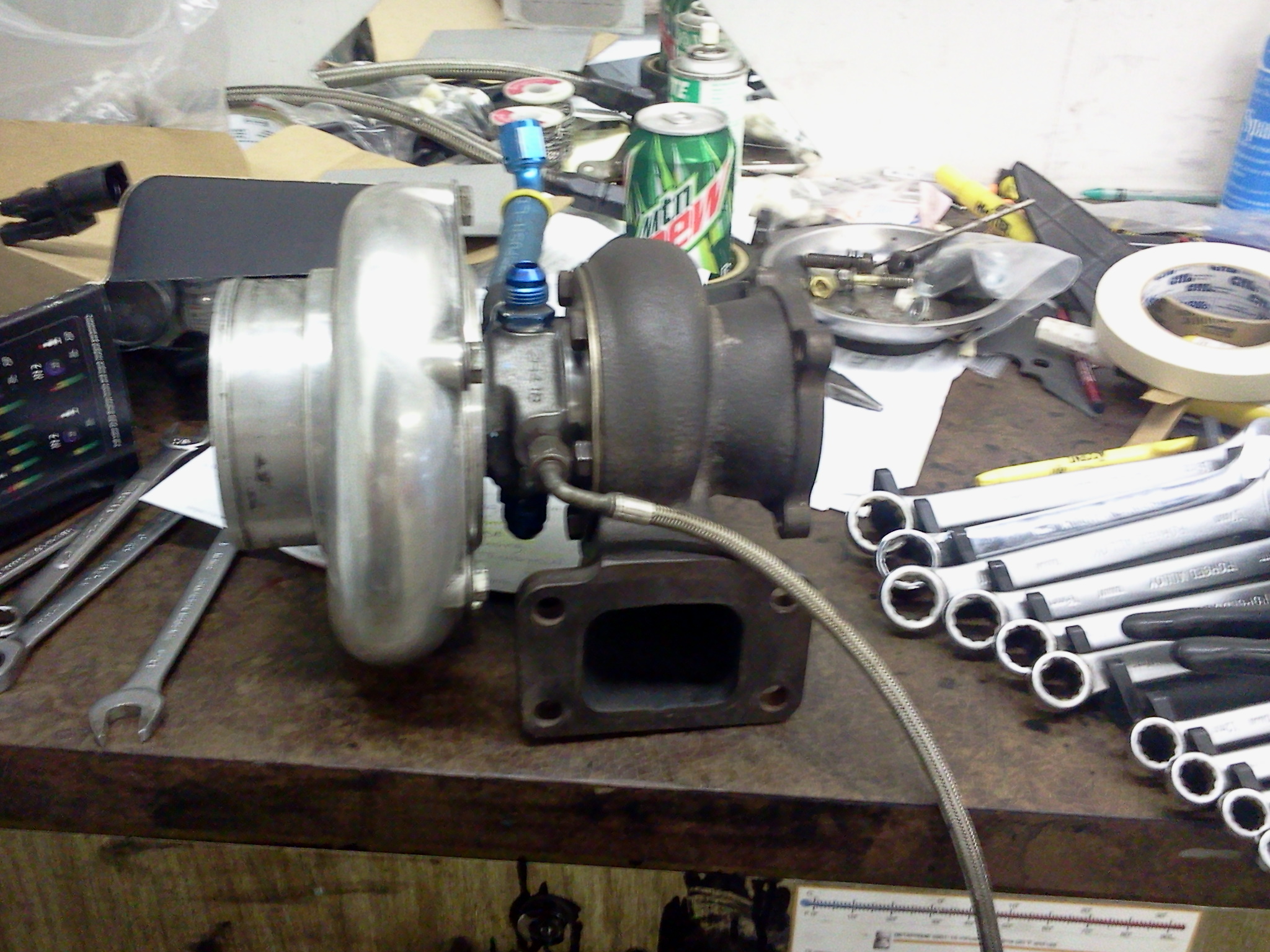

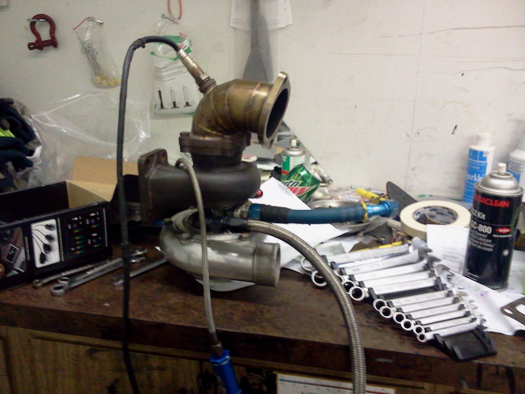

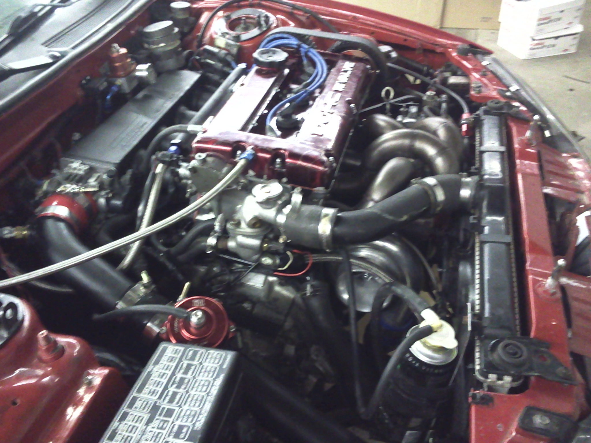

ok i had the sensor turned the wrong way so it should start. here are some turbo pics

That's a hell of a nice setup you've got there

well the crank sensor was bolted on backwards the guy who installed is a jackass. wait i did all that... anyways car fired right up and everything looked good after 20min i shut the car off and looked under it for the 10th time and there was somr oil. it looked like the back of the block because it was driping between block and trans by the slave. so last night i pulled the trans. looked like the oil galley bolt was leaking. so i put rtv on it and reinstalled everything. will give it another try today or tomorrow

what turbo is that?

turbotalon lol you are messed up. its my new stock appearing secret turbo. jk its my new chra gt3582r...
