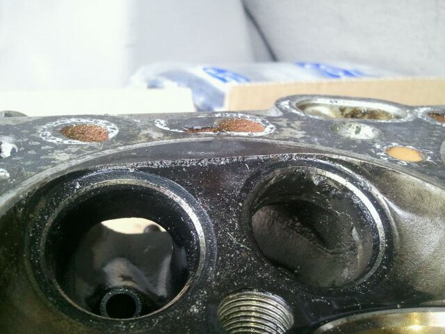

Valve melted to the valve seat. Taking my injectors to be flow tested/ cleaned at RavenWorks. Any other reasons it could have burnt like that? Head has around 152K and is all stock

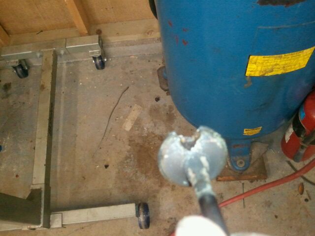

If the injectors test out fine what else could be a cause? Trying to eliminate all the possibilities that could have caused a burnt valve.
Mark and I discovered that the chunk of my missing valve had melted to my valve seat. I tried to get a pic but my phone isn't the best up close.

Lots of buildup on the valves too from the looks of it. That can cause hotspots, but I haven't seen it like that before. I wouldn't get too worried about it, just replace it and put it back together and hope for no turbine damage.

Finally got the pic of the valve seat I sent myself.

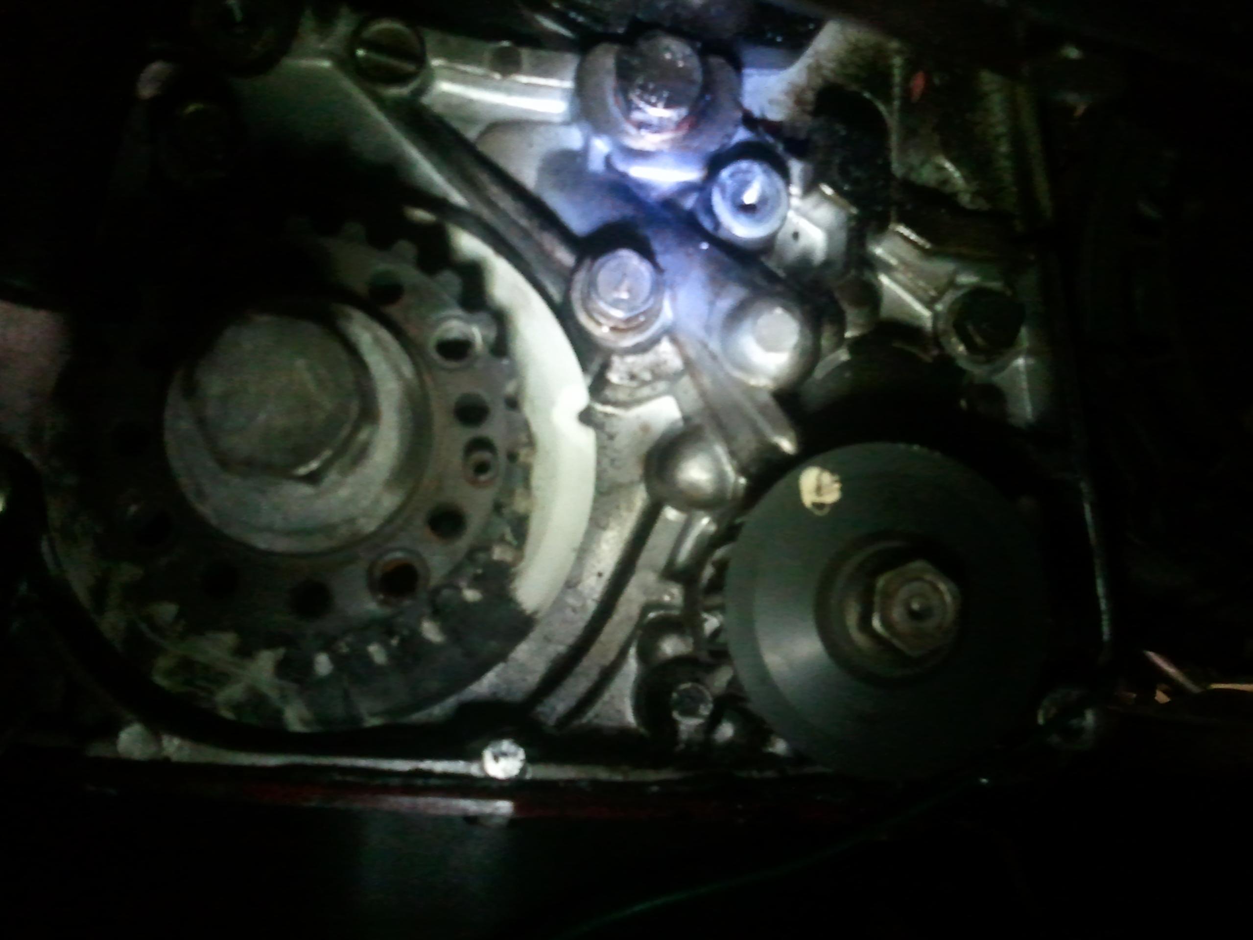

This is where the crank lined up to the timing mark when the cams with lined up and at TDC. How does it look?

I'm no expert here but it looks like the crank trigger is a tooth off.

That's what I was thinking. Want to get it perfect when I put the belt back on.
