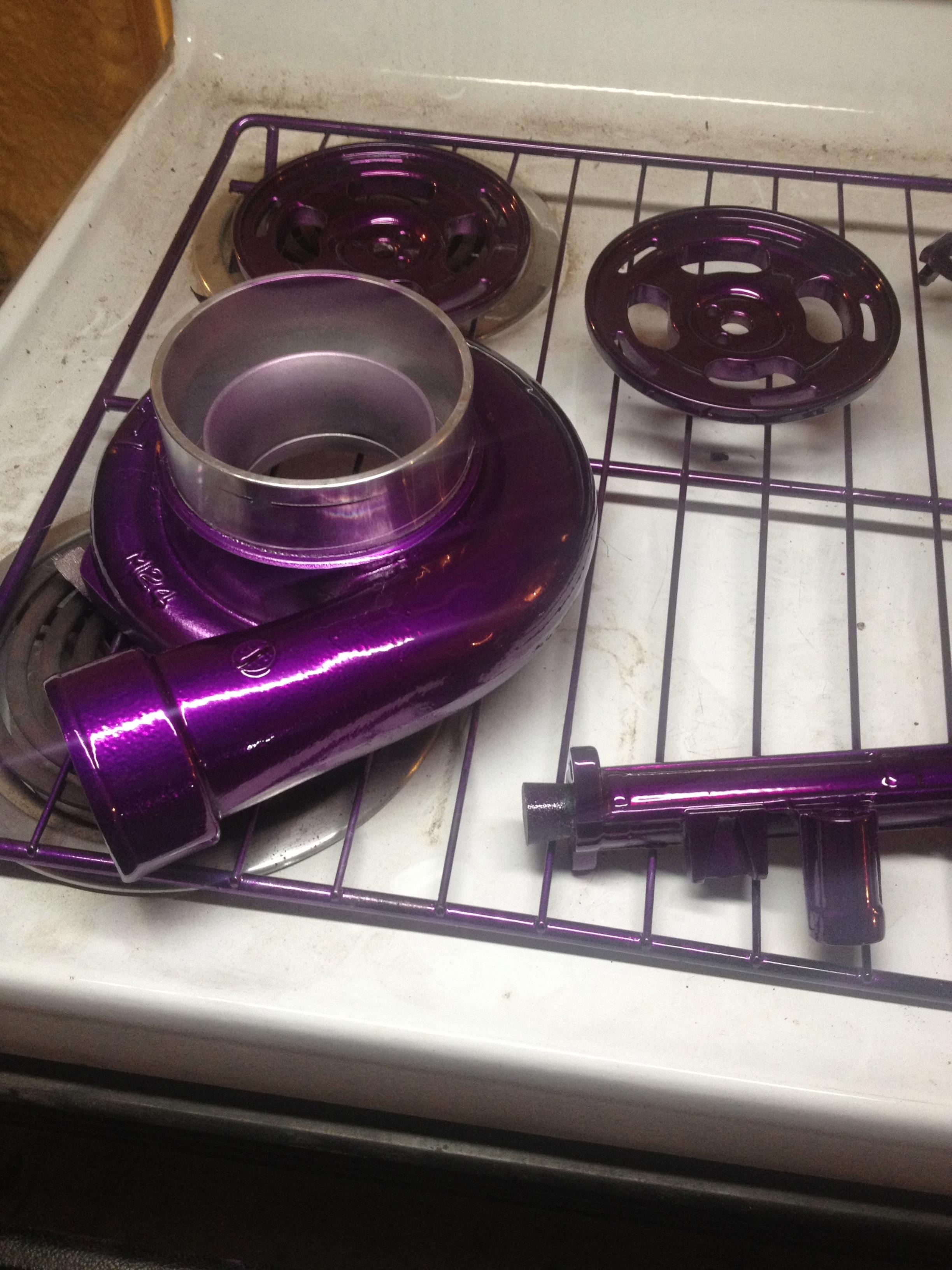

never considered ron before to be honest. may be worth a call. Yes we did the powder coating ourselves. tools for trans rebuild? I would absolutely consider doing my own rebuild if I had more knowledge of it or at least more write ups or vids to do the research.
Old 02-09-2014   #42
Re: team ab drag race and street builds
wow those coated parts look awesome

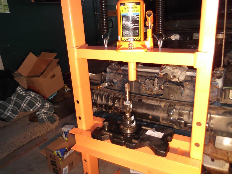

I always thought it was a big deal because it requires a press. I bought the one in the pic for around $170 with coupon at Harbor Freight. It worked great.

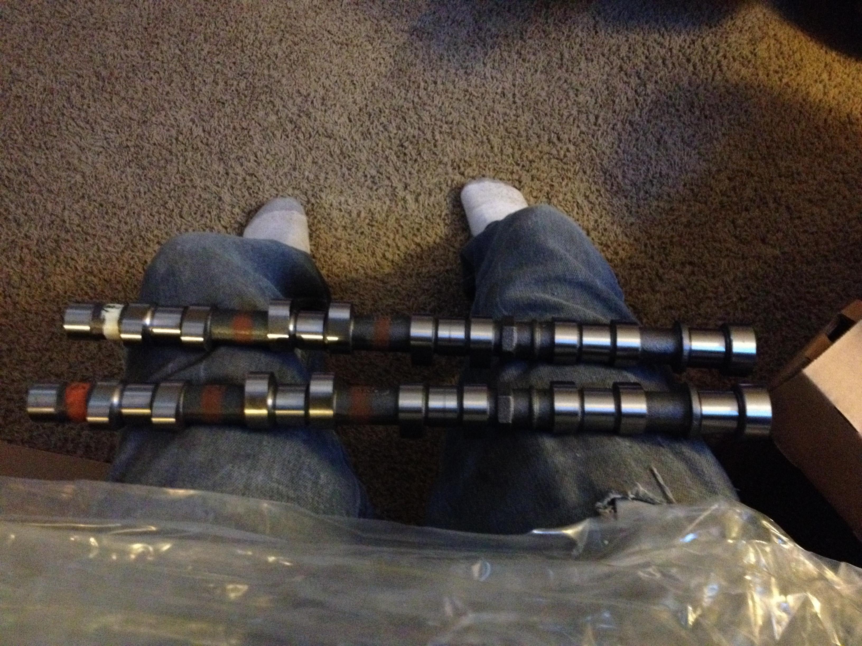

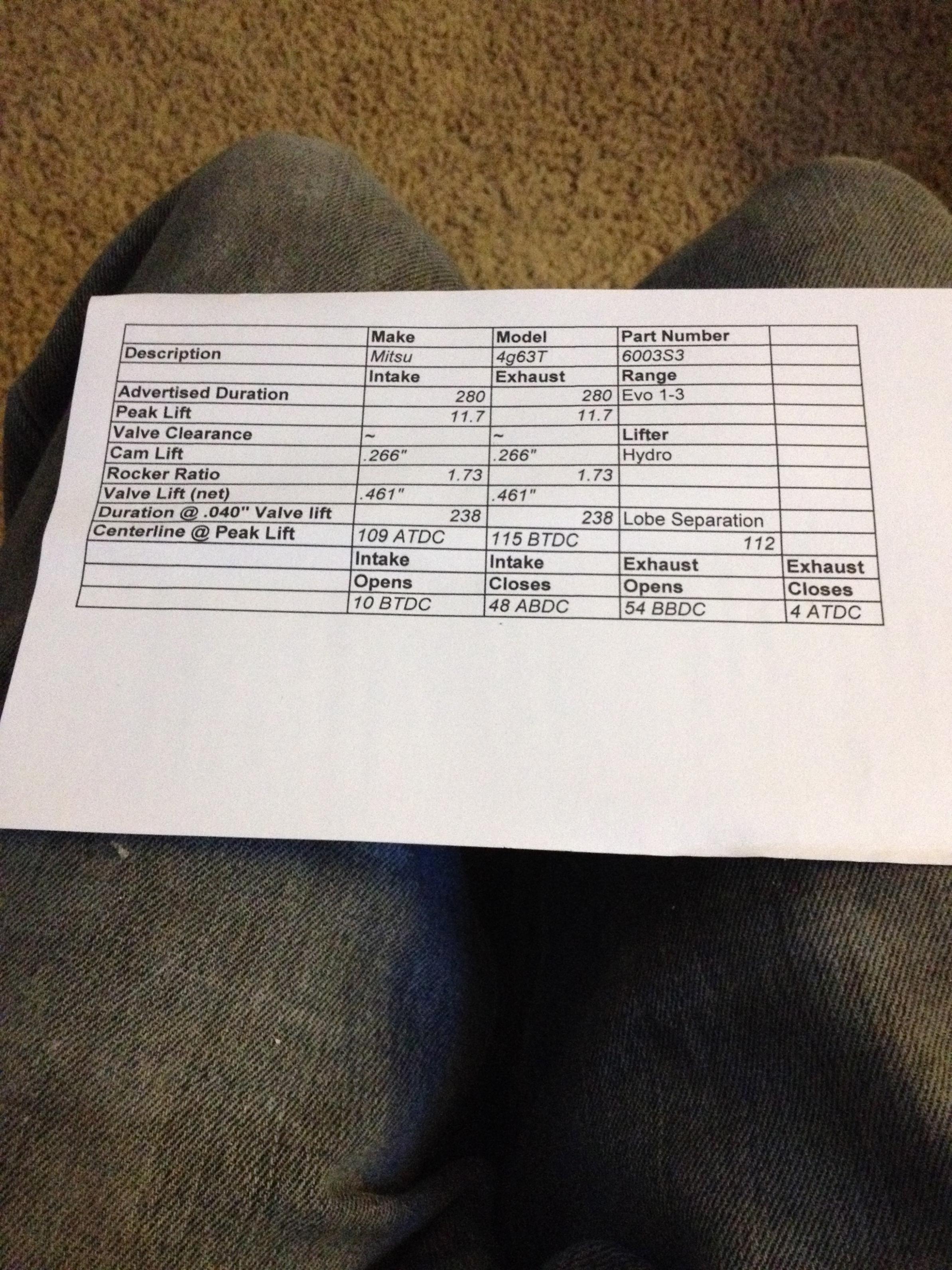

Can't get much better powder coat yesterday, New cams today. I can't wait to try these s3 out

Old 02-11-2014   #52
Damn, that's a lot of cam lift on a DSM.

^ gonna be sick high lift, high compression, and boost.

and some more powder coating, you know just incase they don't move they will still look pretty

Old 02-22-2014   #55
evotuner
evotuner's Avatar
Location: Mankato
Drives: 2004 Evo 8
Posts: 1,152
Looks great where are you doing this powdercoating at?

in the garage

in the garage
Sorry I'm just interested in the process, I'd love to learn how to do it
