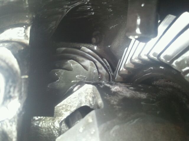

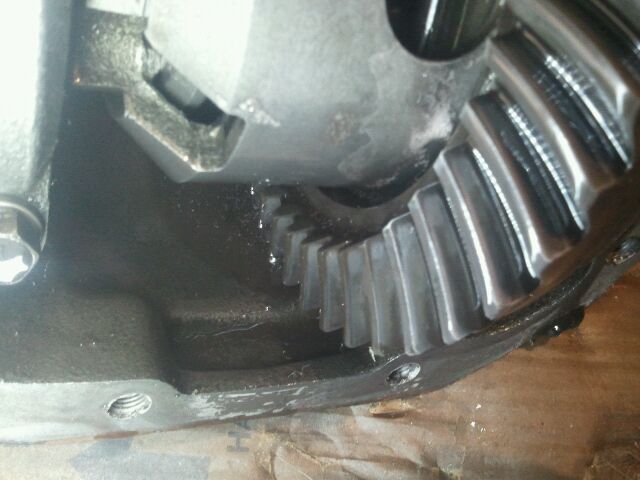

Still need to get the gear marking compound but here's just a quick look inside.

Lol, looks to me like there is no preload. Definitely not good. That pinion and differential needs to be shimmed and have the preload set correctly.

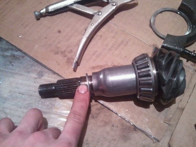

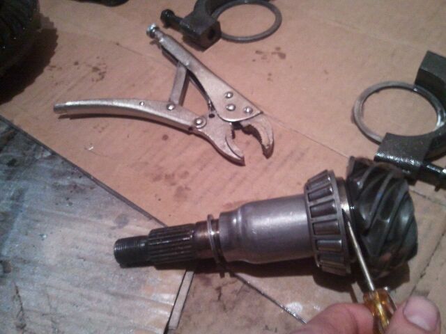

Well this is what I got so far. Confused as to which is the shim. I'm guessing it's the one my finger is pointed at because the one i'm pointing out with the screwdriver looks to be the same on both shafts and non removable.
If it is the one i'm pointing at with my finger than that is being used from my old gear set along with the sleeve which could explain why the new gears would be off.
Proven Force be able to help me with this? I don't have any dials or anything to measure with. I'm guessing it needs a thicker shim to move the gears more towards the center?

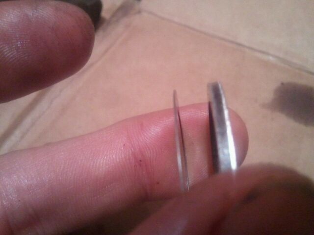

Just noticed the one my finger is pointed is a thick and thin "shim" if that's what those are. Here's a pic of what I mean

there are 2 shims, outer and inner. To move the pinion in/out, you have to change both accordingly, as the distance between the nut and the gear is fixed and you need to fill it with shims, bearings, etc.
I'm sure proven force can help you. No idea how much they charge.
A dial indicator is maybe $20 at HF and is accurate enough for your purposes.
The problem is if you need to change shims, you'll have to order the full set for each shim, and I think it was maybe around a $80-$100 investment for all of them. I might have spares i'd sell individually if you determine what size you need.
Do you have a factory service manual? I highly encourage it for all DSMers.
