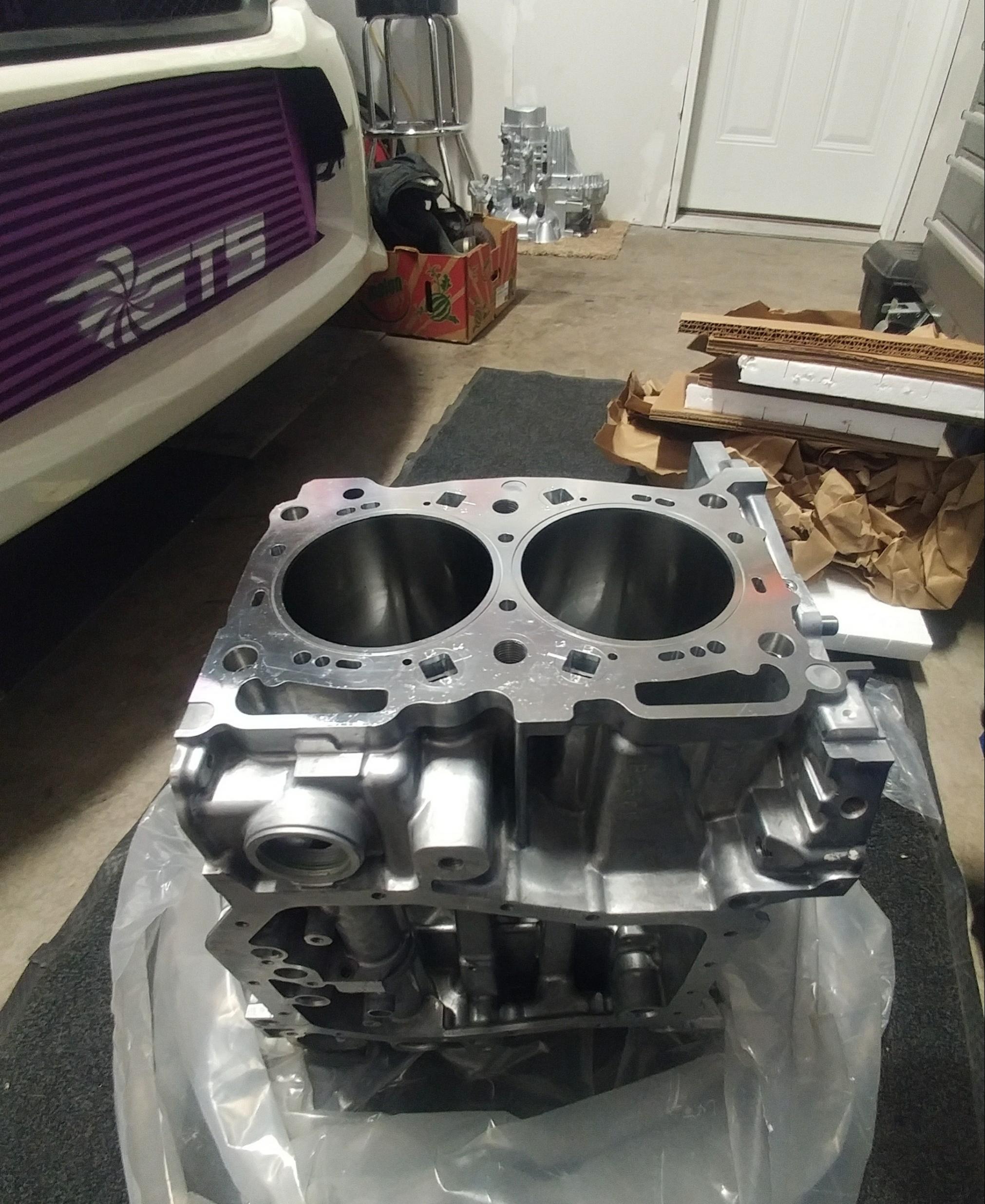

Havnt updated the thread in awhile so here whats been going on the shortblock i built first got tore apart to send the case halves out to get closed. The new case halves just arrived today stg4 iag closed deck, pinned mains, oringed deck, 14mm headstuds etc.. Also have been gathering some other parts as in all my fuel stuff and some other little goodies. Shortblock is getting assembled next week and then possibly after i get the longblock together itll go in the car possibly. We will see.

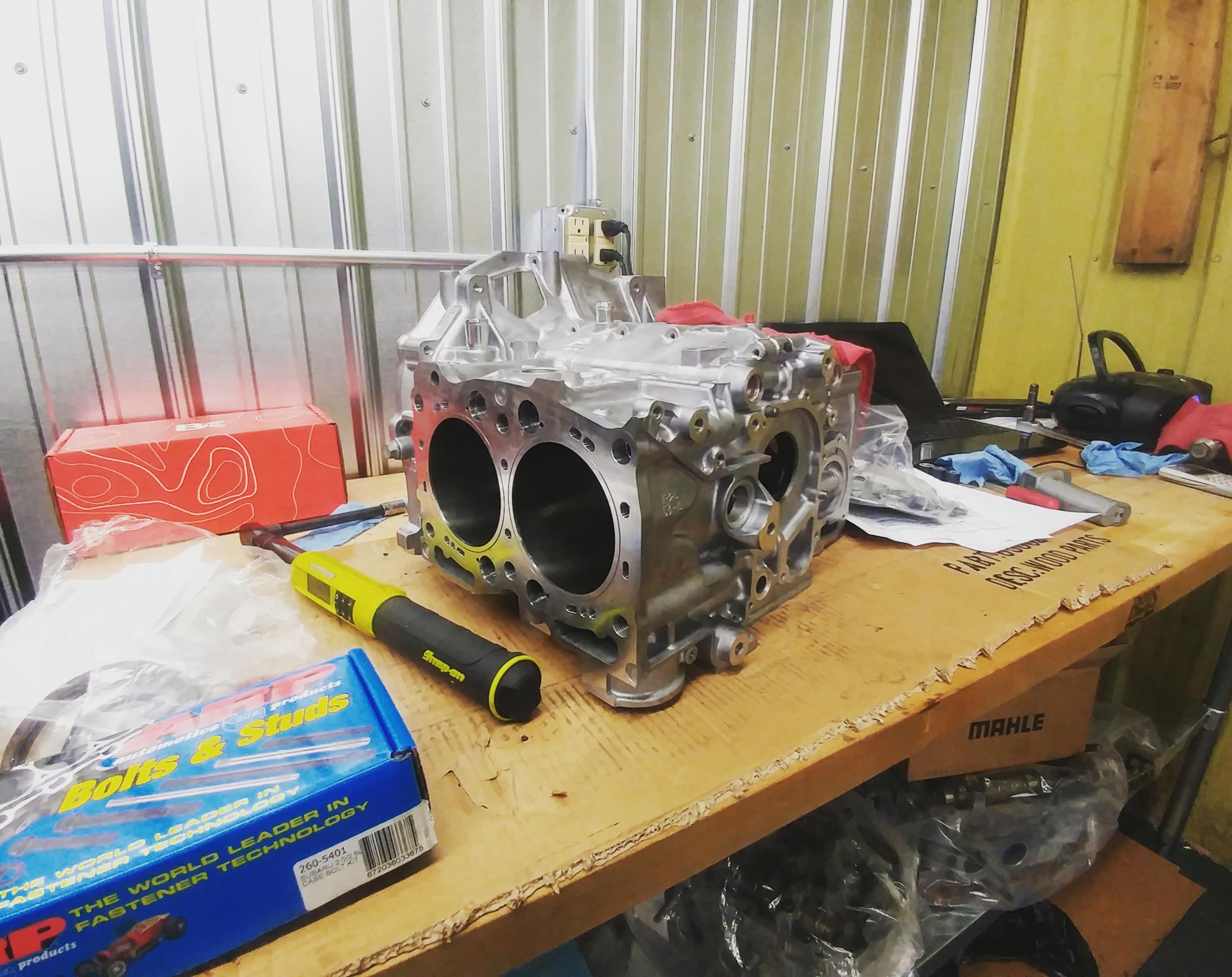

Time to get the shortblock assembled. Heres a list of whats in the new shortblock and whats done to it.
- Stg 4 Iag closed deck conversion
- Pinned mains
- O-ringed deck
- Manley turbo tuff i-beam rods with arp 625 rod bolts
- Manley turbo tuff extreme duty 99.75 pistons
- King rod / main bearings
- New oem 08+ Sti crank

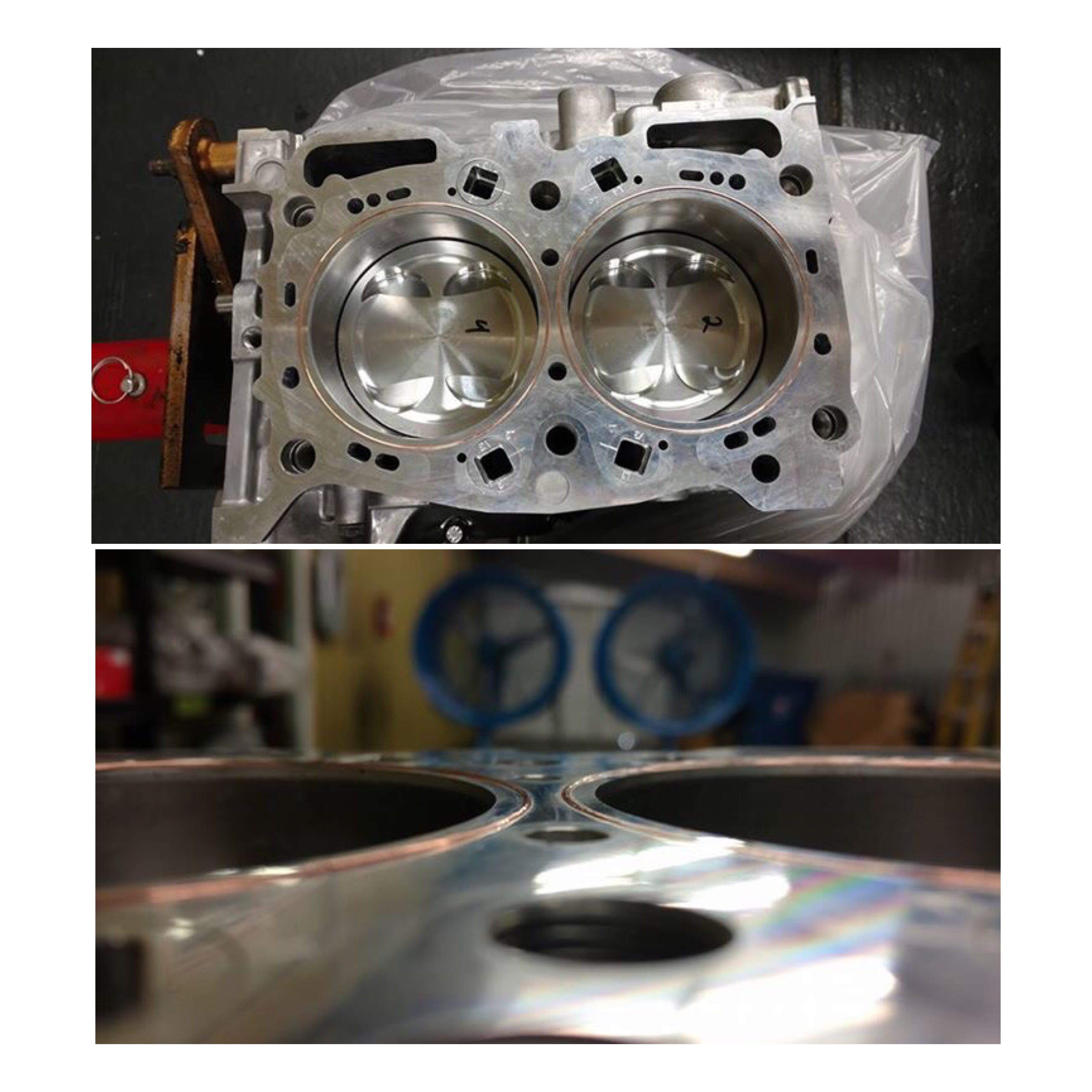

Longblock is assembled completely and hopefully going in the car this weekend if not next weekend. Heres a pic of the shortblock assembled and showing the orings.

Old 02-09-2017   #47
Speedfreak
Drives: four tires
Posts: 1,608
Re: 2011 Sti Build ?
Using copper head gasket?
NSX - S480/Built motor
GSX - 571whp/490wtq
Sienna
Old 02-09-2017   #48
dsmDolney
dsmDolney's Avatar
Join Date: Jan 2014
Location: Blaine, Mn
Drives: Racecars
Posts: 679
Je Pro Seal headgaskets
Tyler
2011 Subaru Sti 11.0 @135mph
Old 02-09-2017   #49
Speedfreak
Drives: four tires
Posts: 1,608
I don't believe that will work. That's a MLS.
An o-ring needs a maleable surface to press into. Which is a copper gasket.
You may ruin the o-ring if you use an MLS and torque it down onto that o-ring.
GSX - 571whp/490wtq
Sienna
Old 02-09-2017   #50
dsmDolney
dsmDolney's Avatar
Join Date: Jan 2014
Drives: Racecars
Posts: 679
You are correct it is a mls gasket yes. It accually does not ruin the o rings itself
Alot of people run mls head gaskets with o rings and is accually recommended by some of the best subaru shops in the US

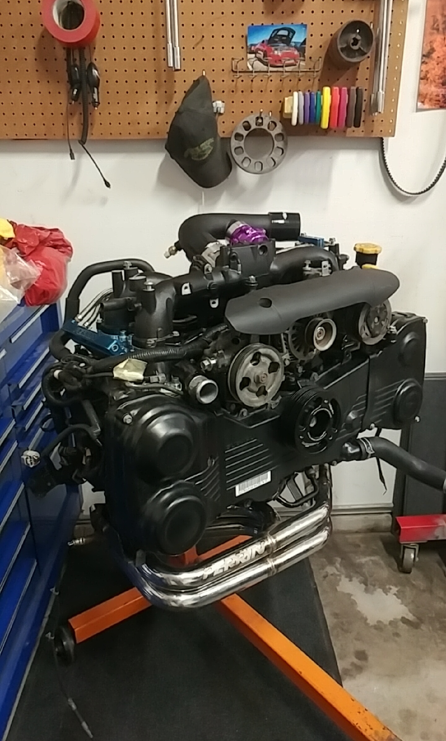

Update on the Subaru, well the engine and everything is in. Waiting on a couple more small parts to come this week then it will be time to start. More updates to come after breakin.

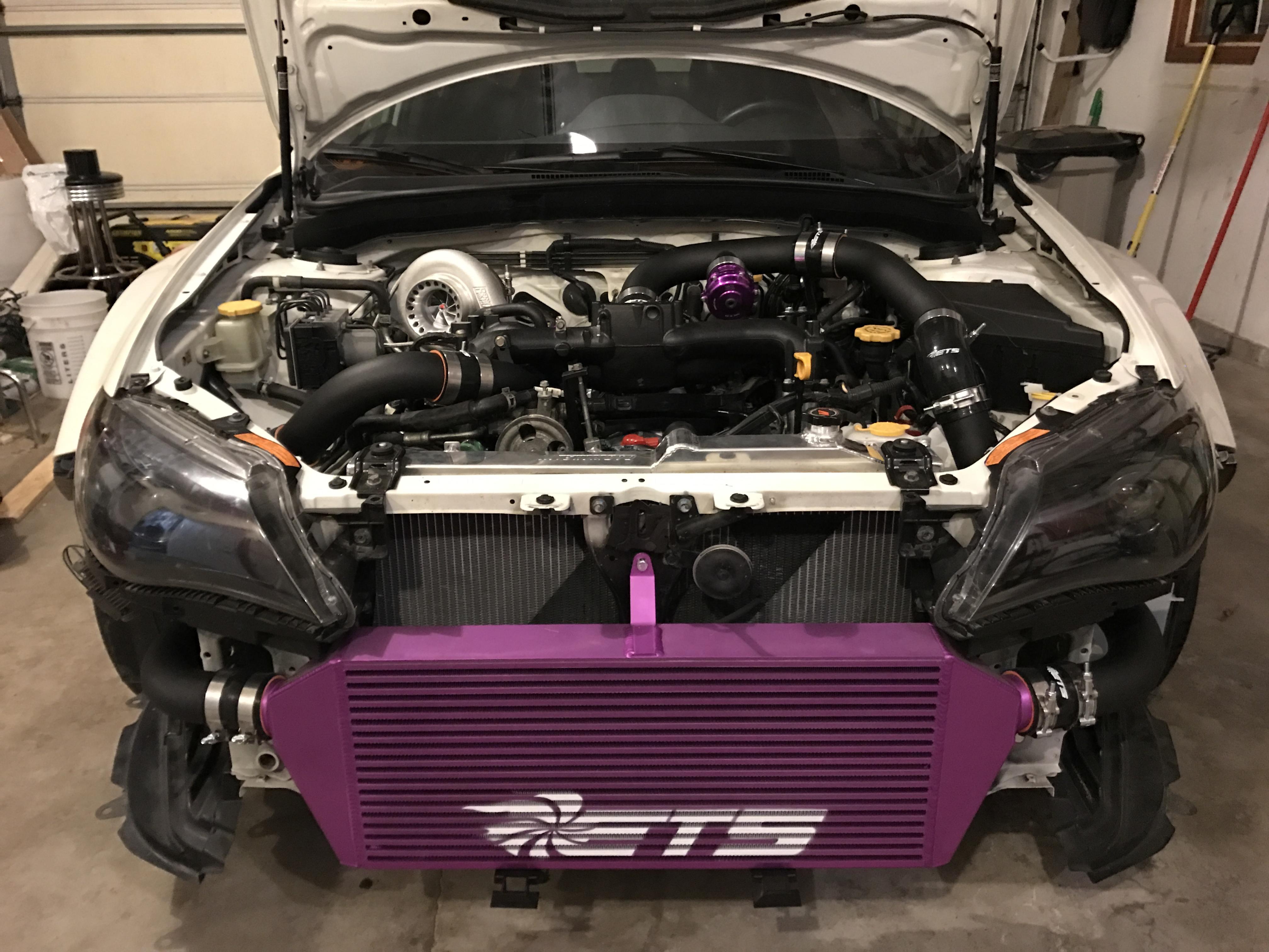

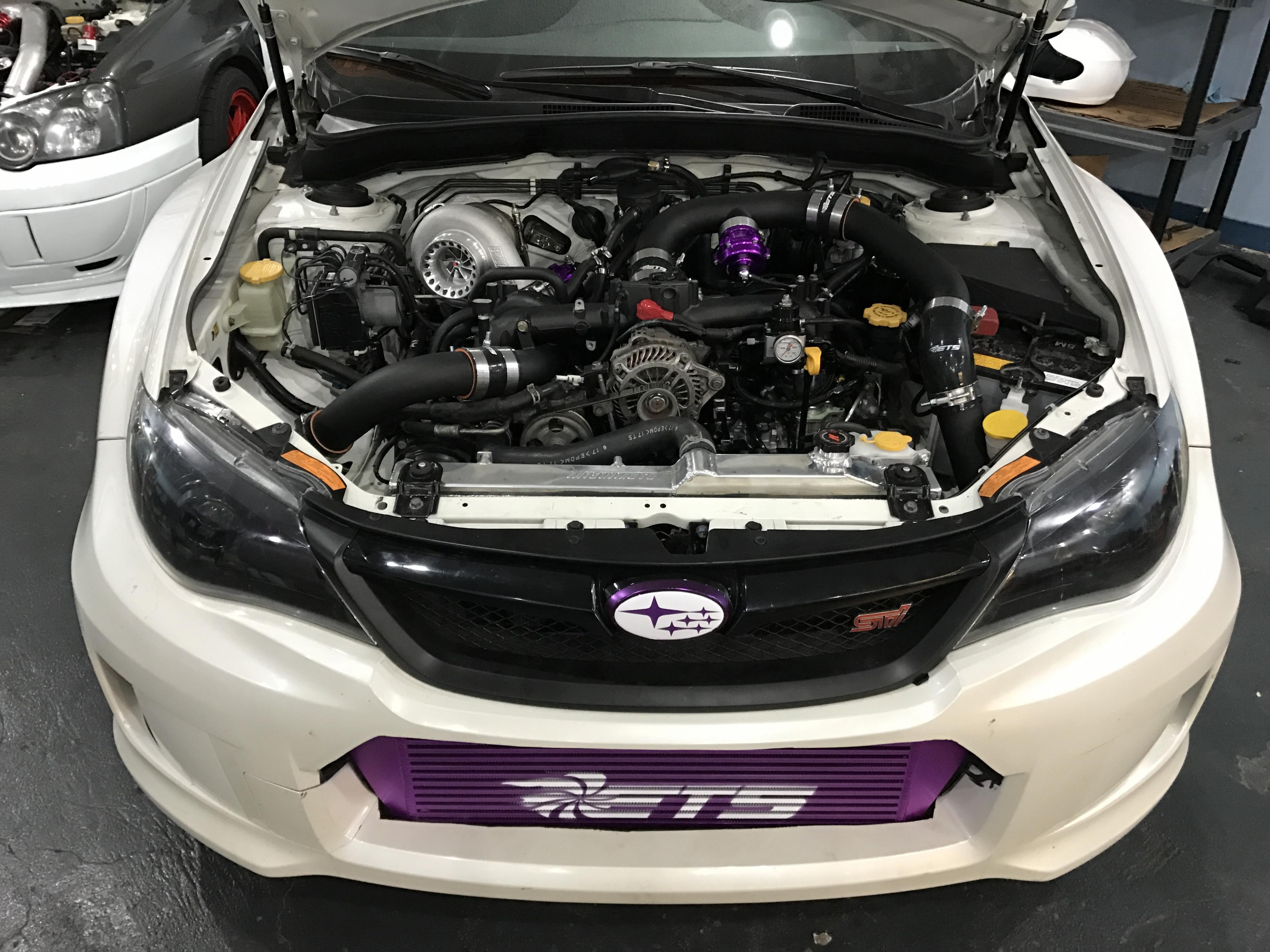

Started the car for the first time in 2 years and it was definitely a relief. Its 100% done and ready to rock we get it on the rollers this coming Thursday.

Little update now since the car has been running. Put up on the dyno and we maxed out my single walbro 450 intank pump. Car put out just shy of 600 whp at 485 tq. The car is no were near its full potential at this power level but just cant push it more with my fuel setup. This winter i plan on adding a surge tank along with dss axles all around with a triple disk clutch. Then we should be able to make some real power.
