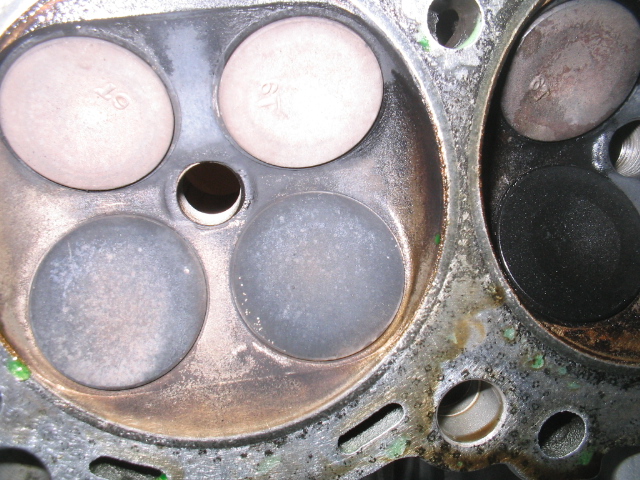

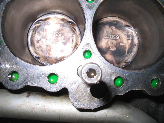

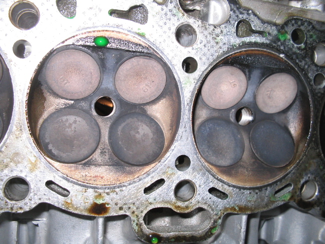

Re: High Knock in my Talon
Some fun pictures! Anyone see anything that doesn't look right? It all looks normal to me.
Just got a call back from Red Rooster. He said a lot of the valves are leaking, and they marked which ones are leaking. I'm going to pick it up from them later and decide what to do exactly. So my only guess as to what happened was that some of the lifters were too pumped up still, and I should have bled them better, and resulted in a some valve bendage!
