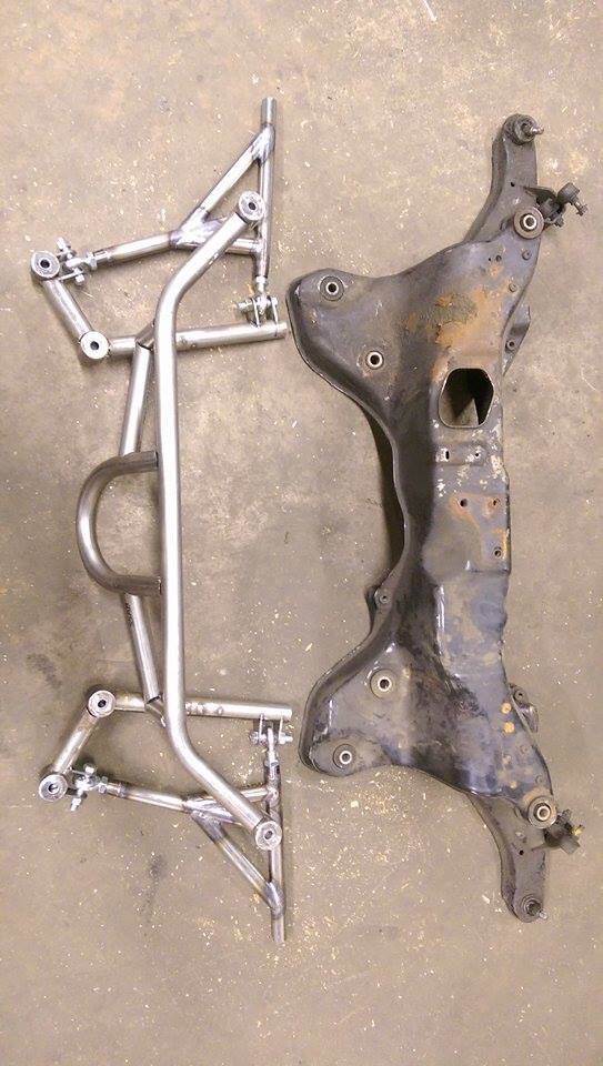

Now that the block is at maperformance for machining I'm starting my kmember fab. First stop is measuring everything and get a starting weight.
72 lbs, it has all the bolts, brackets, and driveshaft loop. I know others have weighed just arms and kmember at 64. This is going to save a ton of weight!

This weekend was fruitful. The k member is coming along awesome. I need to figure out the steering rack mounting points and the driveshaft loop.
It's made from 1.5" .083 4130 chromoly. My tube fab skills are getting better. All this practice will pay off on my next car, I want to build a competitive rwd chassis car.

Those notches look so nice and tight. Rwd chasis car seems like it would be right up your alley. What platform would u use?
