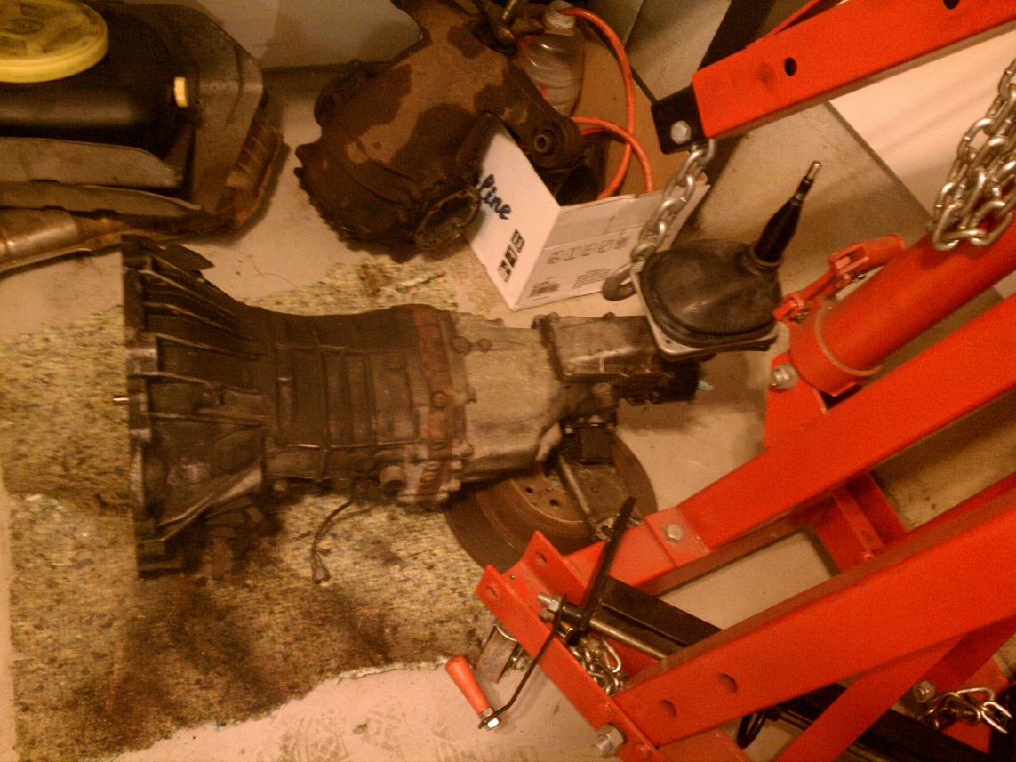

Old 01-03-2013   #763
Re: Project Lex

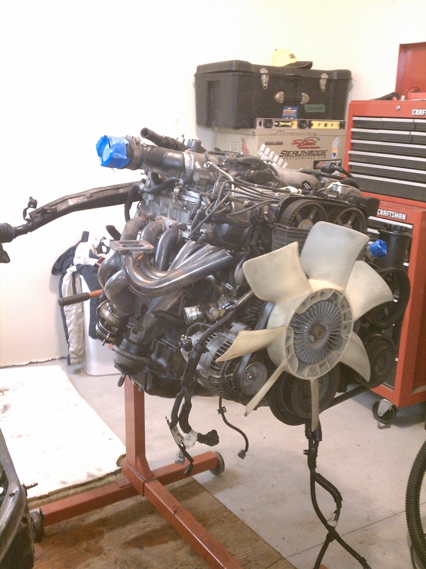

Trans off, motor on the stand. That's how she'll remain until we come back!

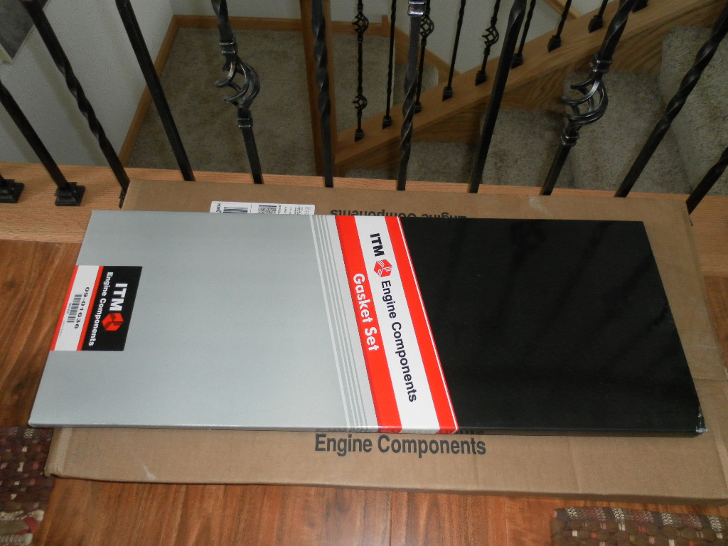

Got home and had a couple packages waiting for me.
Engine gasket kit:

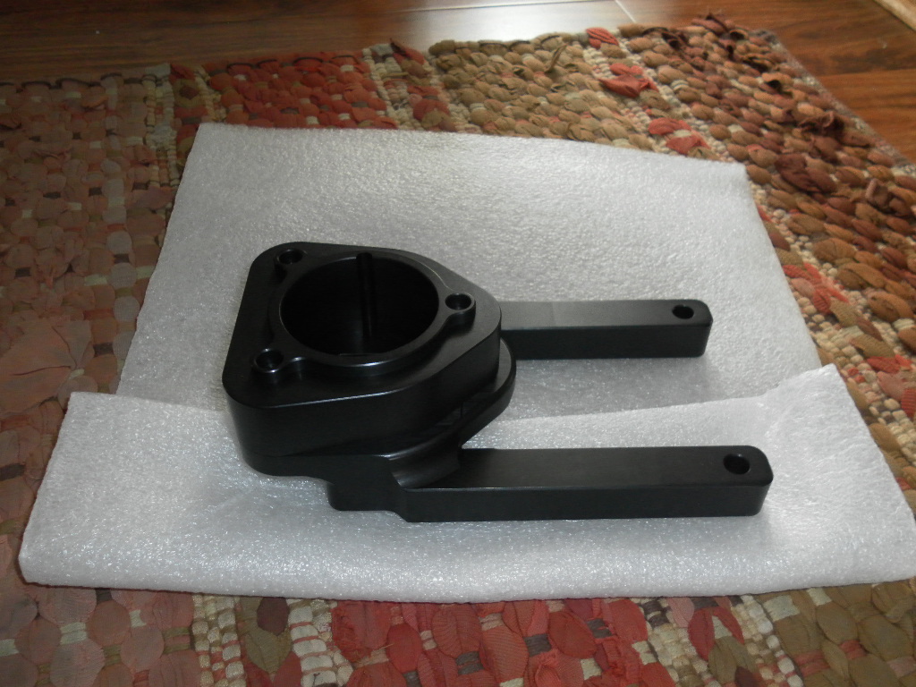

Billet shortenen shifter bracket, to move the shifter more forward to better place the shifter. The shifter will still end up a few inches more back than the stock one was, but this is as short as it can get. So might have to modify the hole in the tunnel, as well as figure out what I'm going to do with the interior trim.

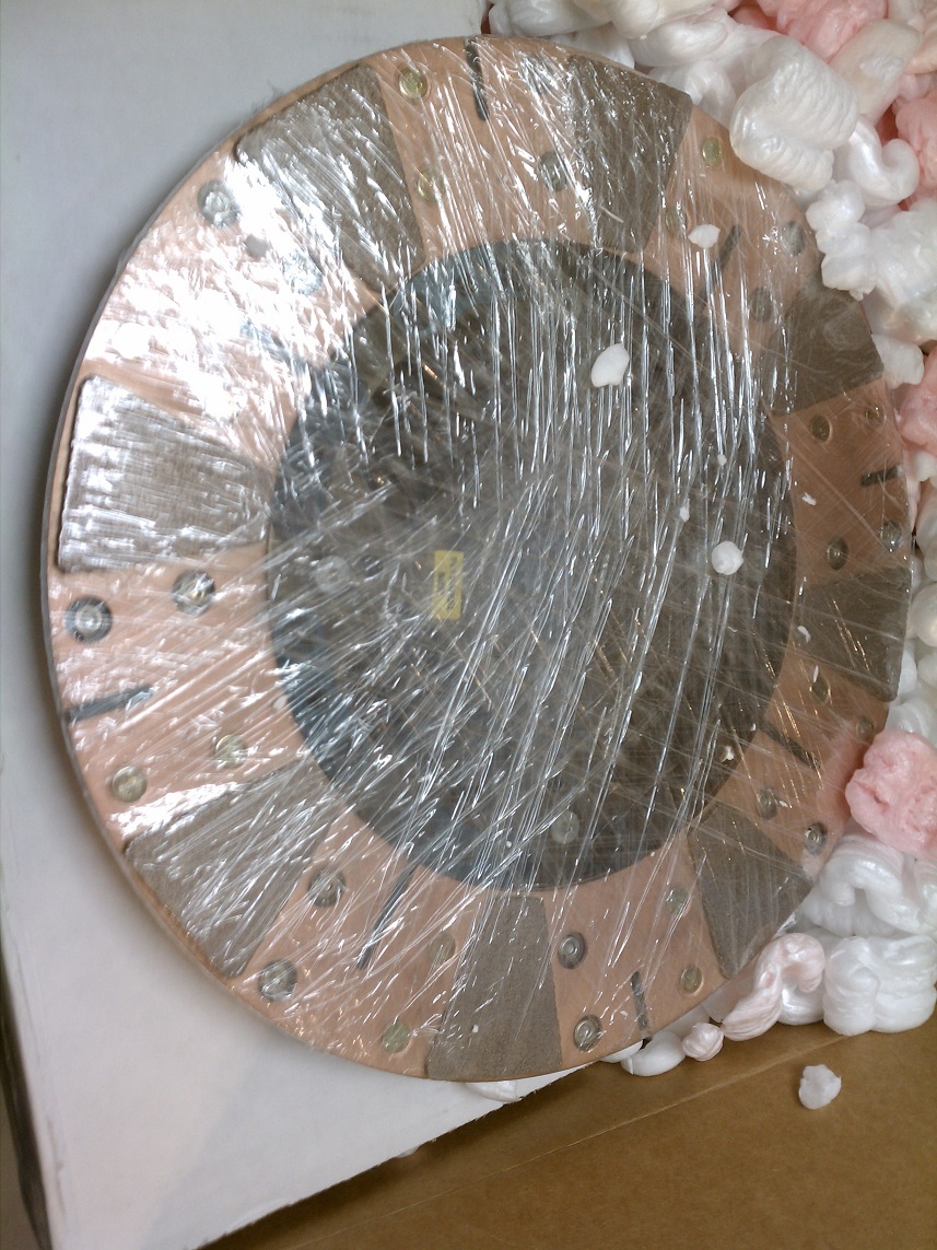

Old 01-18-2013   #773
Re: Project Lex

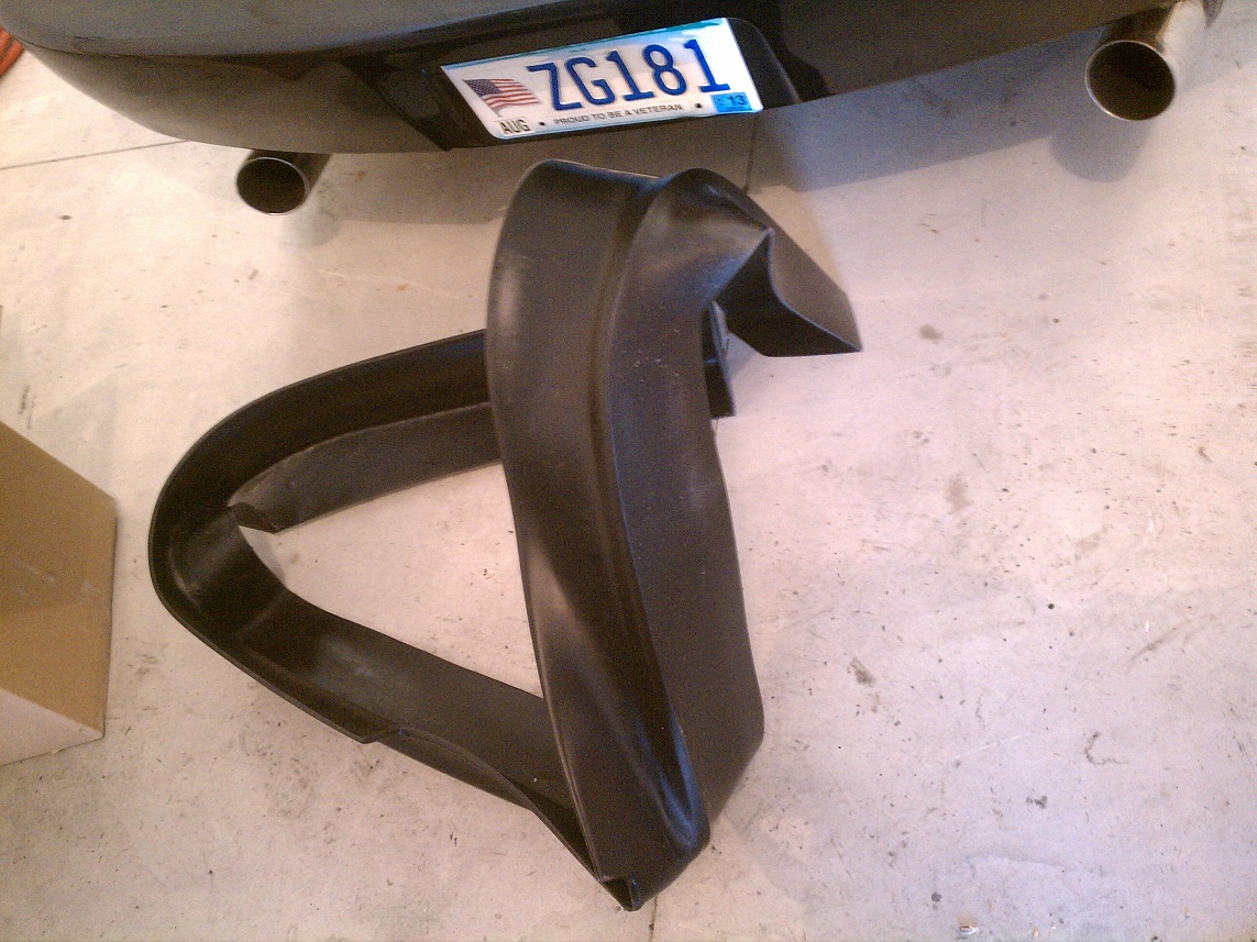

Received the correct clutch disc today, finally...

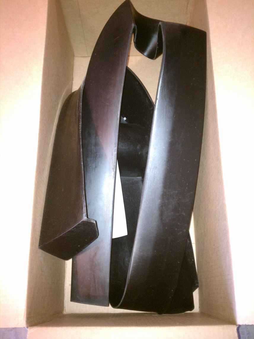

Also received my new poly rear bumper lip today from Rideskinz. What do ya guys think?

Old 01-18-2013   #774
Re: Project Lex
WTF at that lip lmfao! Are they serious???? This time ebay has failed you. haha
Old 01-18-2013   #775
Re: Project Lex
Hahaha, I seriously can't help but laugh right now!

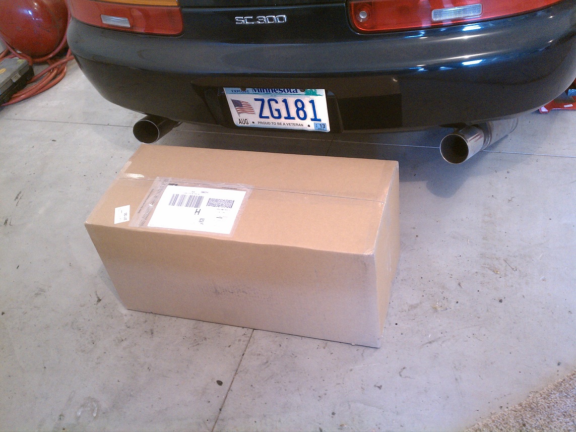

It wasn't ebay, it was a vendor over on Club Lexus who makes these and is doing a group buy. Needless to say, he has an email in his inbox

LOL at lip i'm sorry you were on the victim but thats just fucking stupid.. i hope you get your money back..

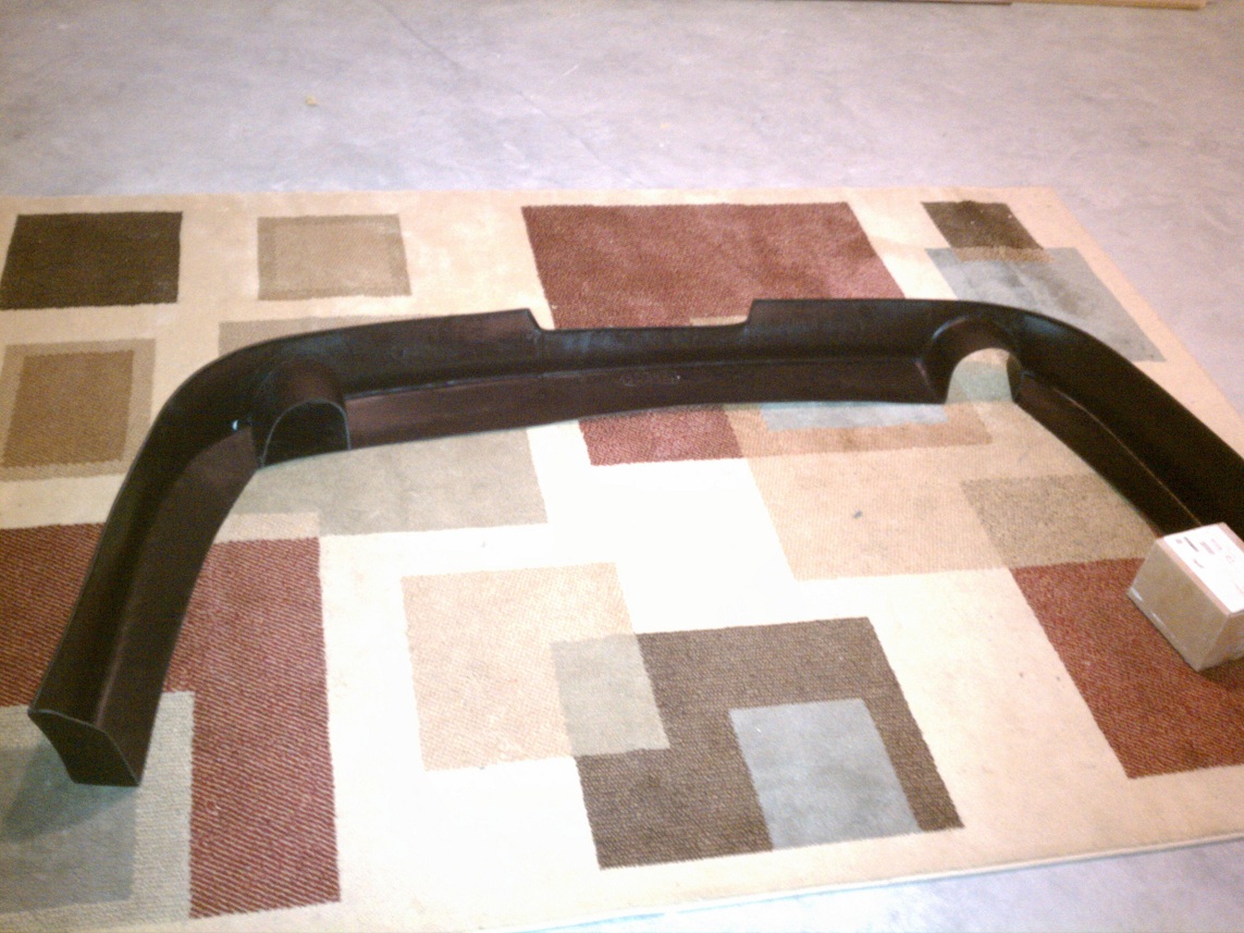

Old 01-18-2013   #777
Re: Project Lex

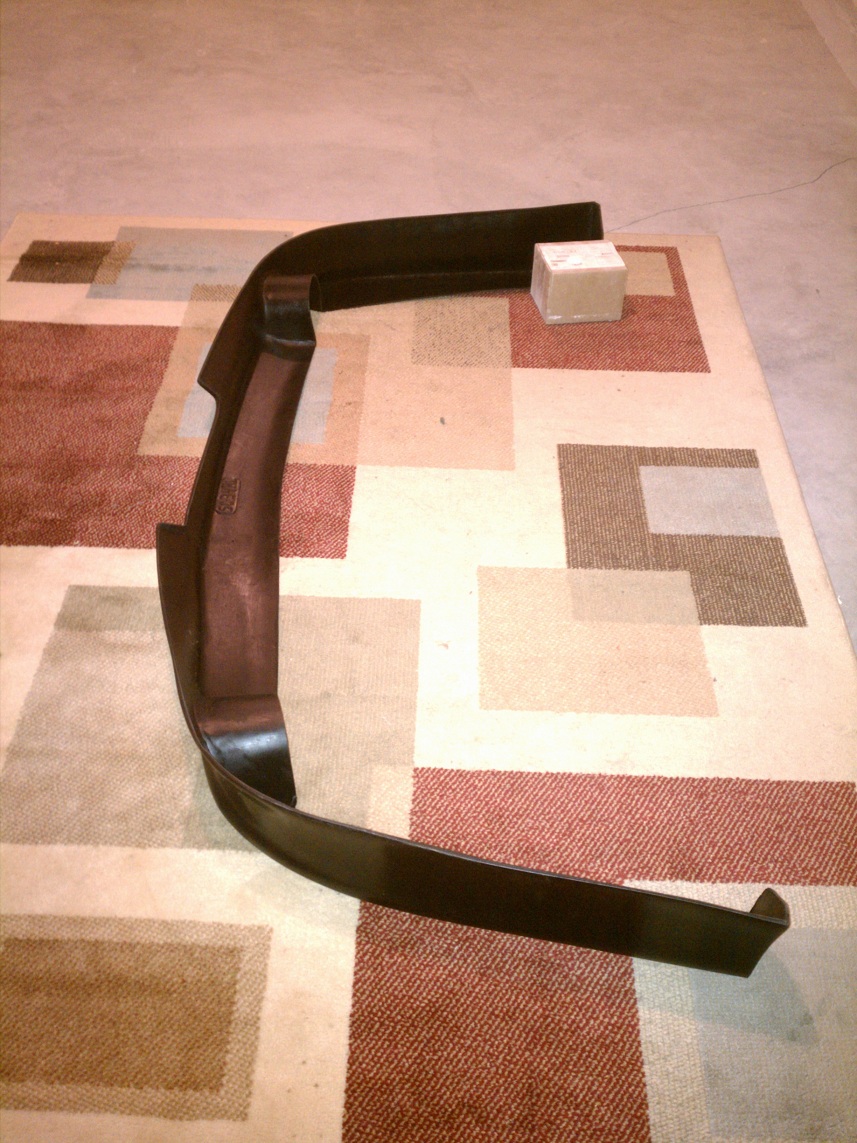

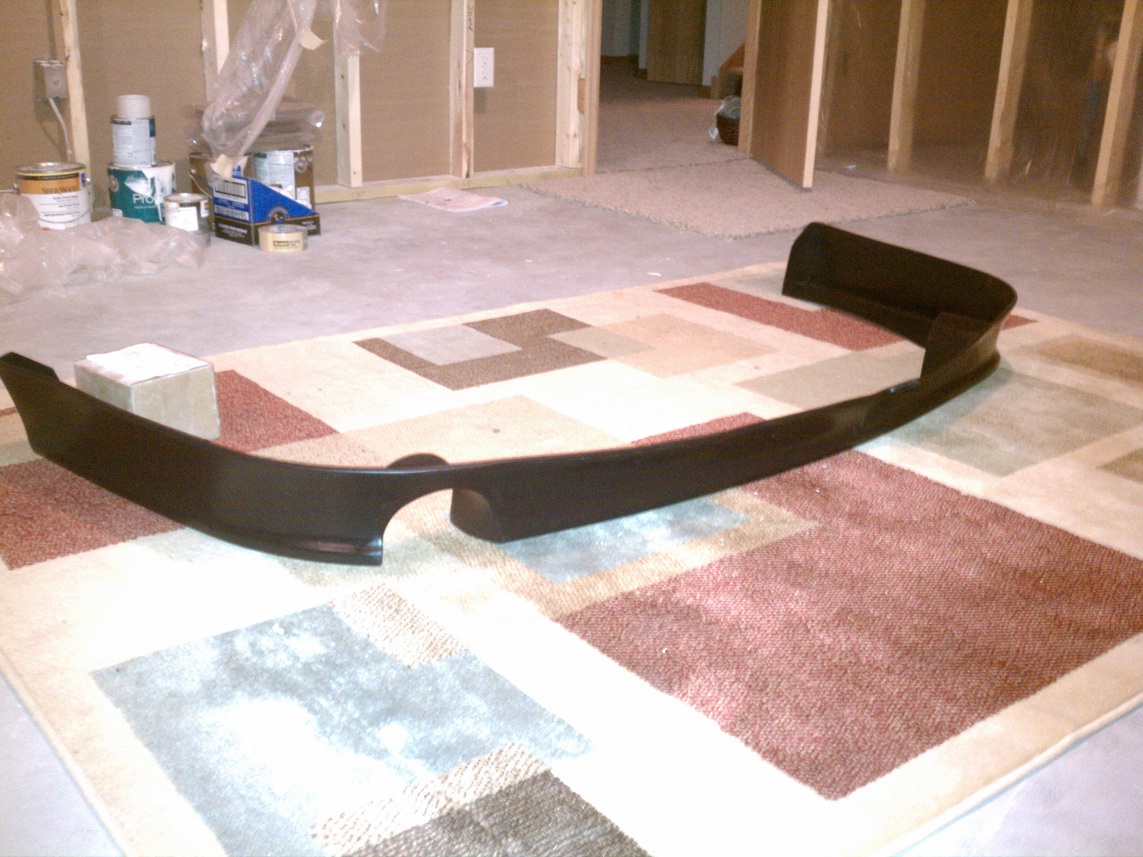

I have it sitting in the house now. Looks like now that it's warming up it's starting to flatten out. Still has a little unwanted curvature but might end up being ok.

Old 01-18-2013   #778
CornFed2.4
CornFed2.4's Avatar
Join Date: May 2005
Location: Linwood, MN
Drives: You crazy!
Posts: 2,354
Re: Project Lex
I couldn't help but laugh either. I'm sure they will make it right and your not the only one that recieved it packaged like that.
It does look better though
Old 01-18-2013   #779
Re: Project Lex
One thing you will notice, is that one exhaust hole is cutout, while the other one isn't, but is made to be cutout if you want dual exhaust. I currently have dual, but could convert to single if I wanted. Might have to think about that one...
Old 01-18-2013   #780
95talonracer
Finally Tuned...
95talonracer's Avatar
Location: Zimmerman
Drives: Spyder GSX
Posts: 2,484
Re: Project Lex
Wow what a way to try and save on shipping. I say go with one pipe.
