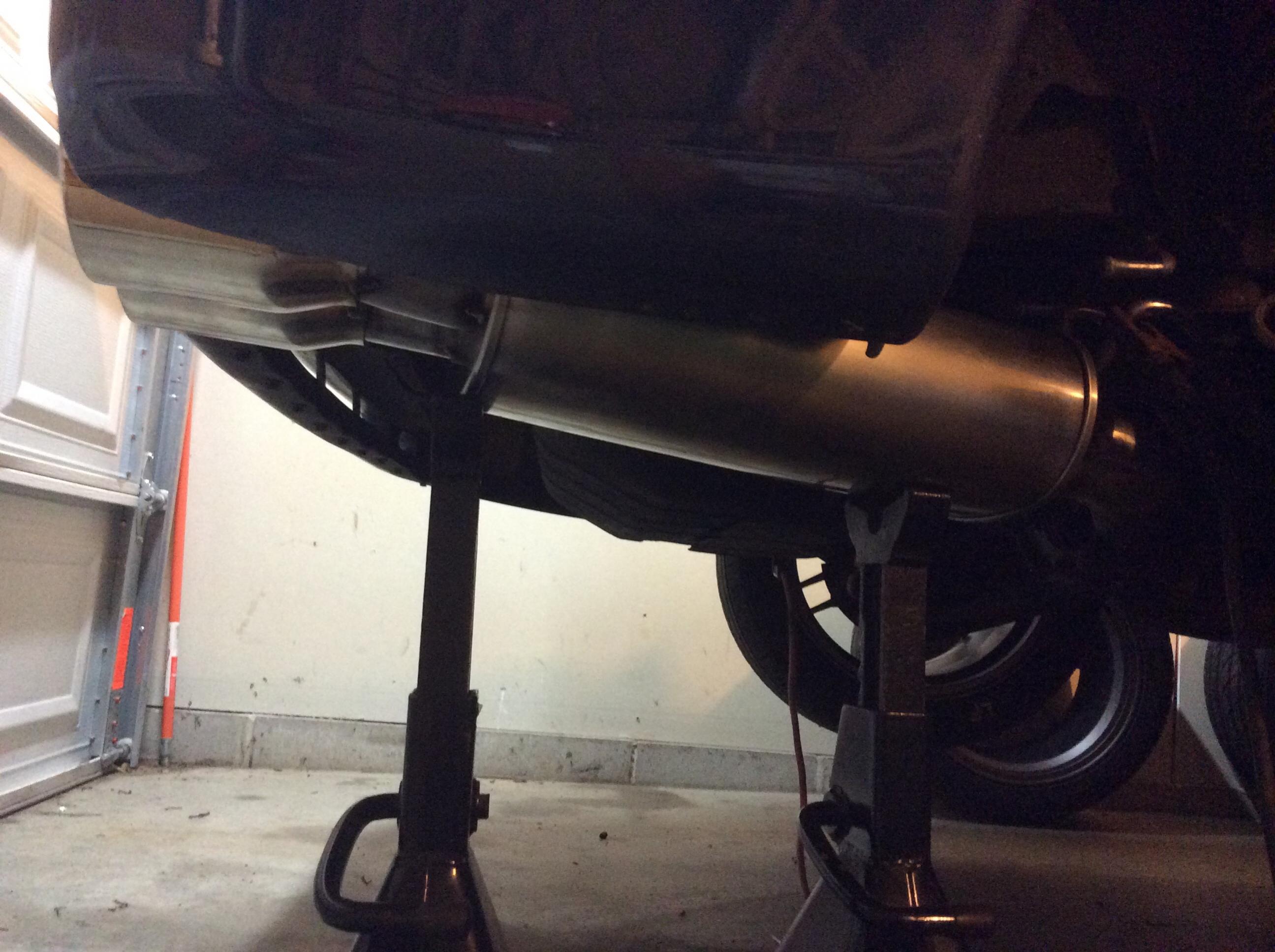

Finally getting around to updating this thread. Project stealthy exhaust is well under way!

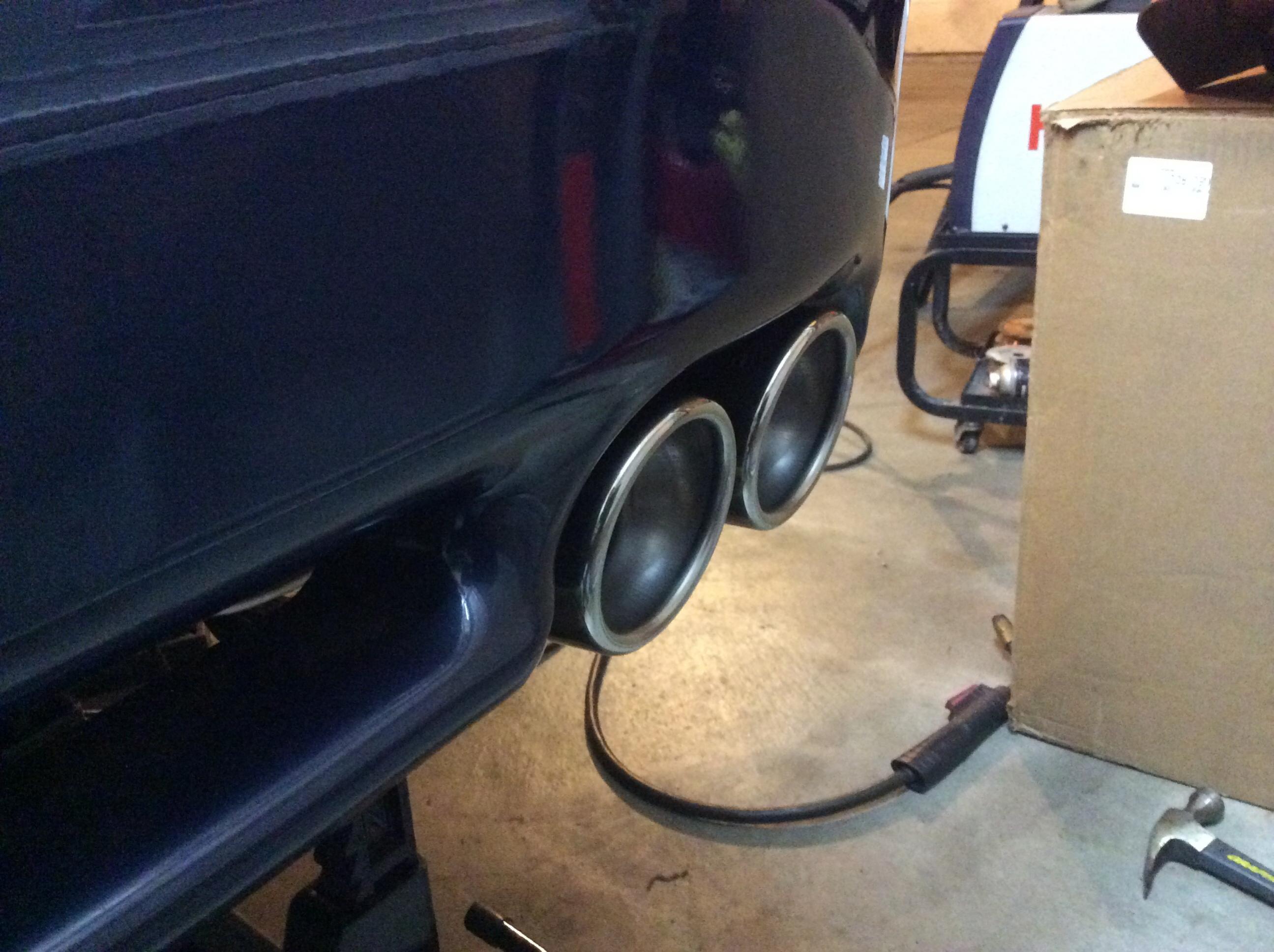

Stockish tips, but in 2.5" ss.
Old 05-16-2014   #66
Re: Comfort comes home-Project Lexus GSX
Damn, I've been waiting to see that setup since I dropped off your ball hone!

I should mention that I put a Magnaflow second muffler in where the cat goes several years ago, it made a difference, but this new Vibrant muffler in addition should really quiet it down. I also just put in the last set of EVO3 lower 5th gear set, so that should get rid of some of the cruising drone as well.
Got the FP Green sitting on the shelf waiting to go in, this is one of the final pieces of more or less duplicating my old EVO set up on the GSX. Big brakes are next.
Just got a bunch of brackets and underhood stuff back from Powder Keg, as well as my RPF-1's. I hope to be driving it this Sunday if it's nice out.

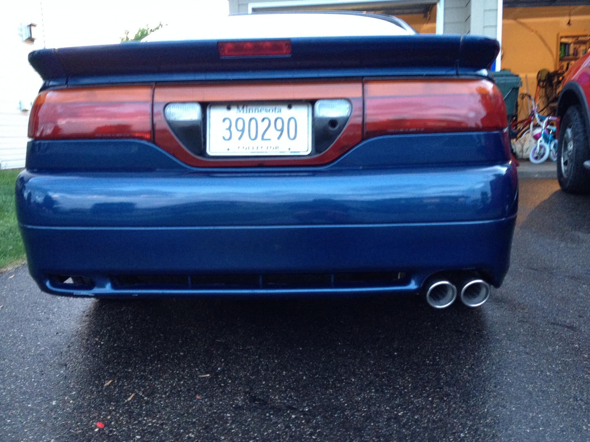

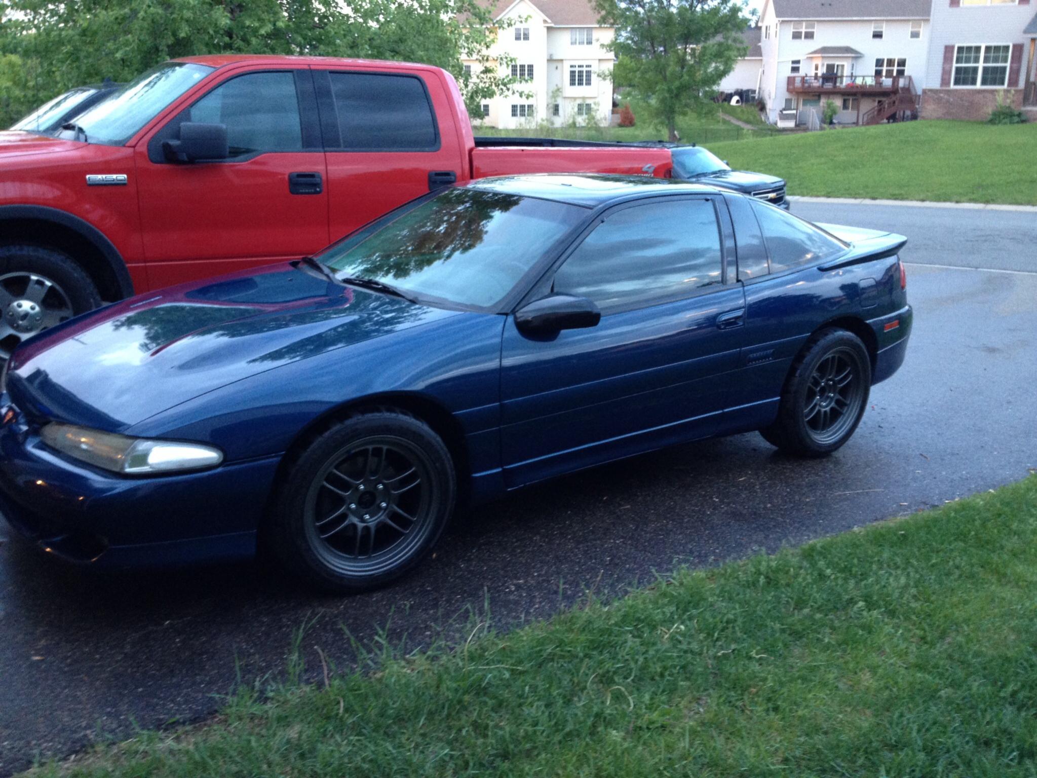

Well, a few updates.
-The new muffler didn't quiet it down as much as I thought, but just enough to realize I have a hole in the downpipe flex section. Time for a new one of those.
-Added the Evo3 5th gear, apparently one of the last available in the country, thanks Tim Zimmer. This might be the best mod I've ever done, 3000 rpm at 75 mph on the way to C&C this morning. No more drone.
-Noticed an annoying hum, time to replace one of the rear wheel bearings.
-Bought a super nice aluminum 4" CAI, but doesn't fit with my short route piping, this will be up for sale shortly. In it's place I was able to use the carbon fiber CAI from my old M3, fits perfect, problem solved.
And finally a few pics with the powder coated wheels and finished exhaust.
Old 06-07-2014   #75
Won't let me attach two pics from my iPad.
Old 06-07-2014   #76
Looks really nice and clean! Glad to see you're enjoying it!
