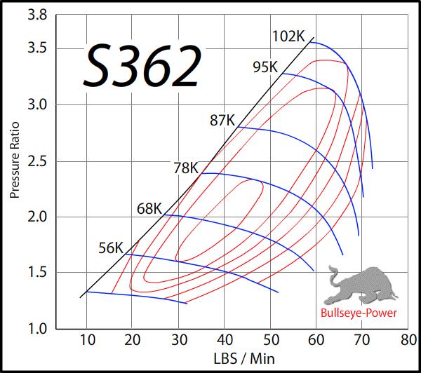

As far as the exhaust side goes, it's the smaller of the 2 exhaust wheel options. Here are all the specs I believe it is. I just wrote them asking for verification of it all.
Compressor Wheel: inducer-62mm / exducer-84.6mm / 54 trim
Exhaust Wheel: inducer-76.1mm / exducer-66.7mm / 77 trim
Exhaust Housing: .70 A/R, T3 inlet, V-Band outlet
Compressor map attached below. Also I'll post up a map of a .70 A/R GT35R for comparisons sake.
Name:	S362 Comp map.JPG

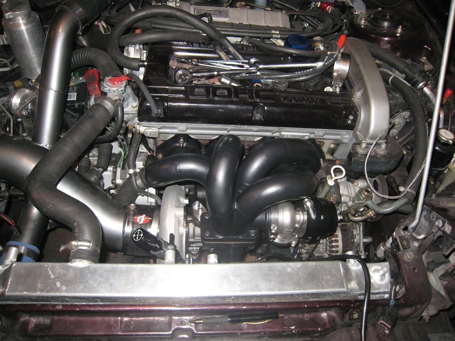

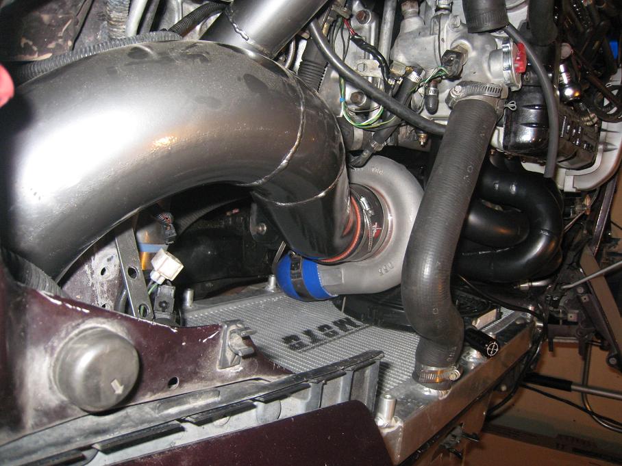

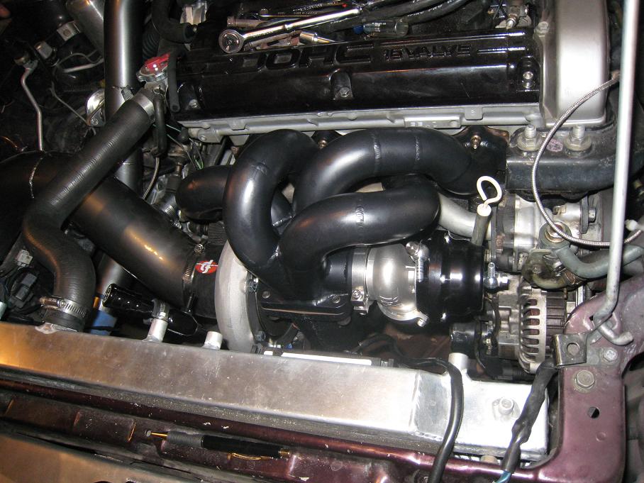

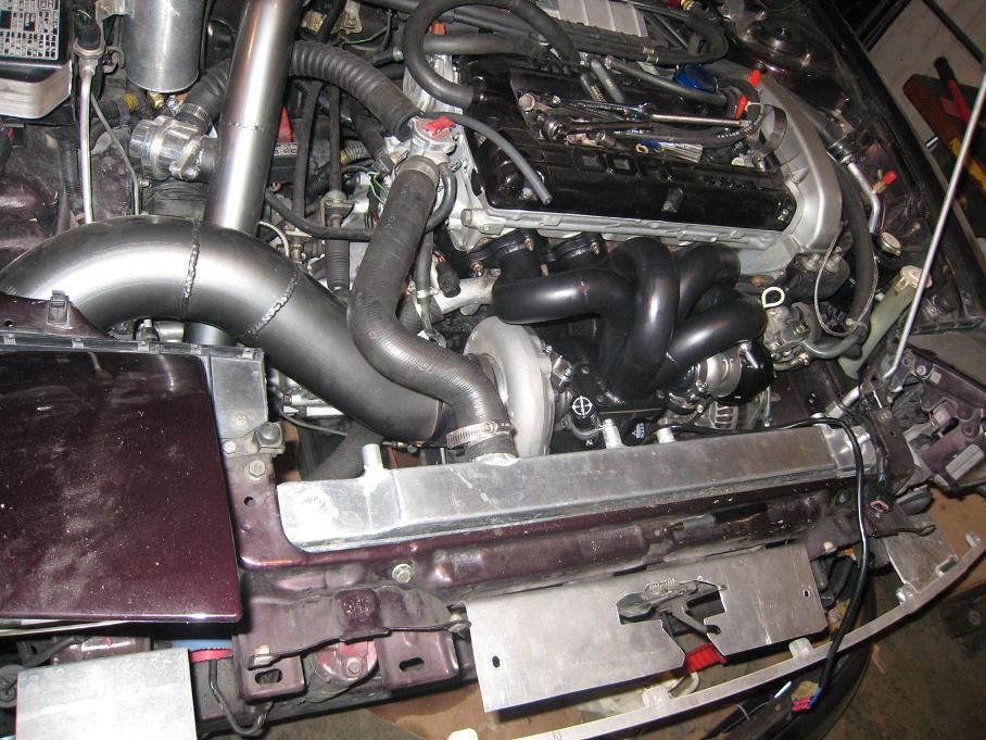

Update with some pics.
ID:	6952   Click image for larger version
ID:	6953   Click image for larger version

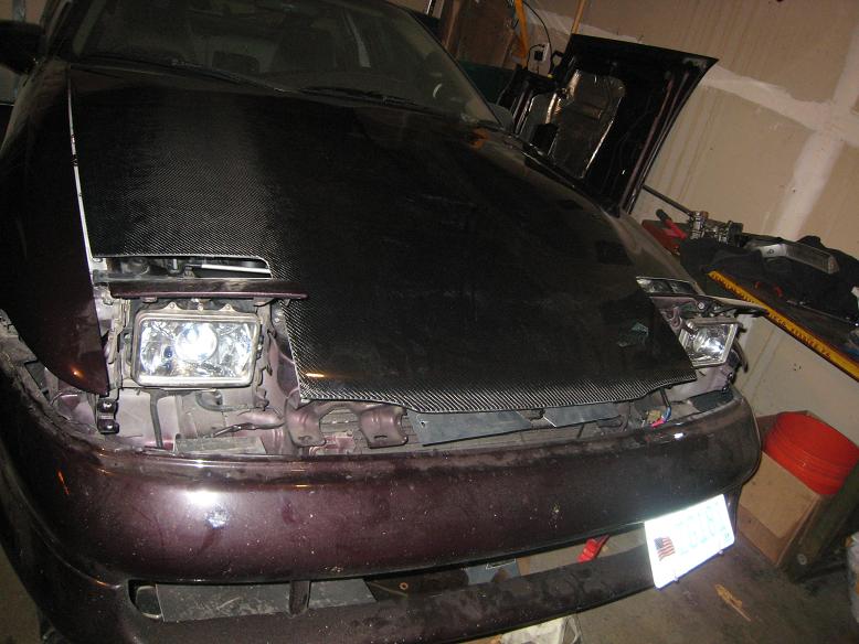

The new hood somewhat on.
ID:	6956   Click image for larger version

Oh snap, JDM fiber. Lookin good dude
Old 02-11-2008   #77
Re: My Winter Upgrades
looks good
you need to get the carbon pop ups also

That and I need some different rad fans since I had to remove one because the turbo gets in the way.
Old 02-11-2008   #79
Shouldn't need too much for fans with that radiator and E85.
Old 02-11-2008   #80
That's what I hear. Except I experienced a much different thing from that, while trying to keep my car from overheating all last year.
