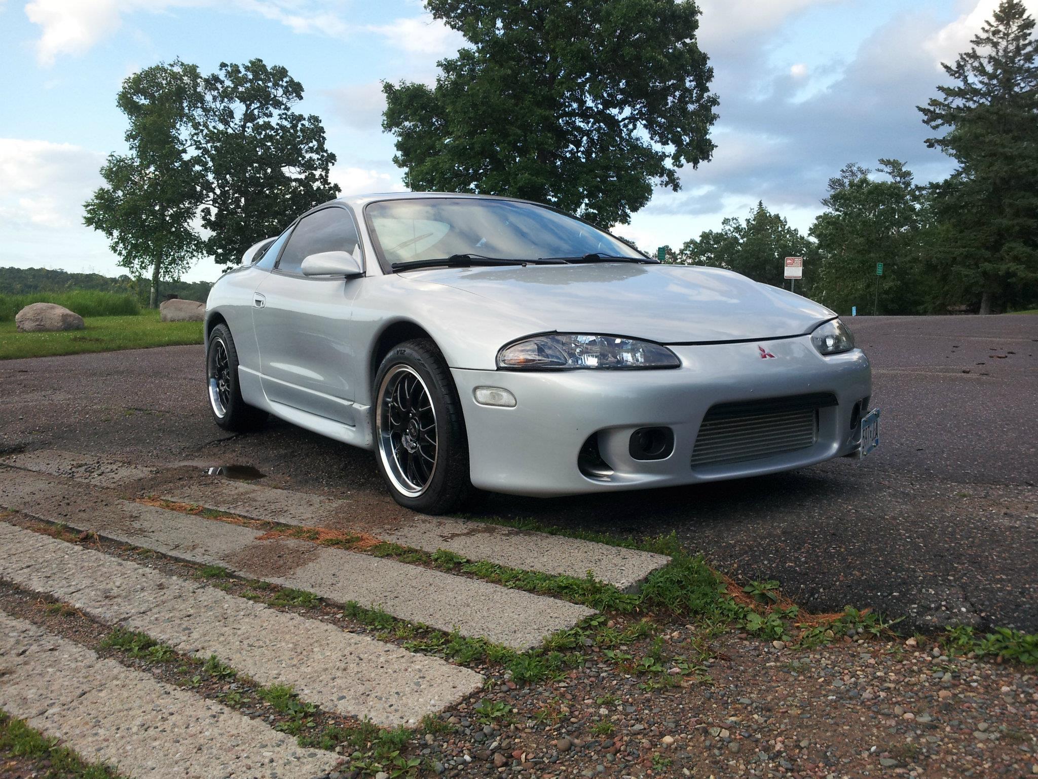

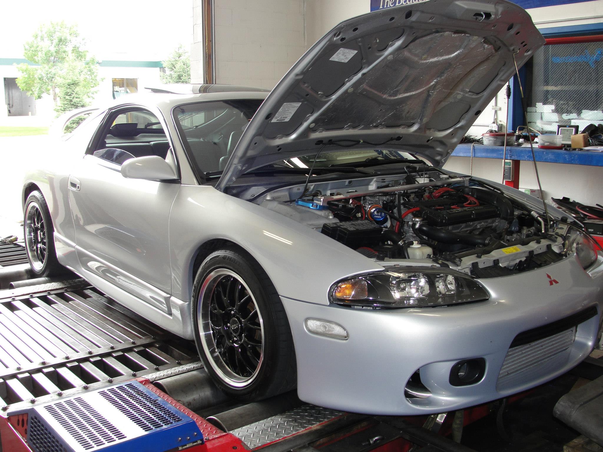

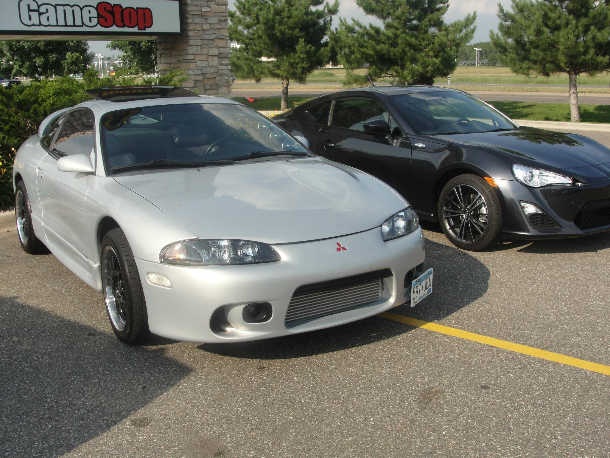

Some pics of my baby

That thing looks mint.
Old 11-23-2012   #69
Re: My New 98 gsx build
OMGZ FRS coupe! :drool:
