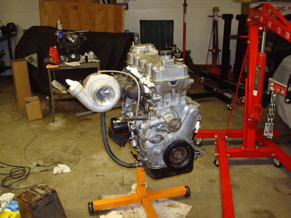

I have been inspired by the great power and even better reliability of dsm's so I am changing my intake system and wiring over to a dsm setup so I can have one injector per cylinder instead of .5 .
So, here it goes, I will start with pictures I took when I first got back from China this summer, and I am still working on it, but now I am beginning to wire it up so it should run sometime soon.
Here after almost 2 months of sitting (hood wasn't open).
Here's how it looked when I left for China:
