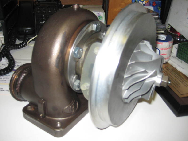

Here's the pic I was looking for. FP housing on a wh1e (hx40). You can see an adapter ring had to be used. That fp housing was bought used. If you buy new, buy the non-GTbb FP30 turbine housing since it has a deeper mounting area. . .
