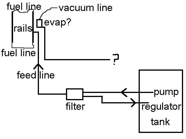

I created a very crude drawing of how I think my fuel system works, it's really weird and I'm not familiar with GM LS motor cars. Anybody on here work with them and can verify this is what's actually happening?
You can see the pump feeds the filter, and there is a return line to the tank and and an output to the rail. What I think this accomplishes is the regulator in the tank can bleed off any post-filtered fuel that the rail doesn't use above 60psi (operating pressure). So at idle the regulator is working hardest, and at full throttle it won't be bleeding off much at all since most will be used by the motor. Is this correct thinking? (Ignore the evap part)
What I thought was weird is that the fuel feed goes into the side of the first rail, and there are two lines connecting the rails, like a big closed loop, not in series as I originally thought.
I took out the rails and injectors tonight thinking maybe something was clogged and found nothing, everything was clean as new. I'm going to see if I can pull out the fuel feed line and check it more thoroughly for kinks and possible clogs.
Edit: just thought of an easier way to verify my pump is working at full capacity (at rest) and the line isn't clogged. I'll hardwire the pump to the battery and see how long it takes to fill a gallon, shouldn't take more than a minute or two if everything is working properly. I believe this would eliminate a flow restriction.

The cross over lines at the front and rear of the rails is to help keep equal pressure in both rails it is usually an upgrade to do and is quite nice to have.
Can't speak to how your system works but that sounds logical from your description. The Evo uses dual voltage to control the amount of return during idle (uses a relay to switch from 10volts at idle to alternator voltage).
I can understand your desire to remove the BAP for simplicity but keep in mind that it isn't *just* a step-up transformer. You can disable the step-up function and it'll still act as a voltage regulator. In theory you should get more stable power delivery to the pump(s) even if you don't up the voltage.

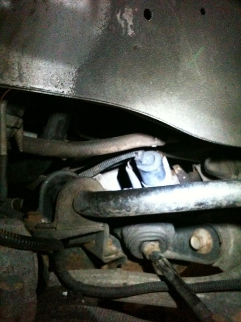

Here is a pic of the fuel feed line that had a hole in it. Whoever installed it tightened the clamp way too much and made the line really weak there.
When I was re-installing the fuel rails and injectors I forgot to grease the orings, so three ripped on me and fuel was spraying everywhere, that was fun to take the rails back off again, not an easy thing with all the supercharger lines running everywhere and blocking access to the bolts.

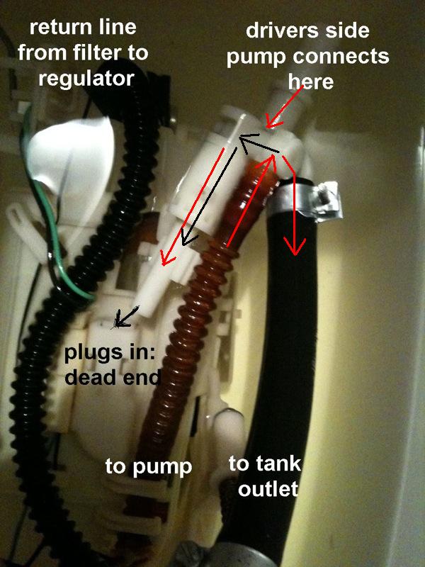

I finally figured out the fuel issue. I disconnected the fuel feed line and turned the pump on for 60 seconds, and I got 1/3 gallon of gas. I tried directly out of the tank and I got the same result, so nothing in the lines/filter is restricting flow. Then I took out the pump and tested the stocker, 255, and 310 pumps I had sitting around, direct hookup to the battery. The stock pump and 310 were each able to do about a gallon in 60 seconds, and the 255 was able to do more than a gallon in 50 seconds, so clearly the 255 pump is more than capable of providing the fuel required.
I put the pump back in the assembly and dropped it into my bucket of fuel to test that out, and I found where all the fuel is going: out some stupid valve I don't think should even exist.
You can see the red line connects to the pump and the mystery white plastic item. That valve thing also connects to the hose that goes outside the tank, the connection from the other pump on the opposite side of the tank (yes, there is an active pump that feeds fuel from the drivers side to the passenger side of the hump), and a plastic tube that plugs into a dead end. I really dont know what it's for. Anyway, about 2/3 of the fuel is spraying out that stupid plastic piece and not going out of the tank.
Anybody familiar enough with returnless or GM fuel systems to know what that thing is? I'm considering bypassing it and hooking the pump directly out of the tank, and having the other pump just feed the bucket the primary pump sits in. I think it's supposed to be some merger valve that combines fuel from the other pump along with the main pump, but I think it may have broken and it's just bleeding off most of the fuel.
EDIT: I added arrows to the flow. I think red arrows should be the expected flow of fuel, but the black arrows are the actual flow. I'm thinking a seal or something inside the siphon has broken.
