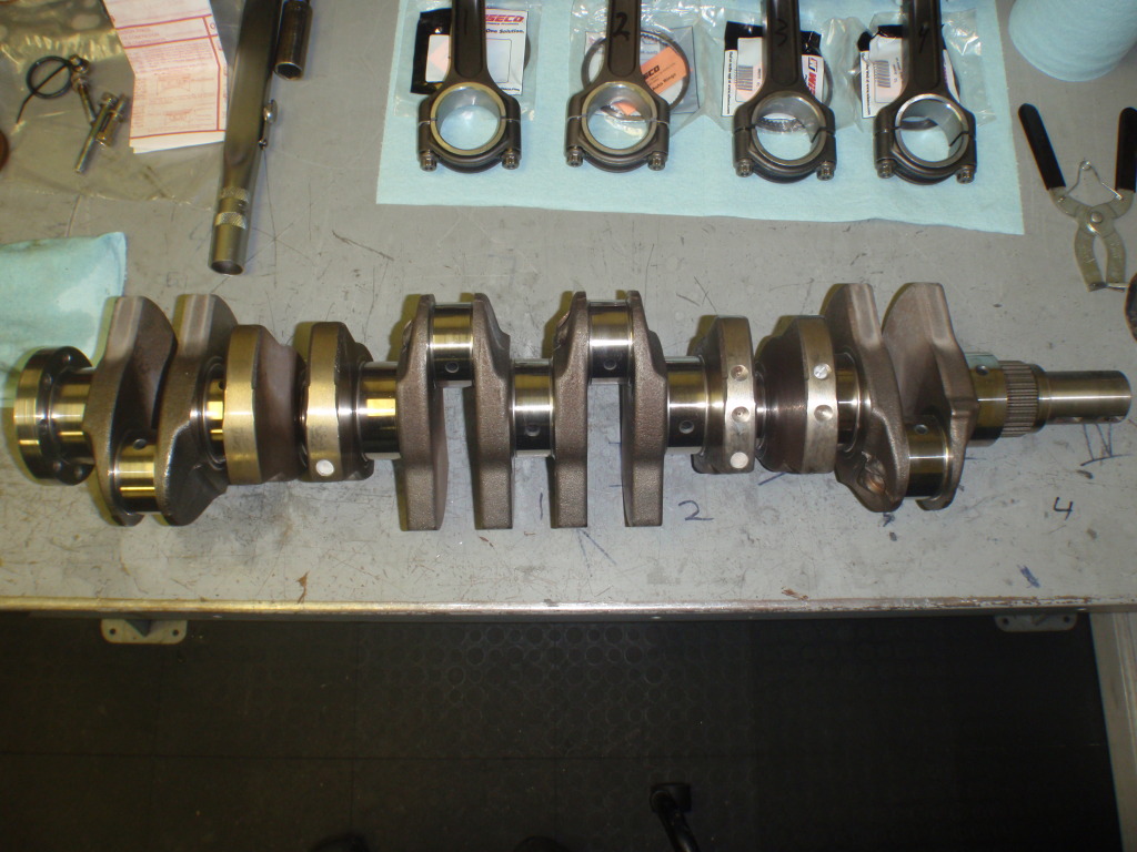

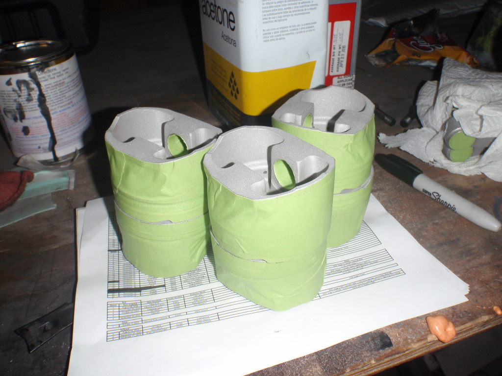

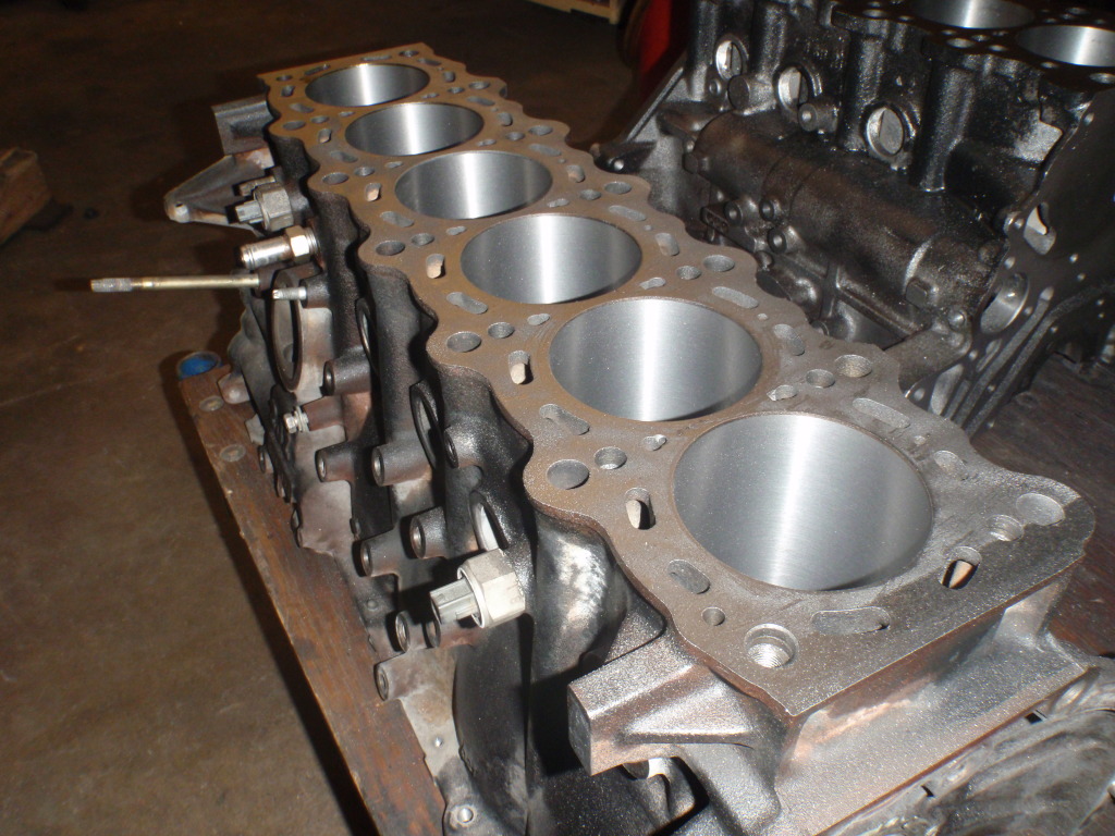

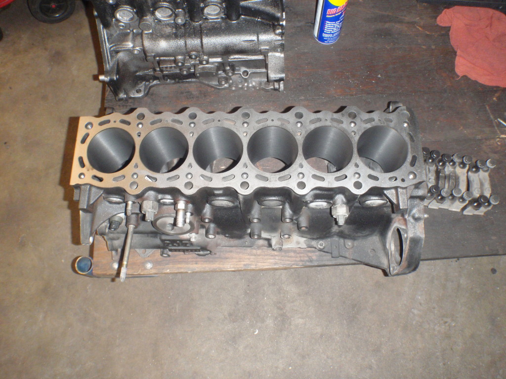

Thought I would snap some pictures this morning. What do I see a 2jz.
Block bored and surfaced ready to be honed. Pistons ready for coating. Freshly polish/balanced crank.
