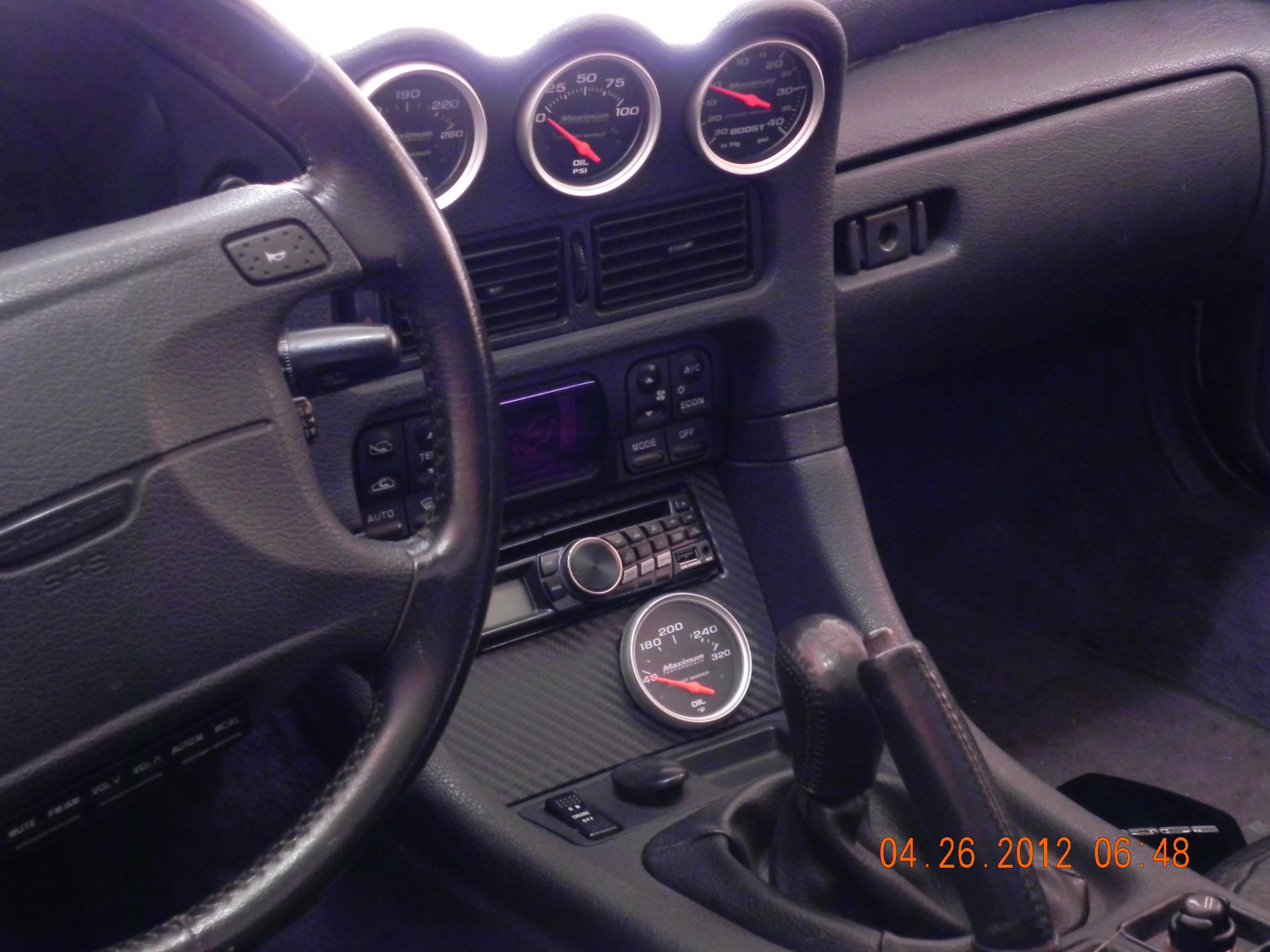

Car lives. I had one 02 sensor show up DOA, so overall not to shabby. Now to drive it and tune it off the front bank. I won't switch over to E-85 until my failsafe pump gas map is done (work in progress), and my rear 02 sensor is back in house.
Car is LOUD without mufflers. I will have to bump up priority on that cat-back. Another strange oddity: I cannot mount my front plate. I have now received 2 front plate brackets, neither fit.

Very nice, i like that CF piece.

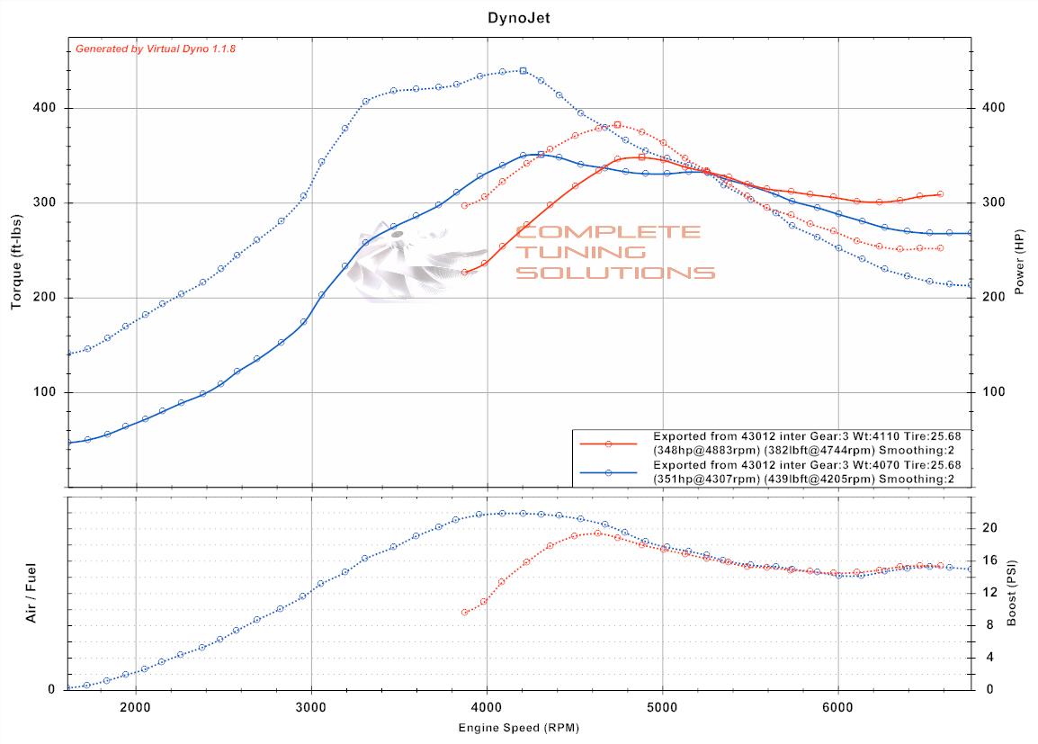

Then proceeded to setup a 92 octane fail safe map. I used the full tank of gas in there from October, and the tank was open for a month or two....so in reality it is probably an 85 octane tune, but it will get me by if I need gas to get to the next E85 fill up location.
Then proceeded to tune on E-85 and hit a minor hiccup. The stock clutch is NOT happy any longer, so a replacement is on the way as well.
E-85 results below with a slipping clutch. I know its slipping as it takes more and more RPM to get the same road speed, and the AFR was changing. Hard to know the exact amount of slip, but I will find out.
Don't worry about the peak numbers but the curves are nice!
21psi spike, 16psi hold.

Graphed the rpm versus mph...yeah it is slipping under projected peak torque (3500) and just continues to slip more and more as rpm increases. Makes sense as the factory clutch is rated to 300whp and I would anticipate this car to be right around there.

Quick update, Had an extra flywheel here, dowel pin snapped off in it . So I ordered a stock style replacement as I would imagine the flywheel in the car has more hot spots than the surface of the sun.
Clutch is slipping still but added some timing up top, car now holds 300+hp per virtual dyno to redline Can't wait to get the 6 puck in and rent some dyno time at MAP after I break in the clutch.
Also ordered a new throw out bearing as the one that was available cannot be found. Goal is to get the clutch in Friday night/Saturday and then start breaking it in. Finish up street tuning and rent an hour of dyno time sometime before proving grounds. Hope to have the tires on by then as well (should) and we'll see how deep into the 14's I can get
Blue graph is more timing compared to image in post #92, red graph is more timing yet. Problem is with additional timing comes more and more RPM needed to achieve the same MPH so I need to stop and wait for the clutch Good amount of slip noted before 4k and after 5500rpm, power curves and AFR move to back that up . The red pull was just a quick check and I hit it pretty late, thus the lazy boost response, just wanted to check the cells "up top". Like I said, nearly time to break in the new clutch after install and see what it does on the real dyno!
