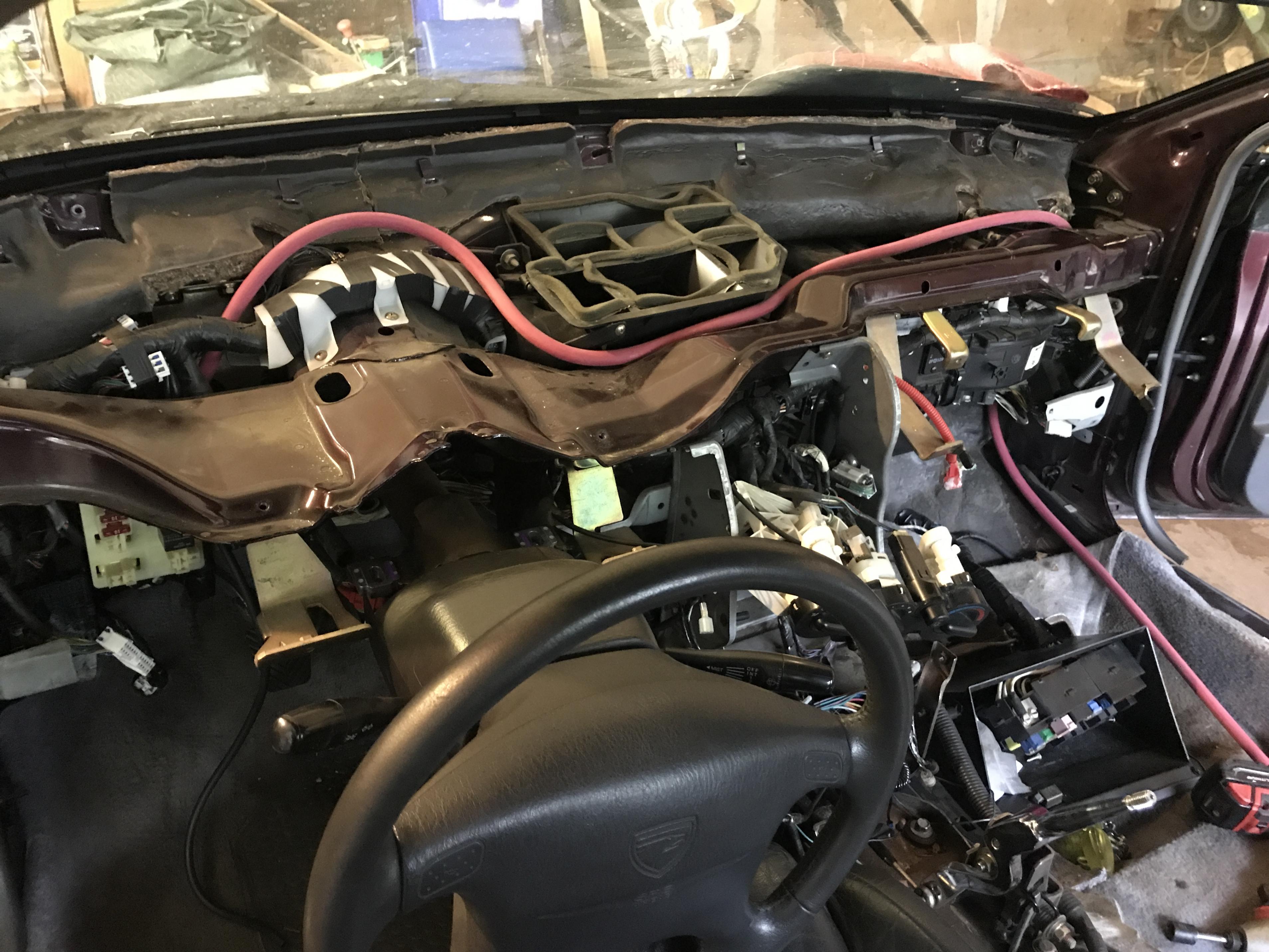

Little update.. Took everything to work and got every last bit of the fire extinguisher powder off. It made a mess and was in every hole/ crevasse. I also decided to get a Kiggly main girdle this go around with a new (reman) 150amp alternator. Just waiting to hear back from the machine shop so I can order my pistons and injectors.

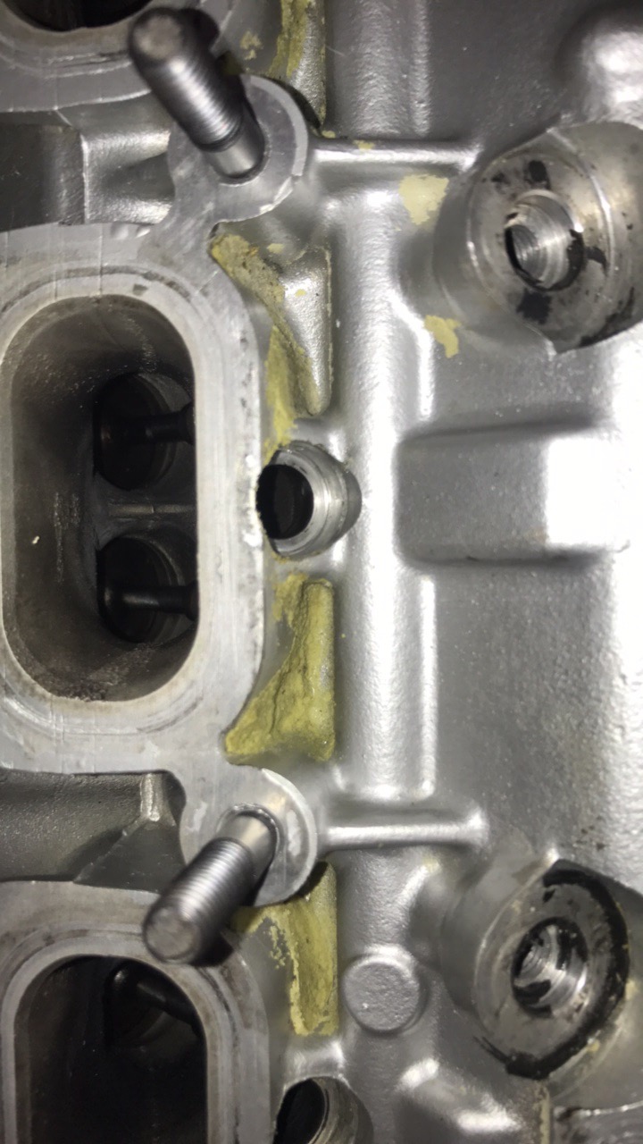

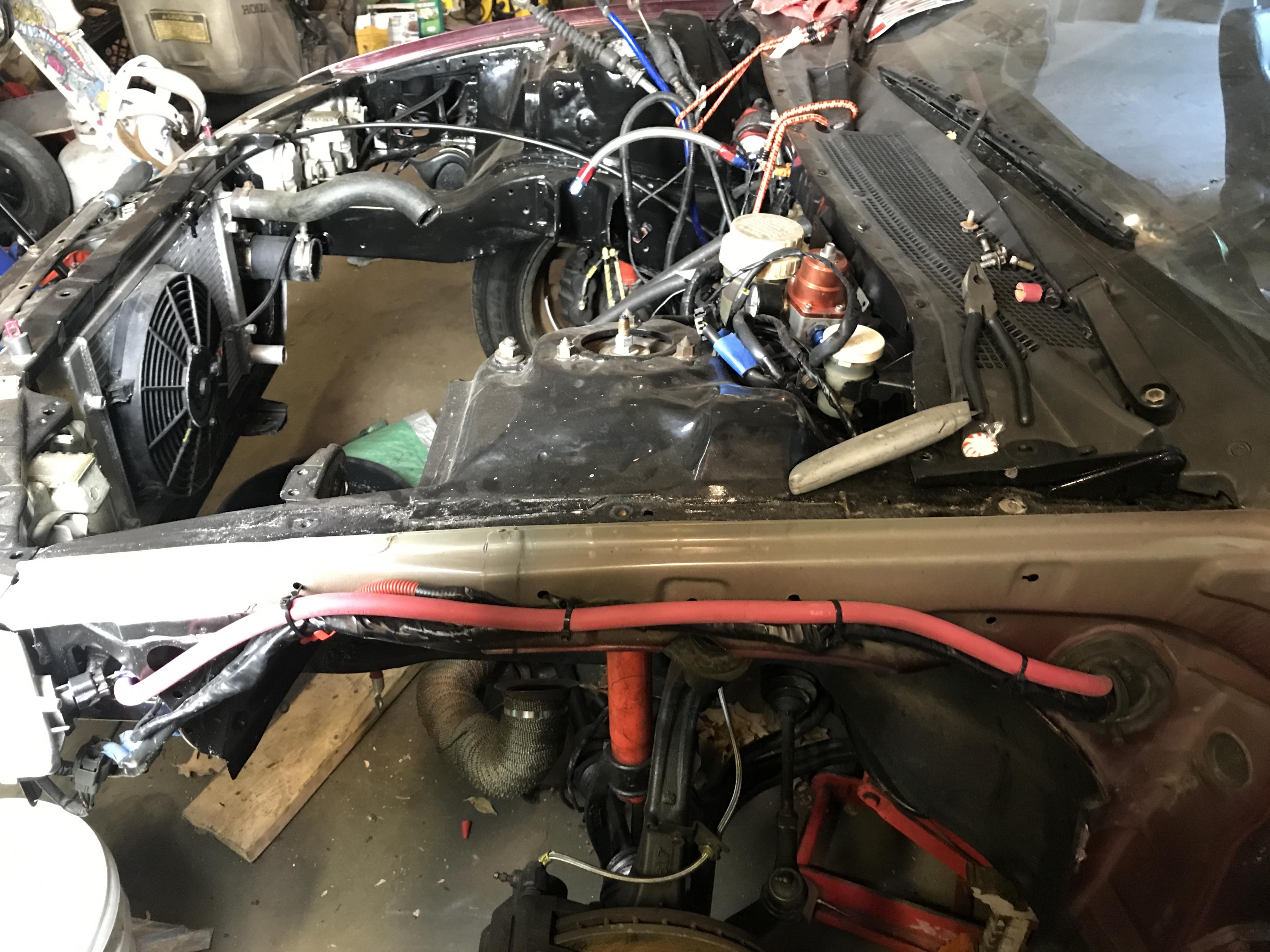

Block is still at the machine shop. Got my alternator wired up with some 2gauge awg and a 150amp breaker. Next is the inline fuel pump with a Hobbs switch.

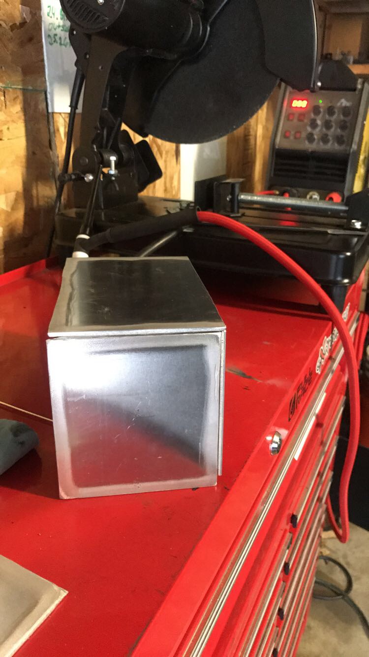

Almost assembly time! Machine shop is honing the block then I can order pistons. Until then I have started to build a new coolant reservoir and catch can.

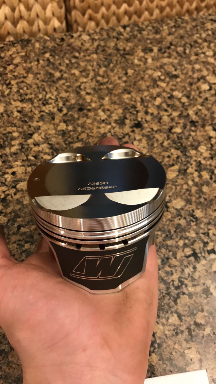

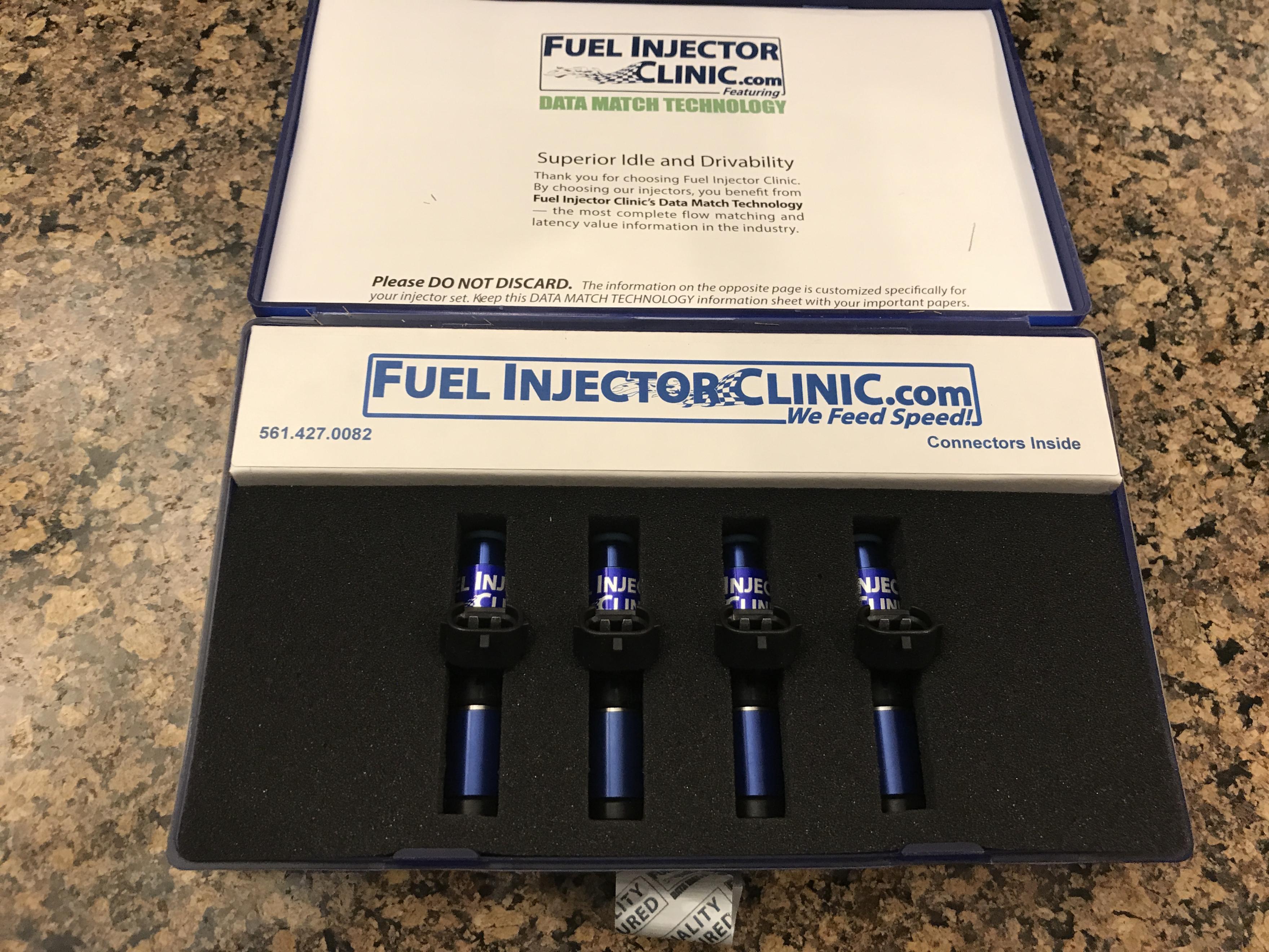

Injectors and pistons showed up today! Went with the 2g wiseco hd's with the e85 coating and a set of FIC 2150's. I believe I now have everything to get it back on the road!!

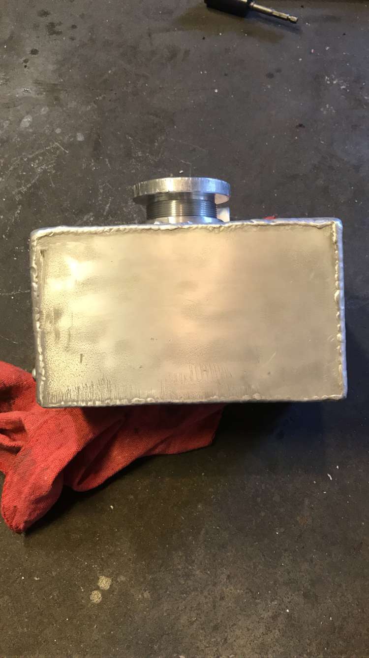

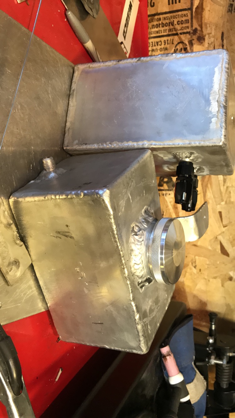

Coolant reservoir done. Still debating on if I want to dump the catch can to atmosphere or if I want to add a Venturi tube/ hose to the exhaust to help with suction.

Old 06-19-2017   #95
Re: Mark's Talon
If that's the route you want to go, Vibrant makes a kit.
Otherwise, I'd go to the intake/turbo inlet if it's a baffled or filtered catch can.
Old 06-19-2017   #96
mark4g63t
mark4g63t's Avatar
Join Date: Jun 2012
Location: Twin Cities
Drives: 95 Talon TSI
Posts: 941
Re: Mark's Talon
Catch can is baffled.. I know a few people who have gotten the vibrant one and I have made the conclusion that they don't put it at a big enough angle so it doesn't create much of a vacuum effect. I don't have an intake yet and not sure if I will have one made by this fall, that and I'm not to fond of going back to the intake pre-turbo. Even the thought of going to the exhaust scares me a little bit with fuel vapors.
BW8776, e-85
Old 06-20-2017   #97
Re: Mark's Talon
With a properly baffled catch can you shouldn't have any issues at all going before the turbo. I'd much rather pull a vacuum on the can than just venting. There's a reason why lots of the big V8 drag racers run crank driven vacuum pumps to their valve covers.
Old 06-22-2017   #98
mark4g63t
mark4g63t's Avatar
Join Date: Jun 2012
Posts: 941
Re: Mark's Talon
Not sure how well the baffles will work. I am going to be upgrading to -10an fittings on the next can I make with -10's on the front of the valve cover. By then I should have an intake setup made and will probably run it to that.

Machine shop called back and unfortunately had more bad news.
My brand new MAP Howard rods don't fit into the Wiseco pistons because the pin bosses are too wide. How does this happen?!? Anyways I will be contacting MAP before anyone else gets screwed.
The fix is to machine the rods down to fit into the pistons.
Block should be done next week if everything else goes as planned.
