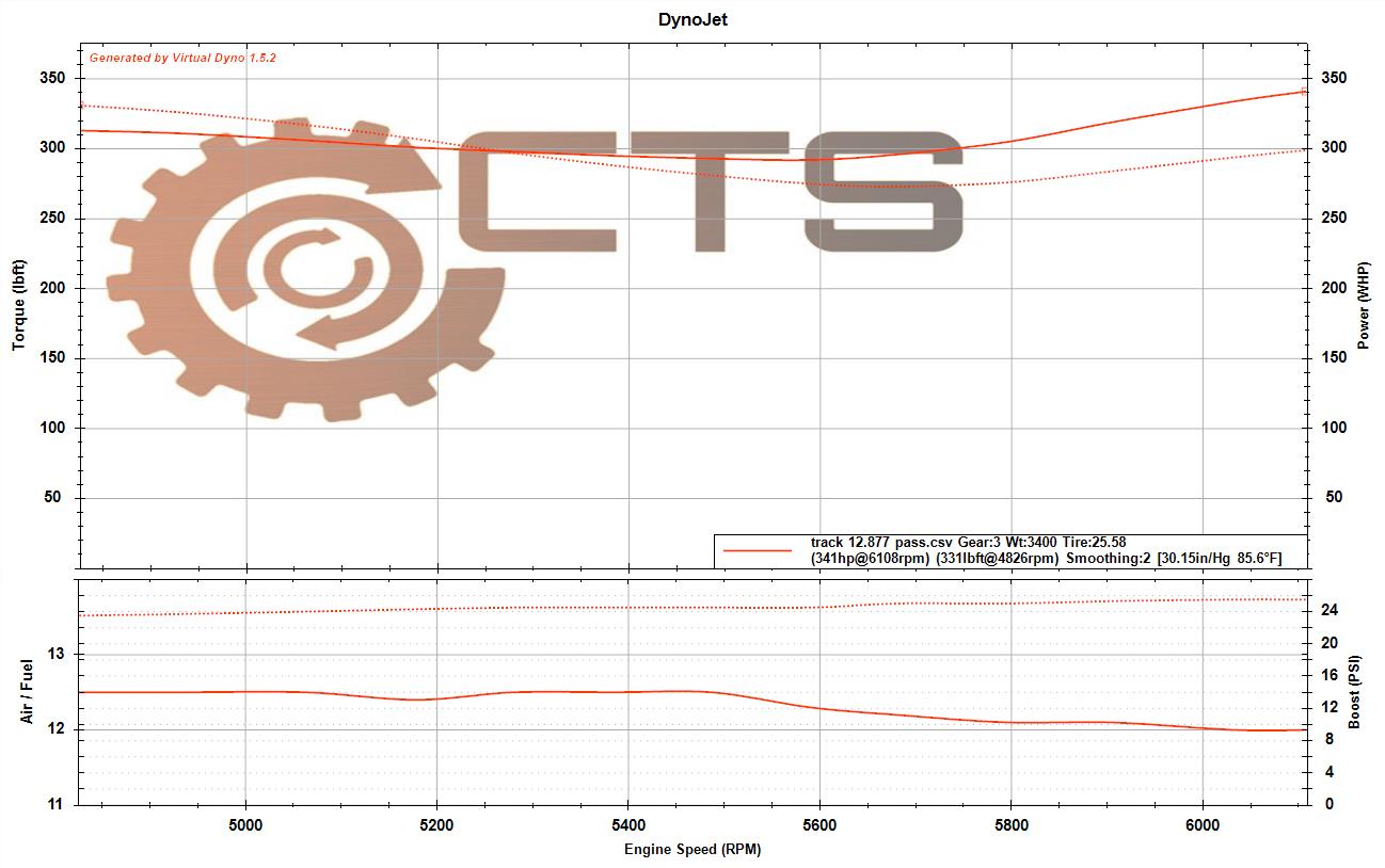

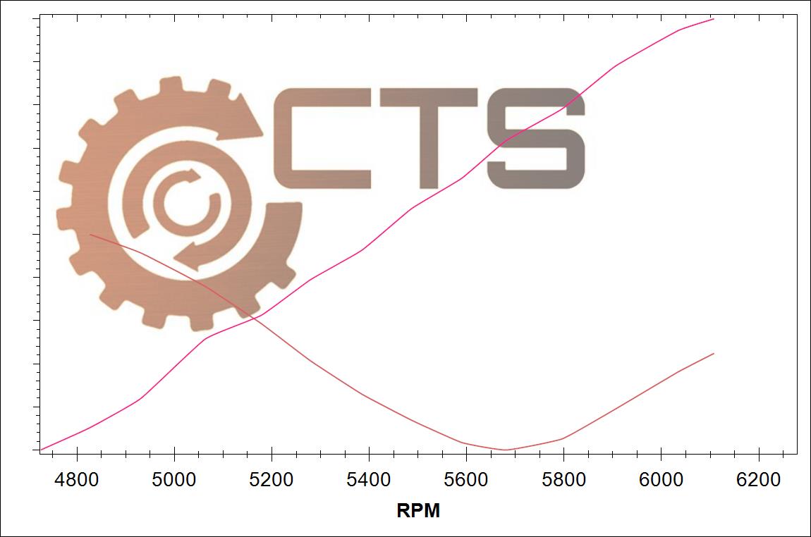

Reviewed logs. After looking at the torque curve versus the mph plot over engine speed, I am very confident the clutch was slipping the entire time. Boost is timing advance in power graph. The line that drops down like a spoon is an exaggerated torque curve. The other is mph versus RPM, it should be linear, not jagged like it is.
I can't wait to see how much power it makes with the clutch in it, haha. I wouldn't be surprised if it makes 350/350.
Video.

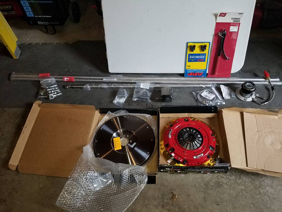

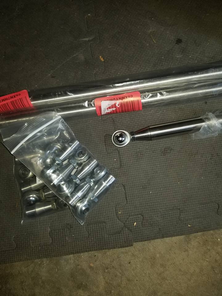

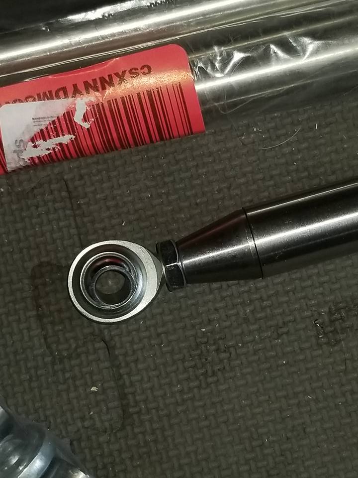

Well my Sunday and next week are going to be busy.
Clutch and goodies are here. A "while I'm at it" bug bit me hard on this one, so I'll be designing and fabricating (with the help of a good friend) a "anti-wheel hop" differential brace using SS rods and heim rod ends as well as tying together the transmission and differential. That way when I put the entire assembly back up I won't have to touch it again until I build a differential and am really running sticky tires.
Progress and photos to come this weekend as I tear out the entire drivetrain.
