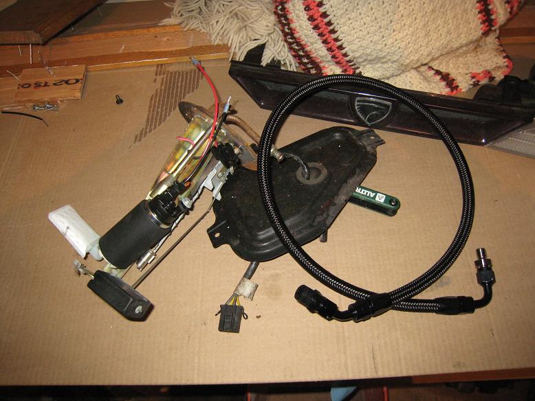

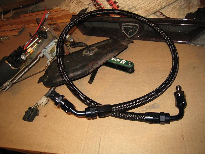

Well I got home today, put together the fuel feed line. Now I have never assembled a SS braided line before, but I've heard the horror stories about how much of a PITA they can be. This nylon braided stuff was cake. I had both ends on within 5 minutes while sitting on my couch with no tools. I'm really glad I ordered that!
Old 04-01-2008   #17
Re: My Winter Upgrades

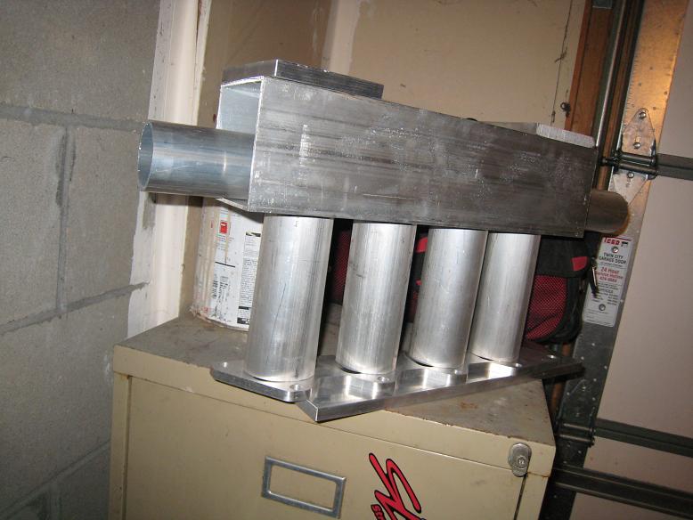

Just some quick shots. 2nd Walbro 255hp came in today. Also a pic of the fuel feed line. It's a bit long, I'll probably cut it in half about, but I was just playing with putting the ends on, and it was cake. Also some shots of the smim slowly coming together.
