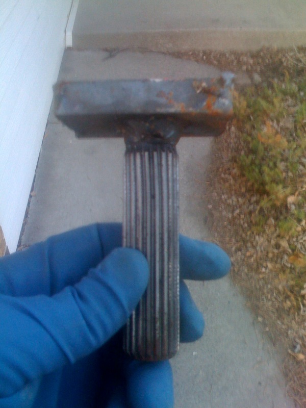

Re: Carl's 98 auto AWD project Black Magic
Welded center diff in my 1st GVR4 500AWHPish + a good hook did this:
I snapped my transfercase output shaft in the yoke.
We had to weld that chunk of scrap to it and hammer it out.
look at how it twisted the splines...I cant be the only one right?
I felt kinda proud and defeated at the same time because it was the rare JDMyo switchable one. I have fields of regular transfer cases.
Great build! keep it up!

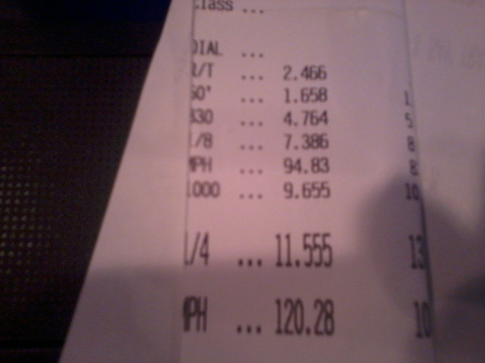

Old 10-21-2012   #113
carltalon
carltalon's Avatar
Location: Big Lake MN
Drives: 98 Eclipse GSX Auto
Posts: 1,516
I took the car to Rockfalls Yesterday and it went 11.555 @120 mph. I will keep driveing it till the snow falls and then park it.
My plans for winter will be to cut out the rusty core suport and make a tubular one. And get a real intercooler. Ive been getting knock in 3rd durring long pulls so I think my ebay one isnt cutting it. I'll be on the lookout for a precision/garrett or ETS.

Old 10-21-2012   #114
I'm loving that 120mph trap speed.
The car will do a 1.5x 60ft, so there is a little bit of room left.
Oh, was the baby seat in for this run?
IOh, was the baby seat in for this run?
The car seat isnt heavy enuf to makle it worth removing. I should have pulled the back and passanger seat then it might have ran 11.49

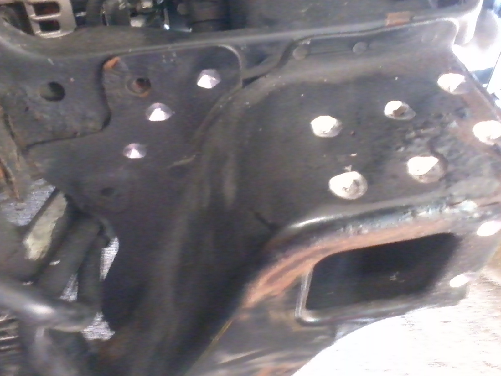

I officialy Parked The car the day after Thanksgiving since the roads were salted.

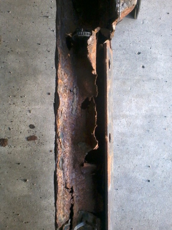

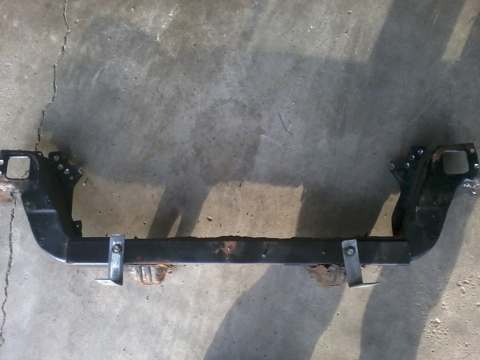

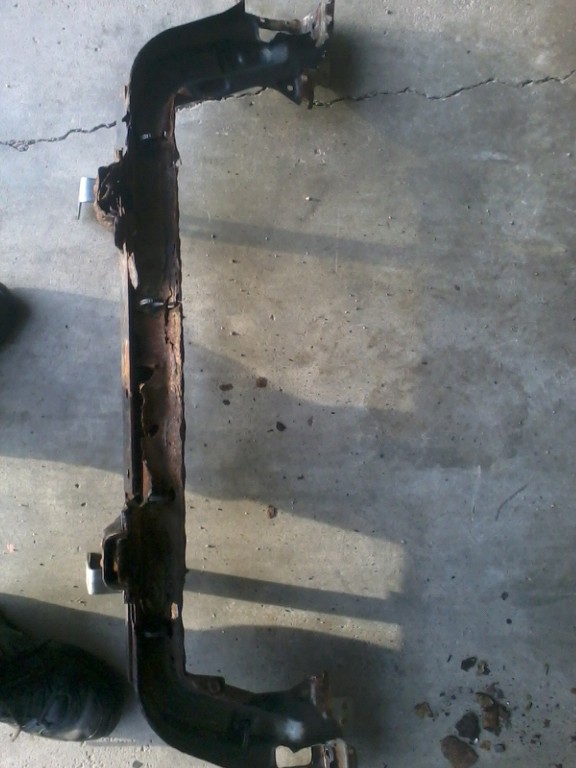

Today I had a few hours to do work on the car so I removed the rusty lower core support. So I can replace it with a tubular one. I removed the bumper cover, FMIC radiator, and head lights. Then I drilled out about 20 spot welds that hold the lower support on. after some pounding with my BFH and a chisle it came right off.

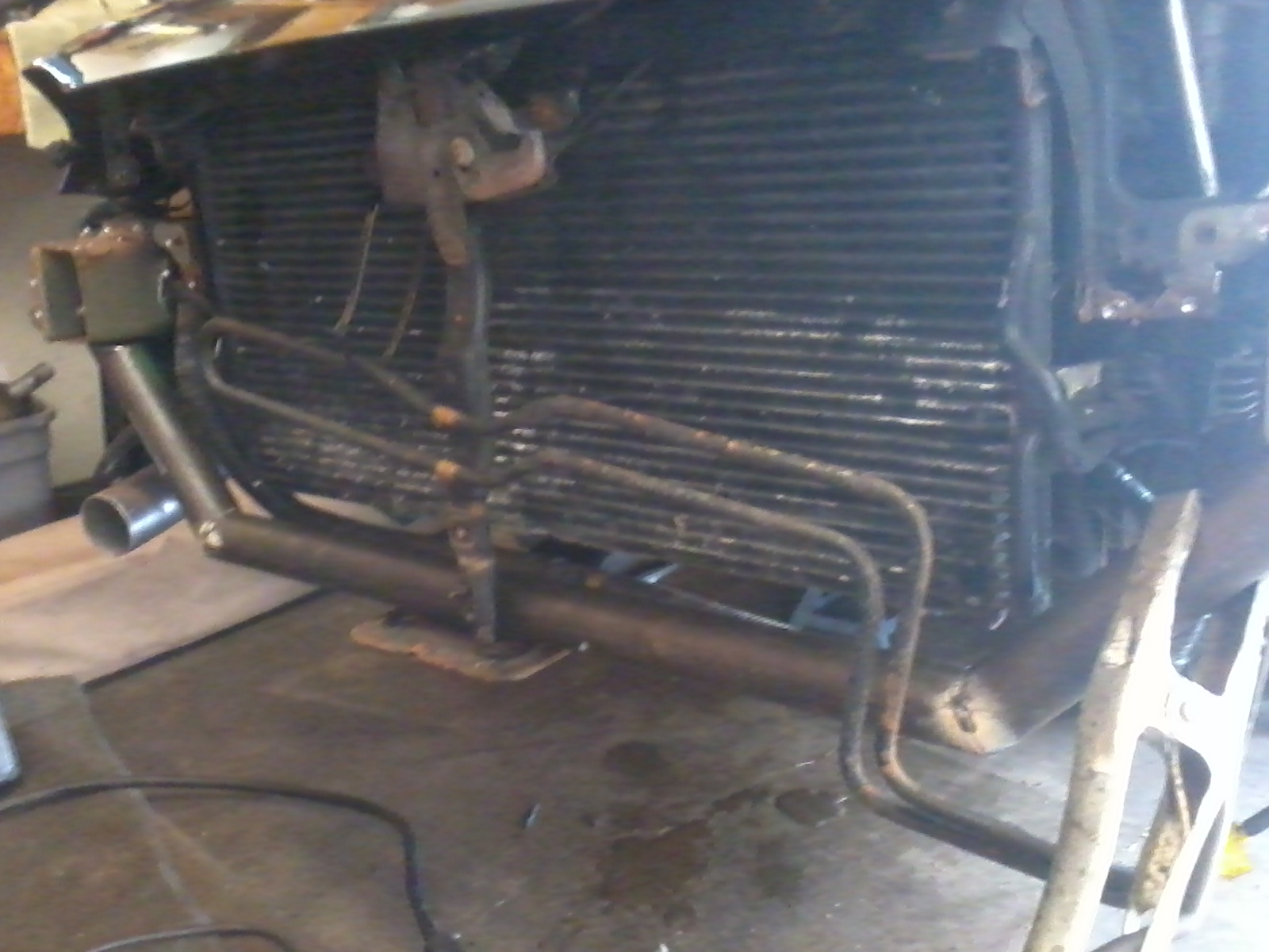

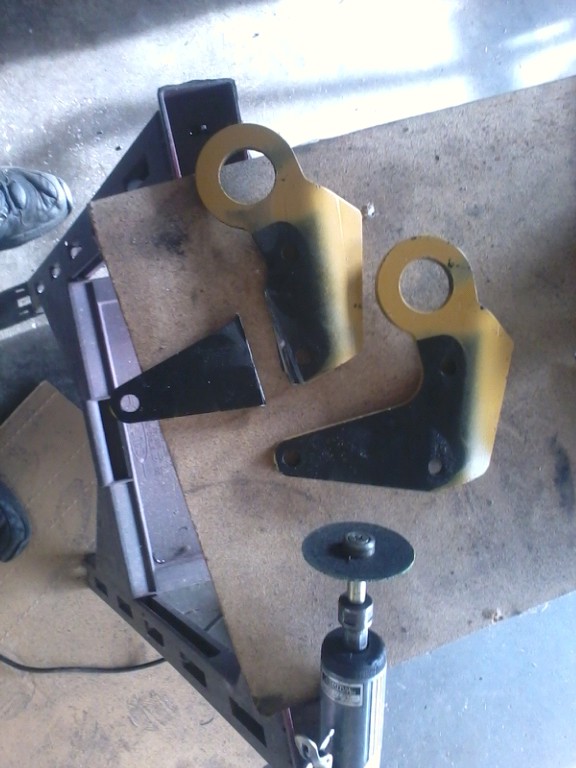

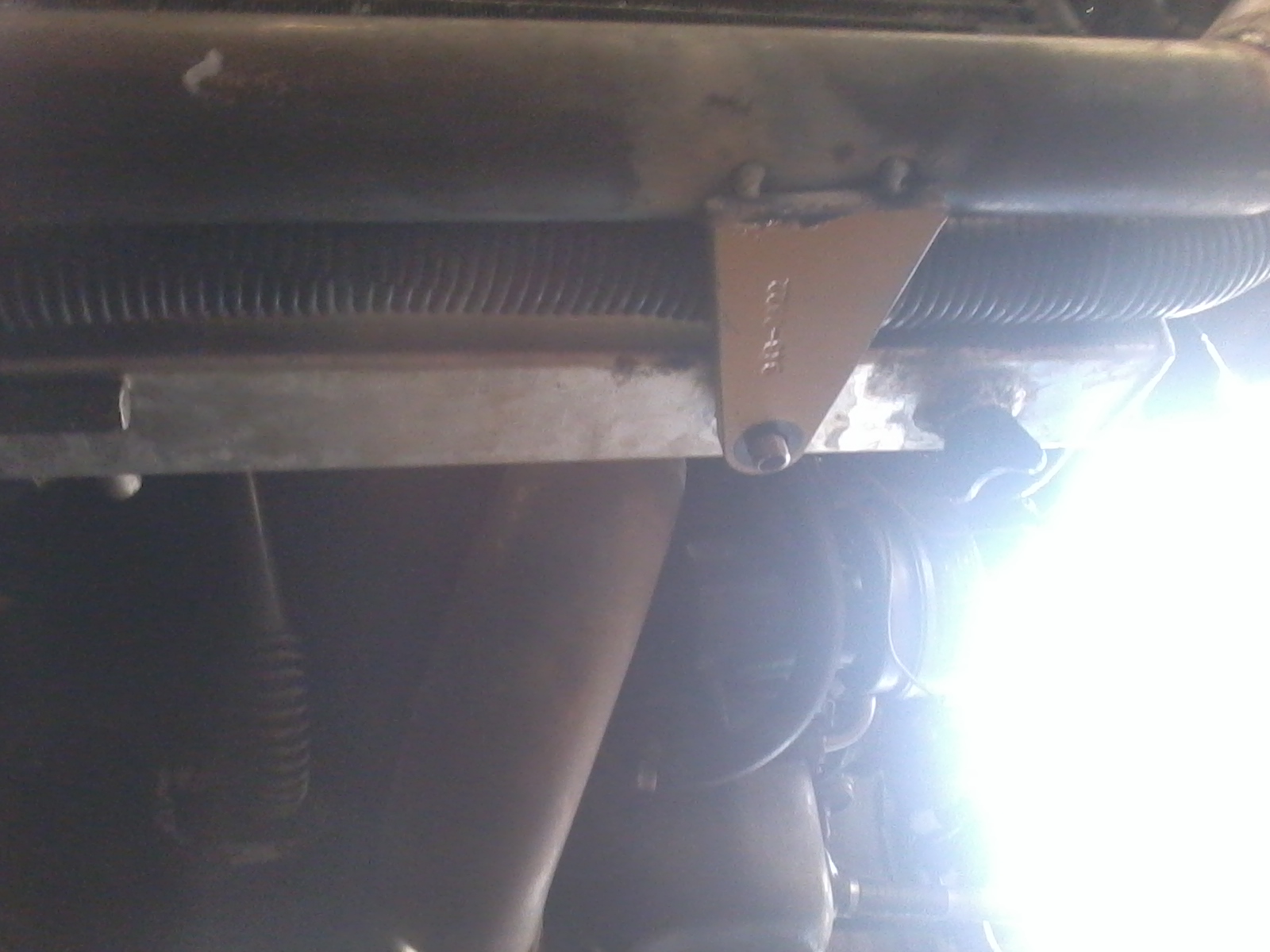

Old 11-29-2012   #119
carltalon
carltalon's Avatar
Posts: 1,516

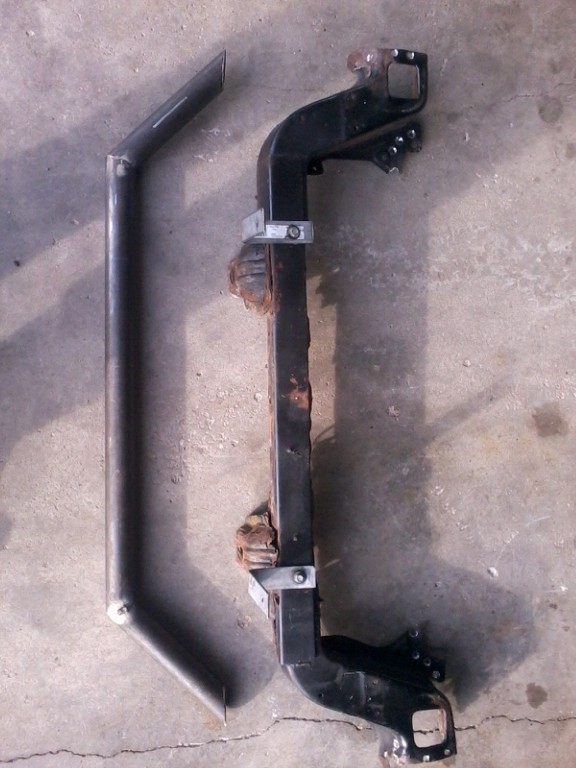

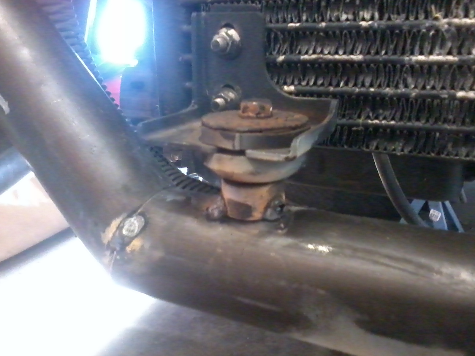

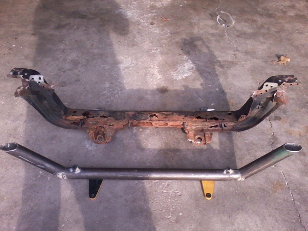

I tacked up the tubular core suport today. I made the lower radiator mounts from some lifting hooks we take off of engines at work and made some mounts for the a/c condensor. I am going to bring it to my Dads to weld it up with his MIG and drill the holes that will mount the North/South crossmember that runs under the motor/trans. Im not sure what I am going to do for FMIC mounts since I plan on upgradeing my Intercooler before spring.

Old 11-29-2012   #120
Picture 6 explains to me why you tackled this project!
